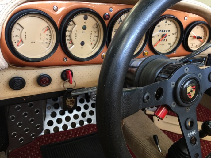

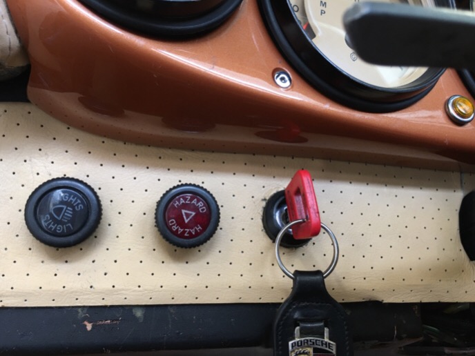

Completed the left/side ignition installation and did a test drive

QUOTE(jim_hoyland @ Mar 18 2017, 03:26 PM) *
Beautiful sir Jim!
Steve
post Mar 18 2017, 05:23 PM
Post #8585
Posts: 6,038
Joined: 14-June 03
From: Laguna Niguel, CA
Member No.: 822
Nice!! Are you going to remove the ignition switch on the column?

QUOTE(Steve @ Mar 18 2017, 04:23 PM) *
In time, yes; i' m keeping it as a backup for now. I think I showed you the custom clam shell Jeff Hines made.
The good news is the car started up !
BTW: After I enlarged the fog light switch hole I test fitted that 911 ignition assembly. It will work without cutting the arm. The steering wheel lock would not work without doing the complete change over

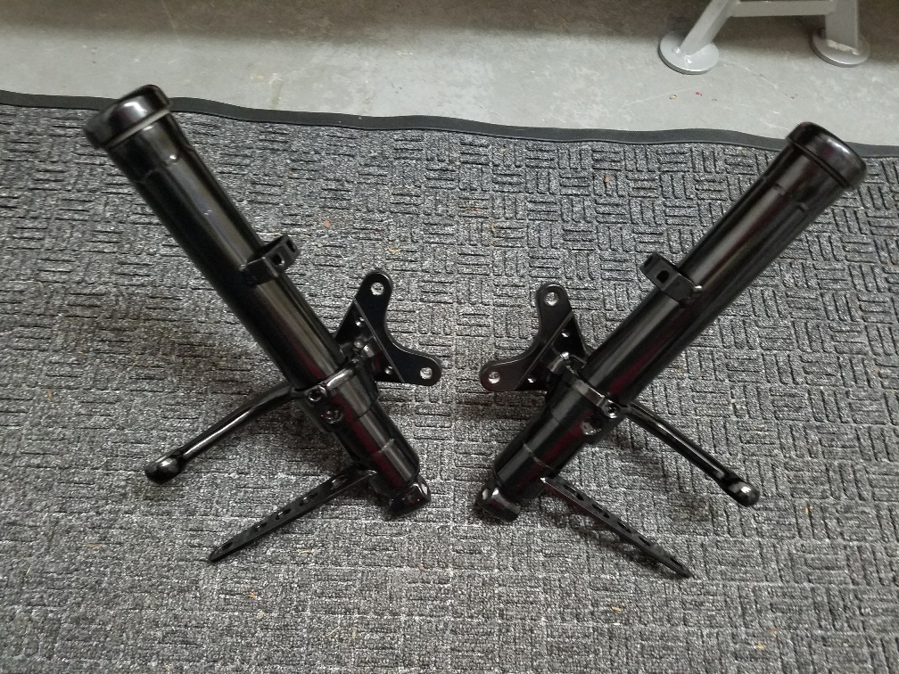

Just powder coated the shortened front struts (thanks Foley!) and will be building the front end this week. Road Atlanta NEXT weekend - locals come hang out!

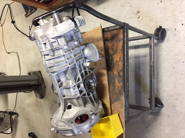

Cleaned the tranny and resealed the output flanges and shifter seal. Then reinstalled the Rich Johnson bellcrank and new pulley...
I am going to clearcoat it with wheel paint clear / about as good as one can do on a Mag case.... I also ran garden hose from the front cooler to the Mocal thermostat at the firewall to confirm the two lengths of AN 12 SS braided hose.
One was 139" and one was 141" due to the relationship to the fittings at each end.
Sidebar: Even as small files, the pix rotate!! (IMG:style_emoticons/default/WTF.gif)

I applied the satin clear in two coats / will make subsequent cleaning easier maybe...
I also discovered that one of the 911 engine case studs was too short to allow a nut and washer to be torqued thereon / something to measure for prior to mating the tranny to the engine.... (IMG:style_emoticons/default/hissyfit.gif)
