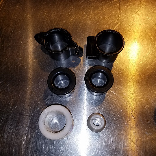

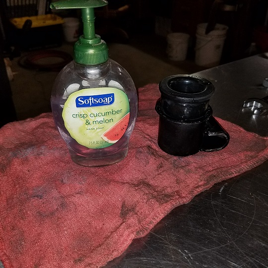

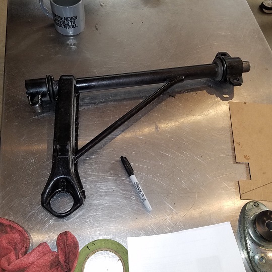

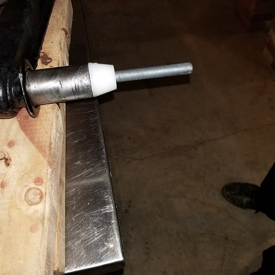

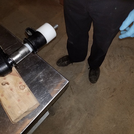

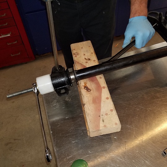

Started the day with installing the new 914 Rubber front control arm bushing kit with the new install tools. Super In Law and I shot about 50 pictures to be used for the install instructions. Here's a glimpse.
You'll need to purchase some all-thread, washers, nuts and liquid hand soap. I would probably use a double washer set on the nut that I'm driving in the push guide tool.
This is done with only hand tools. The 20 ton press 10 feet away went unused. LOL.
Tampered guide tool.
Push tool.
3/4" ratchet wrench
Jack and I were almost laughing on how easy it was ............ (IMG:style_emoticons/default/beer.gif)

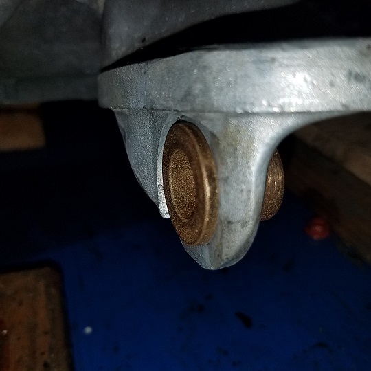

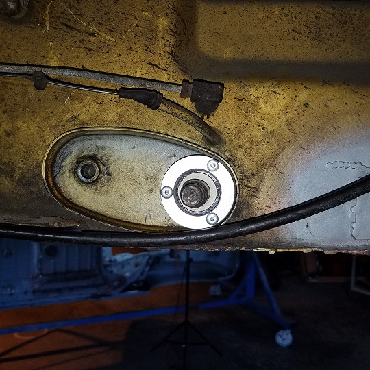

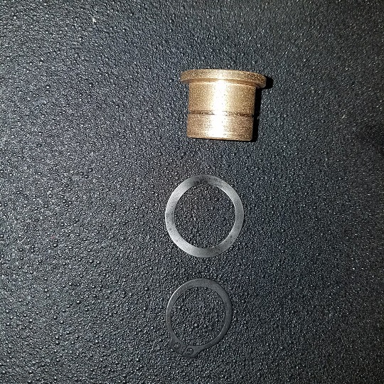

Then on to Mike's (Warpigs) side shift conversion.
1st piece was the GPR oilite shift console bushing. Brian's piece takes no modification to either the rod or console.
Then on to installing Tangerine Racing's fire wall bushing.

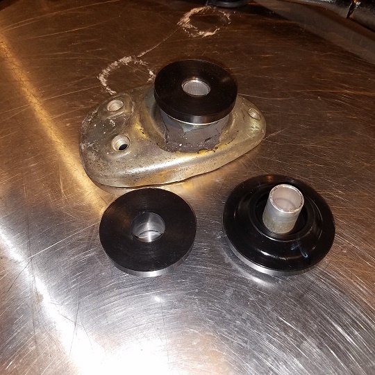

Mark did drop off one of his new front strut top bushing kit.

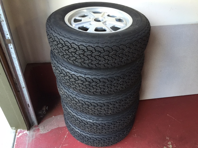

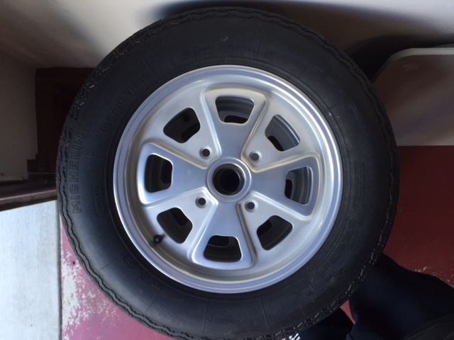

Thanks. They are old tires that came with the rims. IIRC 185/15/70
Added pics of the new tires.

Looks great. What size tires are you running on the 2.0Fuchs?

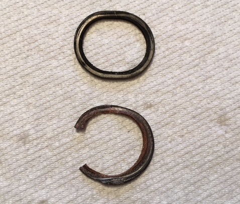

Finally got a chance to fix an exhaust leak. Somewhat small leak turns into a large, loud, and smelly leak when this happens:
The offending gasket was on #3. I've suspected a small leak for a while, but it became obvious about 10 days ago. Working on the VW exhaust system is a real "joy" (IMG:style_emoticons/default/blink.gif) . Having a lift to do this now helps a lot, but it's still an "interesting" design. Using a shop vac up the tailpipe in blower mode is a great way to both find which cylinder(s) is the problem as well as a good way to test to seal if things seal up. Lining up the exhaust studs and making sure the muffler will connect takes some negotiating, but it's all good now.
Runs, sounds, and smells much better (IMG:style_emoticons/default/beer3.gif)

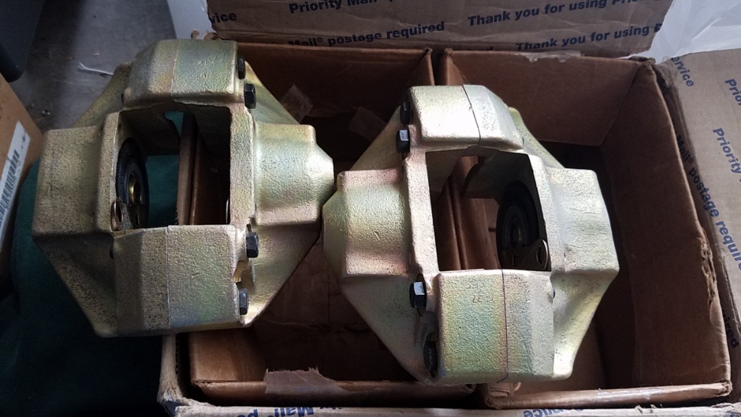

Picked up my new to me PMB Performance rebuilt calipers down at my PO box. I got a deal that was too hard to pass up in our classifieds section.
Almost too nice to install on my 914....

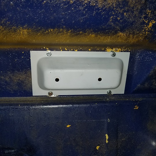

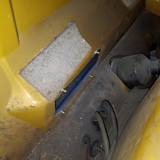

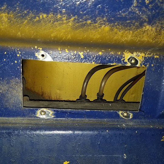

Working on Mike's (Warpigs) car. He's chomping on the bit to be back on the road.

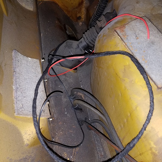

Next stop. Fuel pump relocated to the front. This will be the 3rd 75+ fuel cover/mount I've cut out and installed with nutserts. Three port pump takes a little larger hole.
Nutserts, front and back.
Re-Routing the fuel pump wires thru the snorkel. Today I'll create a red and black 2 wire harness to run with the tunnel harness.
This morning I'll dig into the hellhole with multiple wire brushes and see how much of rust I can remove. Plus create the patch in the engine tray where the fuel pump used to be hanging by a thread.

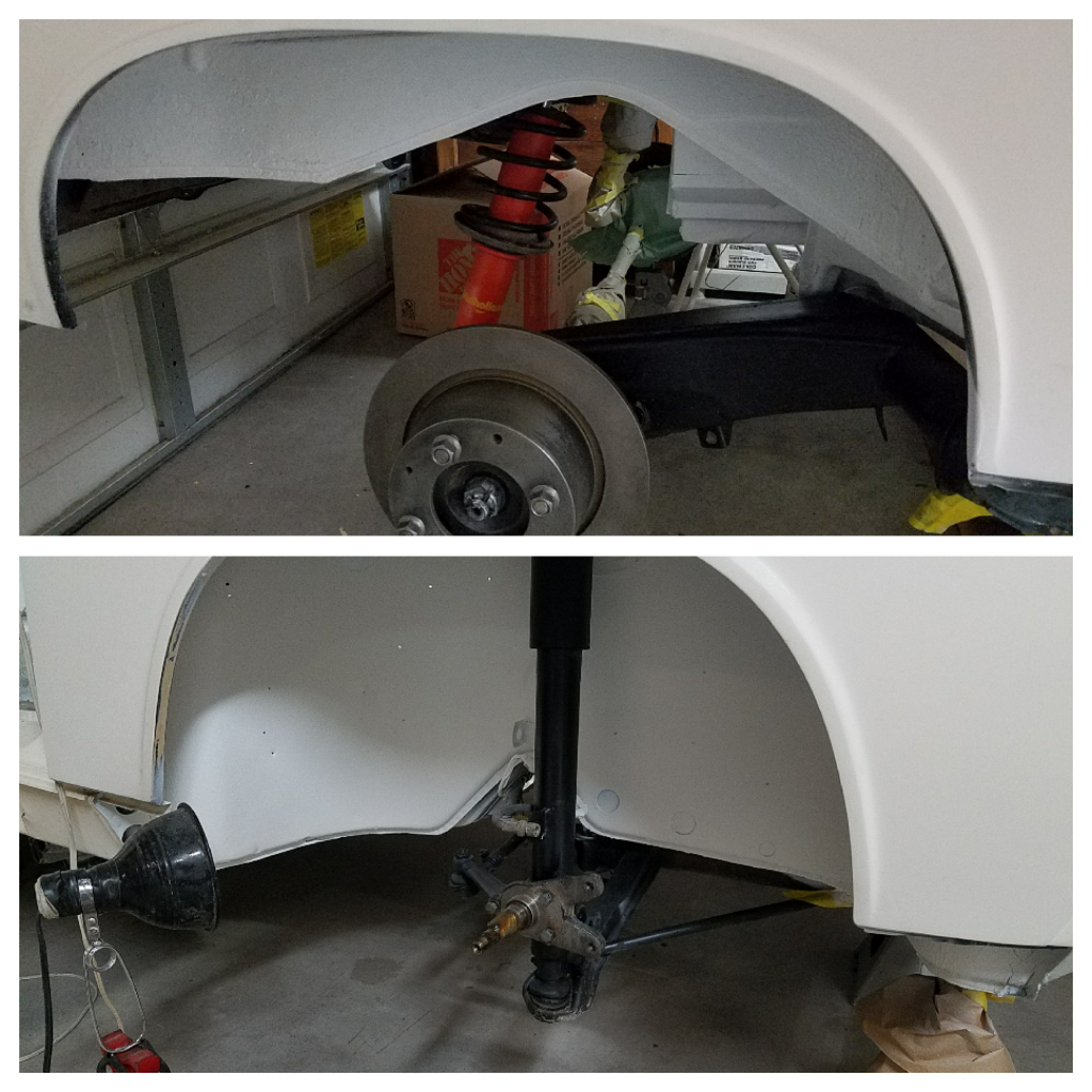

Wheel wells today. One side at a time. Bigger garage would help a ton.

I installed one of those oilites and it needed to be flipped so the flange was inside the console to allow the shift rod full range of motion. You may want to check that before you button it all up!

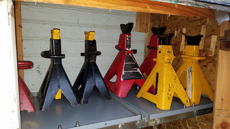

Sort of 914 related, made a new shelf for my jack stand collection. Used all parts I had laying around so no extra money spent.

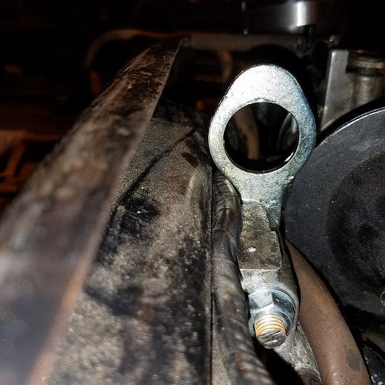

A little update on the weekends work on Mike's (Warpigs) car.
Added lift rings to his engine for easier lifting too and from the table and engine stand.

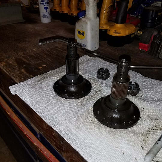

Removed the 1/2 shafts and ran the hubs thru the parts washer.
Mike's going to rebuild the half shafts during the week.
That's not water. Sprayed them down with WD40 to keep them from rusting instantly.

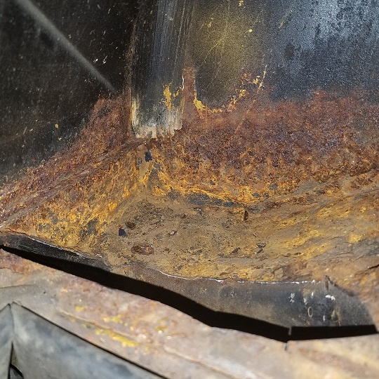

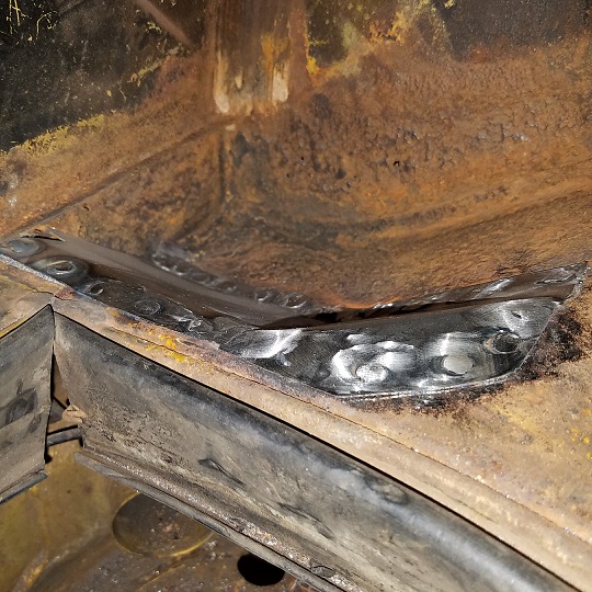

Did a temporary repair on Mike's Hell Hole. Car will get restored/rebuilt into a GT in couple years. Patched and treated with OSPHO after this shot. A couple holes starting in the wheelhouse wall, but I didn't touch them. Not in the scope of work on this project. They'll get a dab of seam sealer and the entire area will get sealed up with Eastwood HD Anti Rust.

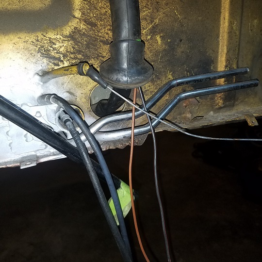

Primary Sunday project. Creating and installing relocated fuel pump harness. In the snorkel and lays with the harness and speedo cable.
Need to determine point of entry into the tank cavity and solder on the OEM connector when the final length is determined.

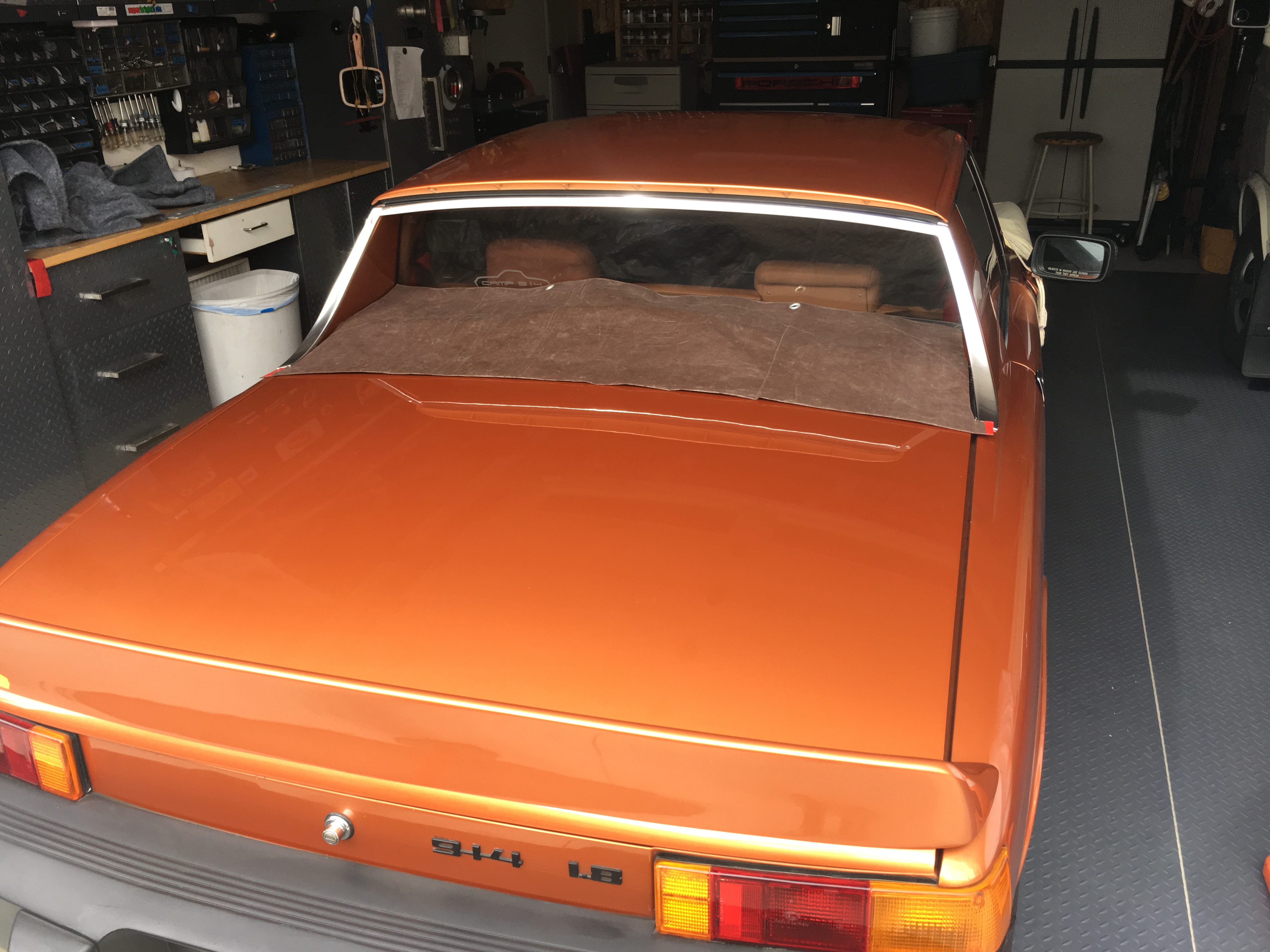

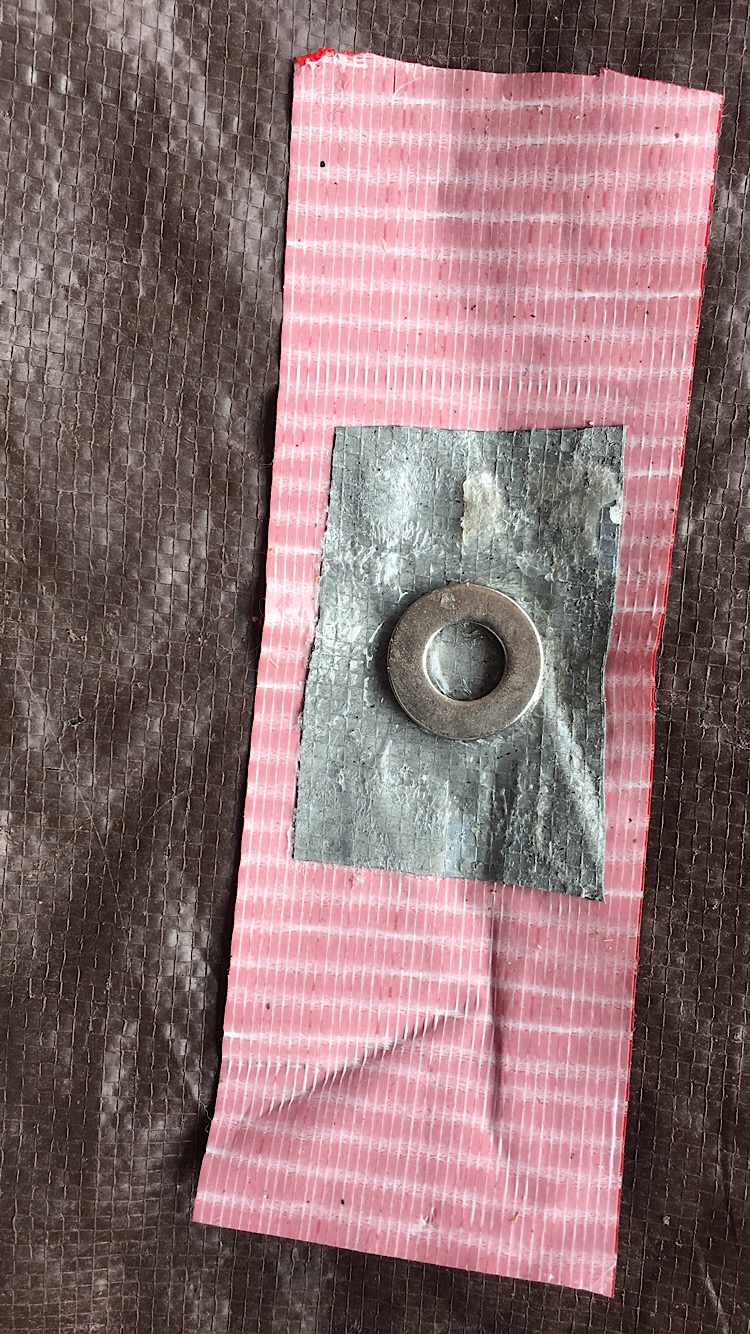

Made a cover for the GT engine compartment lid to keep out water when washing or get caught in a sudden downpour. I cut a piece of brown tarp to fit, then attached 4 small rare earth magnets to the cover to keep it in place HD has the magnets.
