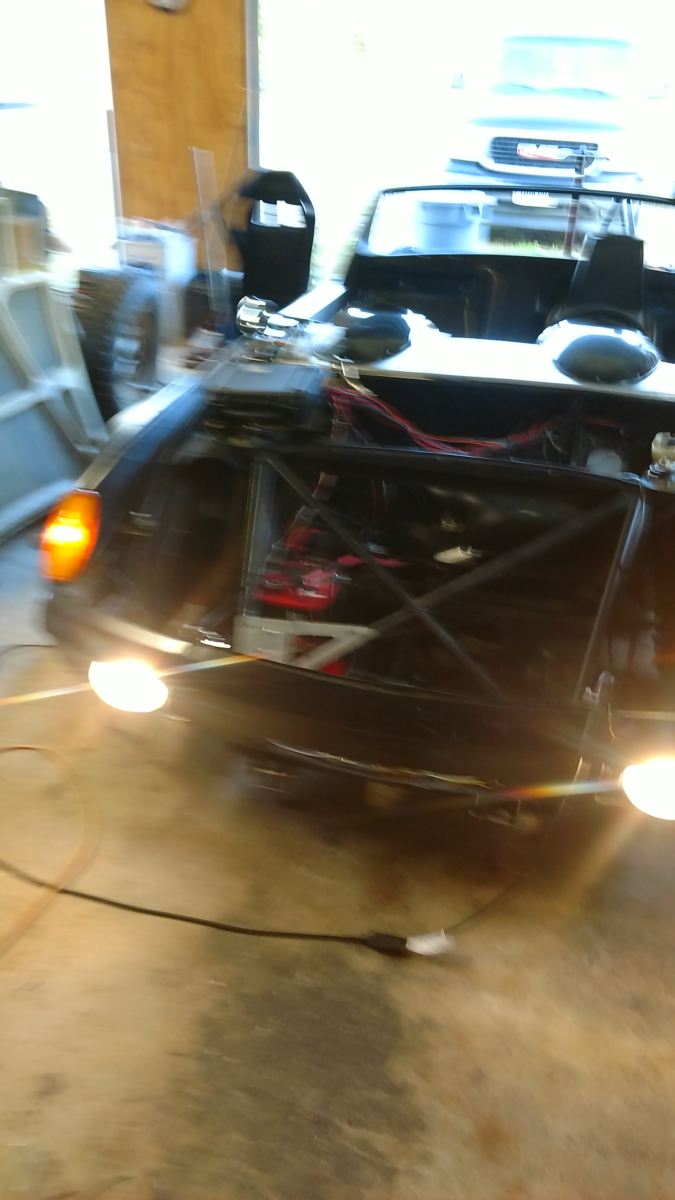

First of all I would like to thank Doug and Andy. Doug for this thread and the quote about eating elephants and Andy for this site and teaching me to take pictures.
In the picture above the dry box is closed and all the circuits are on and no blown breakers... Man she's​ gunna be so fast it shows in pictures.

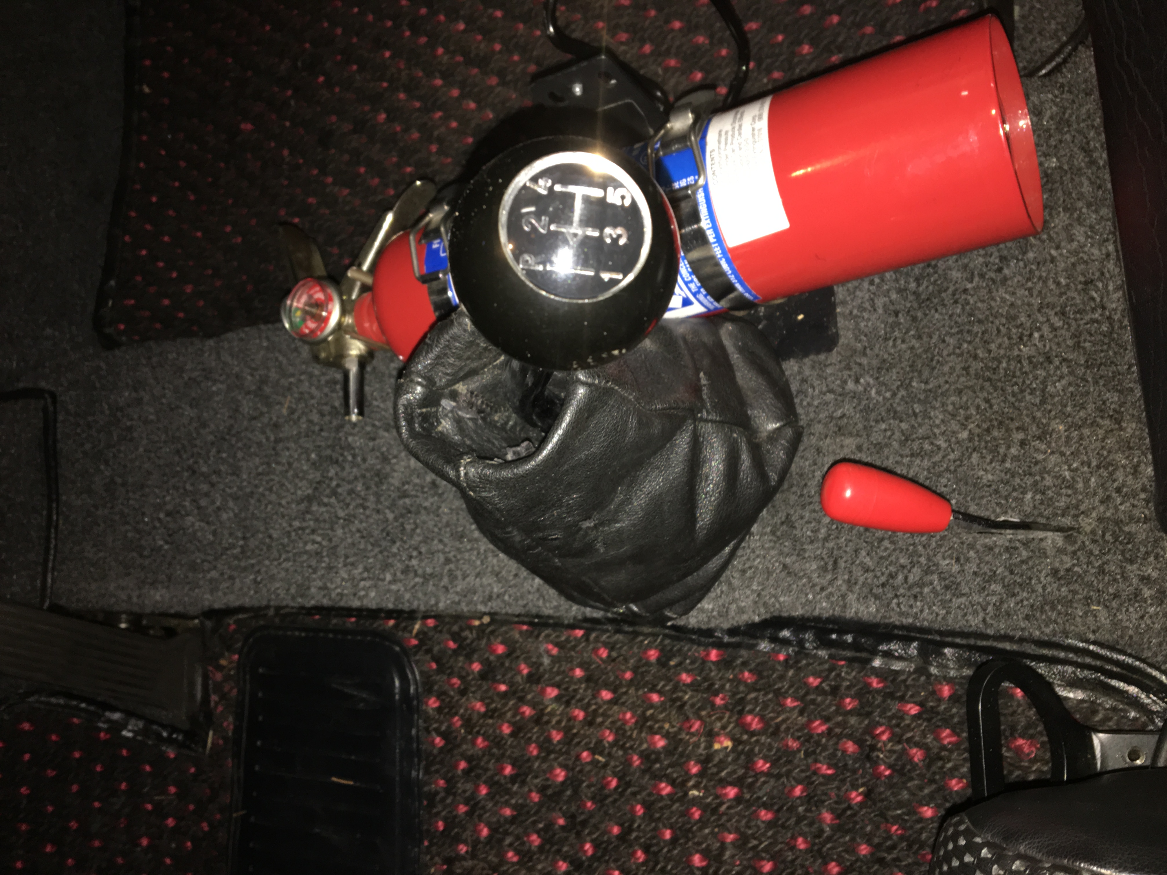

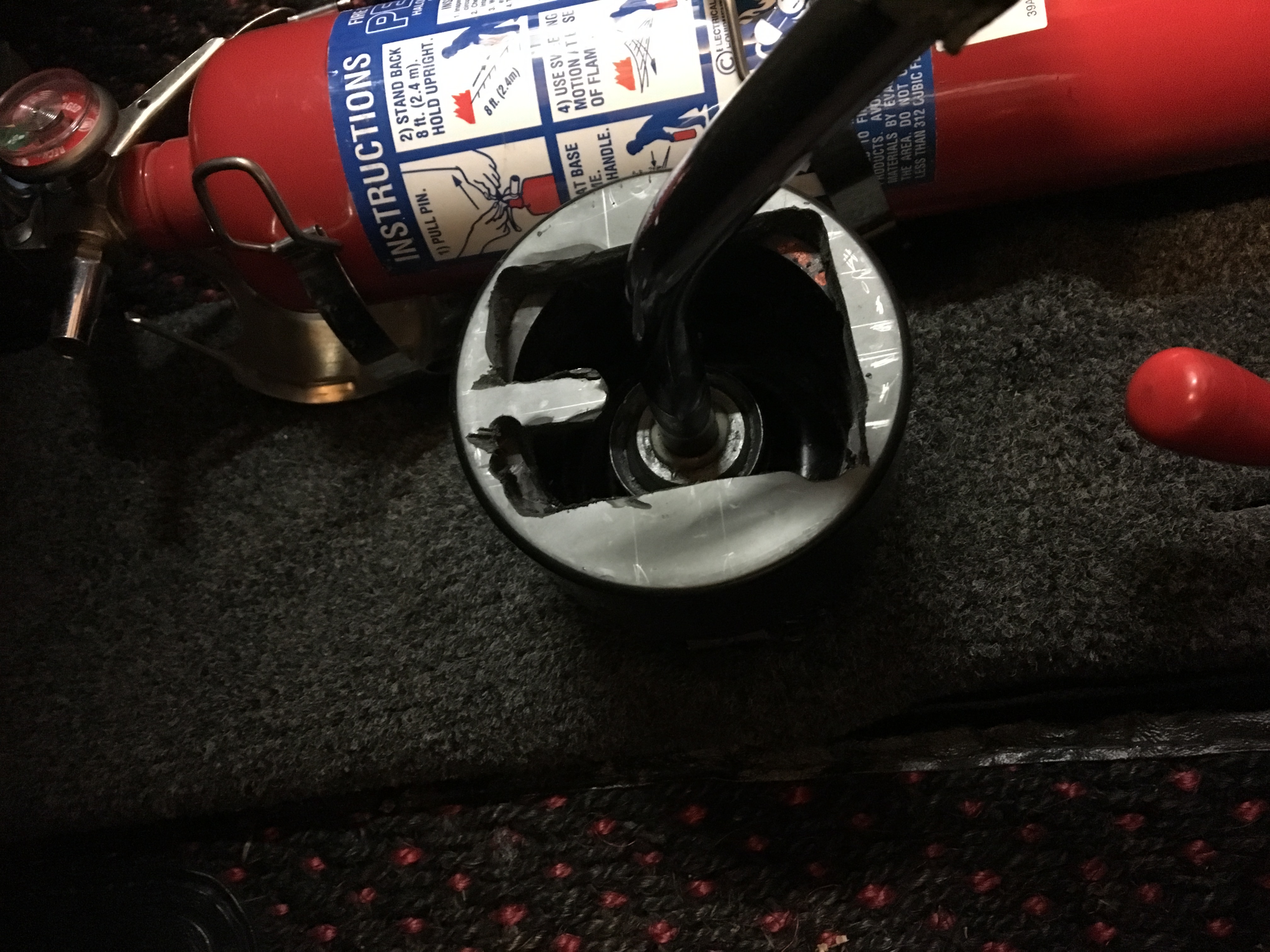

Because I am a total tard and cannot get the used to the slightly off to the right 2nd gear location due to the side shifter on the 6, I always ground the gears if I stopped paying attention and thought I was driving a normal manual like my other 2 cars. So I built a quick and dirty blocking tongue using 3” PVC pipe cut 2.5” in length with a cap cut with a tongue to keep me going into second rather the space between reverse and second. Works great and cost $6. It’s anchored with a couple of L brackets. When covered, my abomination of a hack job is out of sight. Looking at the pictures, I am a tard and a hack. Attached Image Attached Image
What ever works...

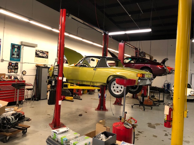

Getting closer... there were four 914’s in the shop (IMG:style_emoticons/default/smile.gif)

QUOTE(Jett @ Dec 6 2017, 10:29 PM) *
Which shop?

Took pictures. Everything thing up here works now on to the engine bay.

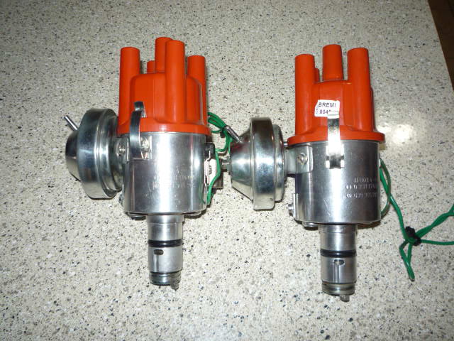

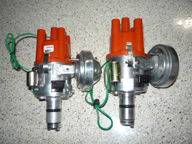

Christmas bling arrived today. Restored 2.0L distributors. Ready to go top to bottom. Set to factory spec on Sun distributor machine.

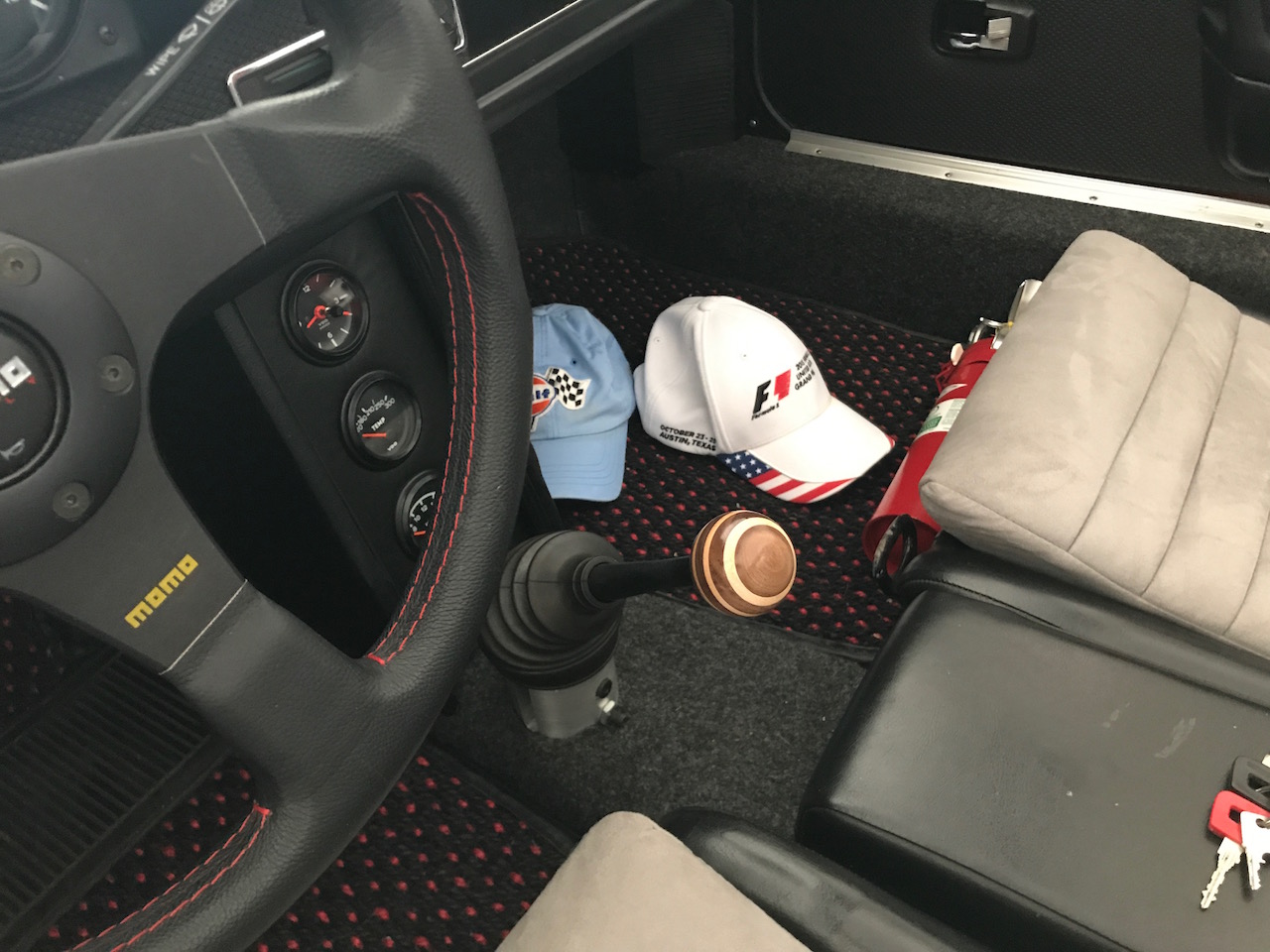

SKL1
post Dec 8 2017, 03:03 PM
Post #9737
Posts: 1,736
Joined: 19-February 11
From: north Scottsdale
Member No.: 12,732
Installed Vacca's shift knob on the '73. Looks great!

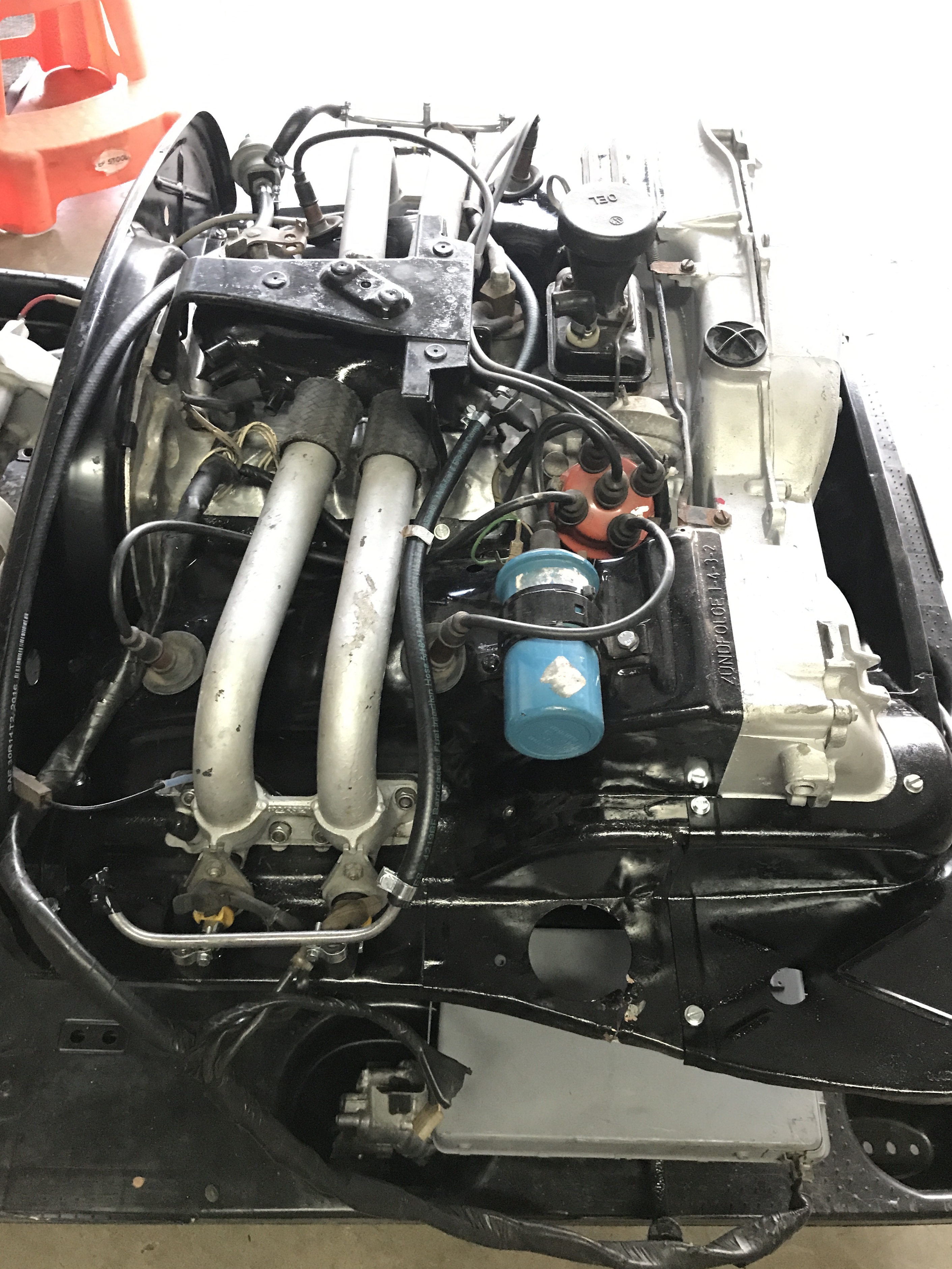

Member No.: 13,474
Installed elbow rubber fuel lines on injectors and other FI parts to a member 1.7 engine.
