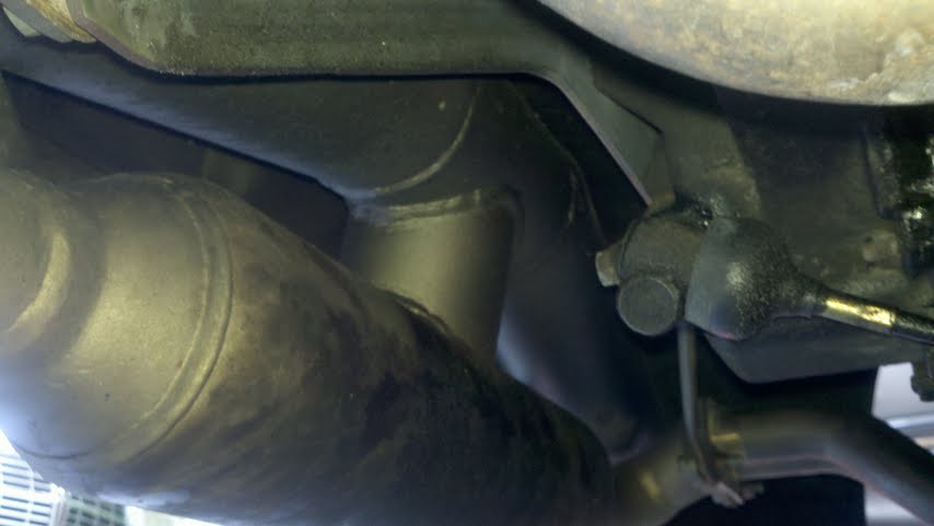

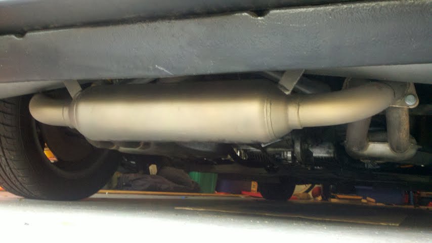

I have new A/F meter from Summit racing ,
my car is a 75 2.0 d-jet that has SSHE and a Triad dual exhaust
1. where do i put the O2sensor - where to have the guys weld it
2. i think the electrical hook-up is pretty easy, but if anyone has done this and has suggestions or advice before i proceed, please do so!!!
Thanks
Phil

mrbubblehead   i put mine right after the collector. where all 4 ...   Dec 27 2011, 07:55 PM
kg6dxn   The WB sensor is heated. It does not need to go cl...   Dec 27 2011, 09:56 PM

mrbubblehead   no, your wideband does have a built in heater. i a...   Dec 28 2011, 09:57 AM

sean_v8_914   sensor must be between 9 o clock to 3 o clock (nev...   Dec 28 2011, 11:38 AM
