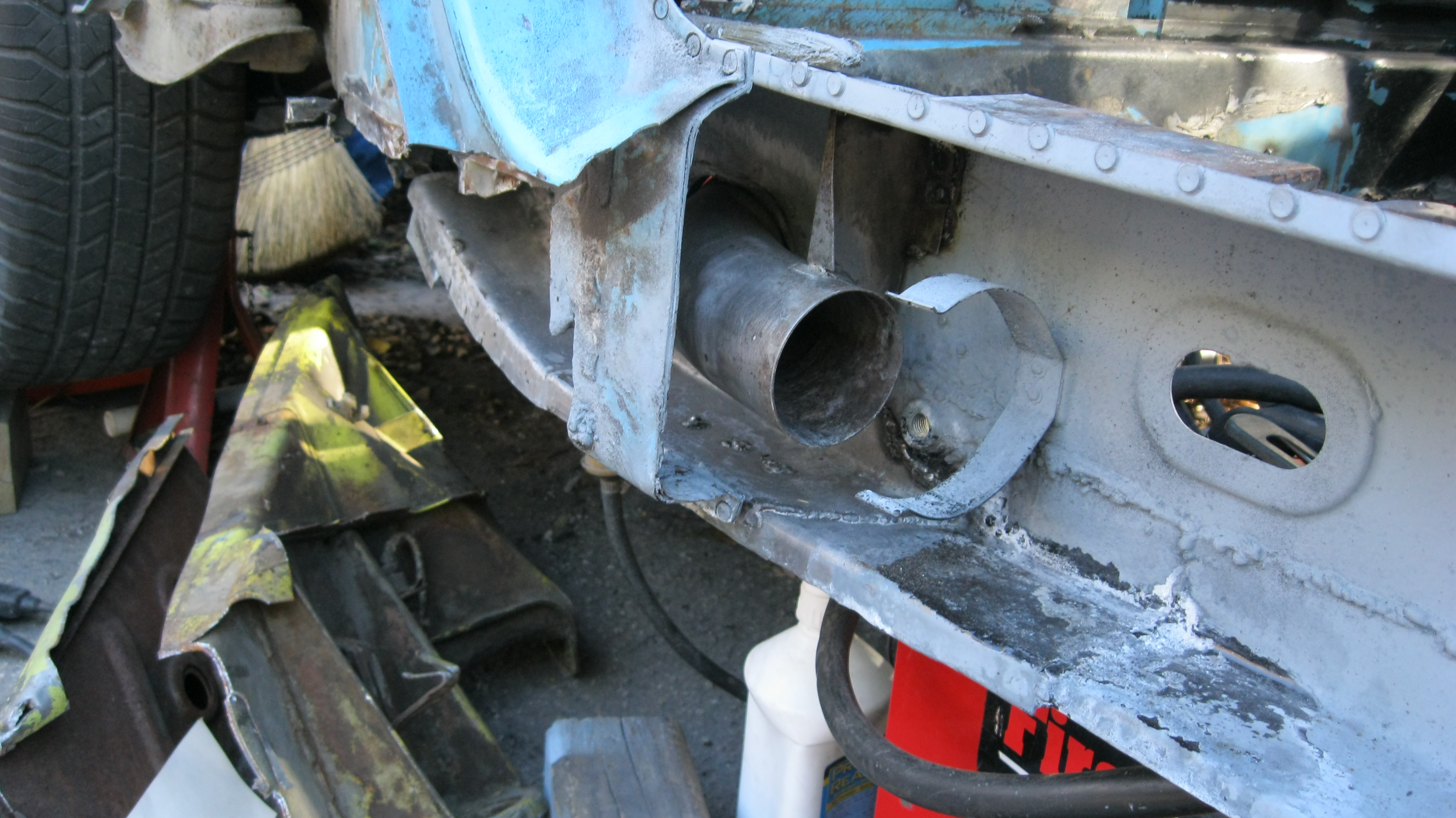

A little update. So classes have started again. Ugh. Its going to be a rough semester of statistics, ecology and soil dynamics. Hoping to get up early in the mornings to get as much done as possible, and POTENTIALLY make it to Sebring with the car. We'll see.
The below picture is how the car ended December. Unfortunately I prematurely did my POR work, not remembering that the welds I was doing on the inside of the car were going to burn through the POR. I also coated this in cold galvanizing compound for a little added protection. Long story short, I think I'll end up stripping out a lot of this and doing it over. Especially when I weld in the inner long stiffeners I'm fabricating. Essentially they're a cheap rip-off of the Engman kit (sorry!) I'll get pics of that up soon.

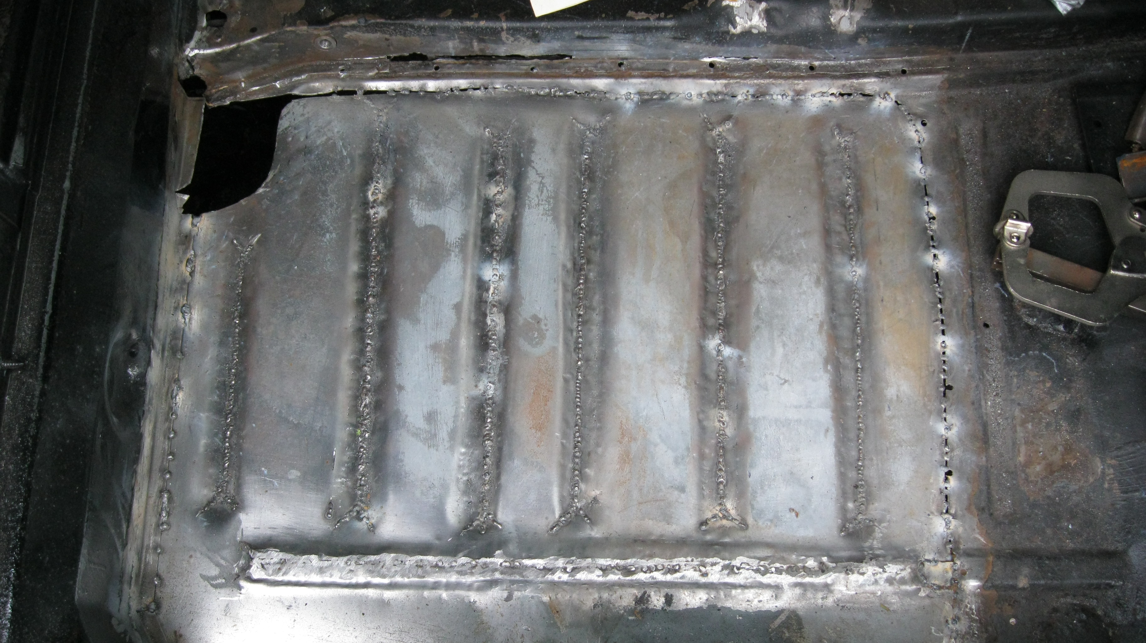

Marc and I fabricated a new floorboard for the passenger side as well! I'll post a picture of that tomorrow. It ain't half bad for a couple of novices, or cheapskates, however you look at it.

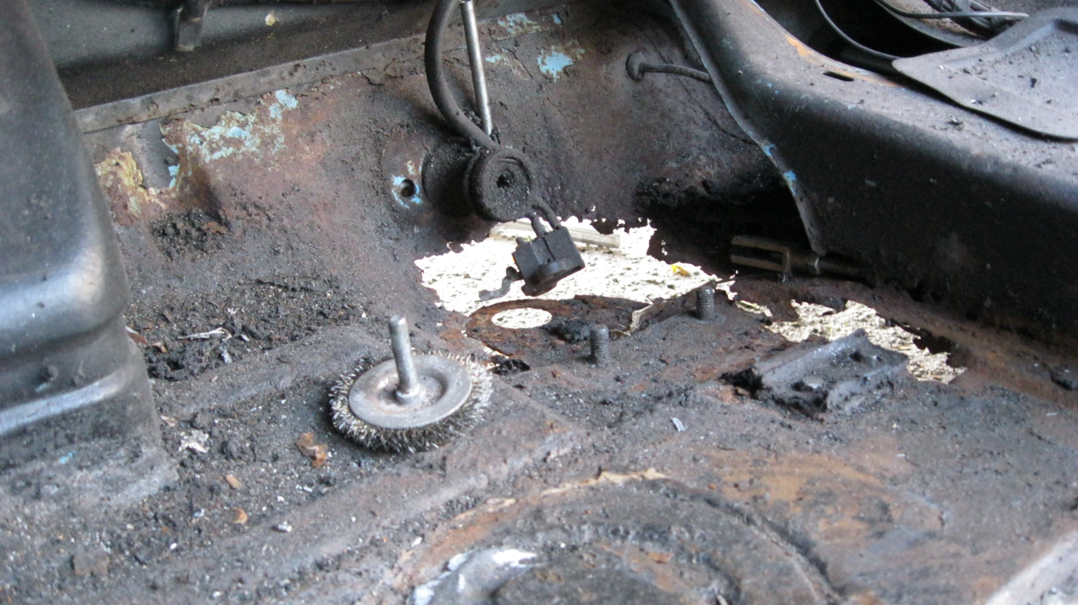

We also got the pedal assembly out. Kevin, if you read this, how the HELL were you even able to drive this car? Glad we got to it when we did, otherwise this could have been bad...

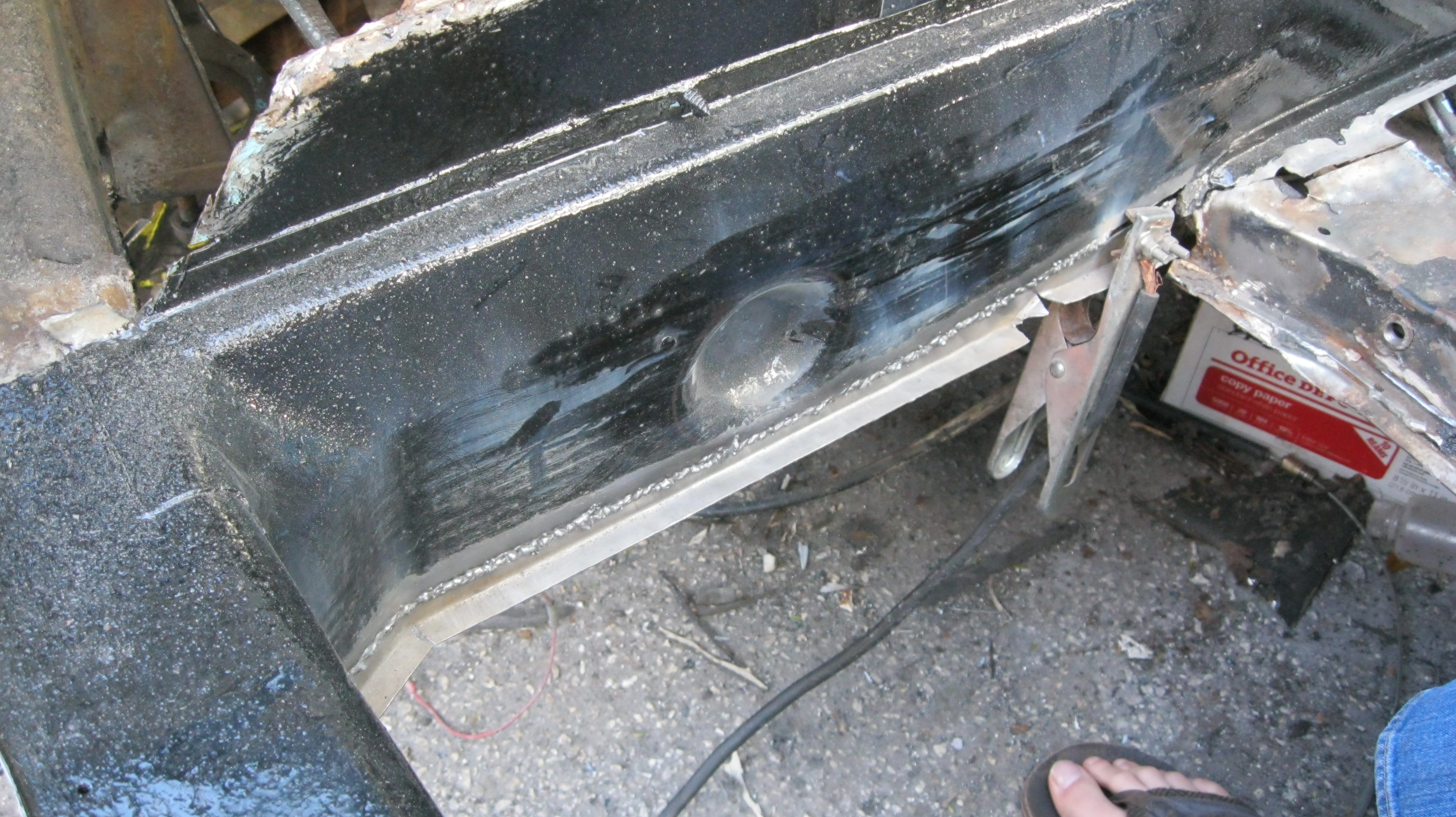

Safety note: welding (and even turning a wrench) don't play well with flip flops.

I have reminded him of this a million times. Marc is a beach bum from the east coast, but won't listen to someone who has already been burned a few times. At least I got him to wear a freakin helmet.
Speaking of which, I don't know if I already mentioned this. After my first big day of welding I had the strangest sensation in my eyes before going to bed. Could not figure out what for. Then, by 3:45 in the morning, when I could not keep my eyes closed for more than a few seconds without searing pain, I began looking around on the computer. Sure enough, I had welders flash. Let me go ahead and tell everyone if it hasn't happened to you yet, you DON'T want to experience it. For me, it was the cheapo Harbor Freight helmet I was using. I think the batteries for the auto-darkening function were bad when I bought it new. So, I did the repair that this guy thought of http://www.pskl.us/wp/?p=648. Worked perfectly. I highly recommend that if you have this helmet you go ahead and just do it. It will save you money... and a lot of pain at some point.

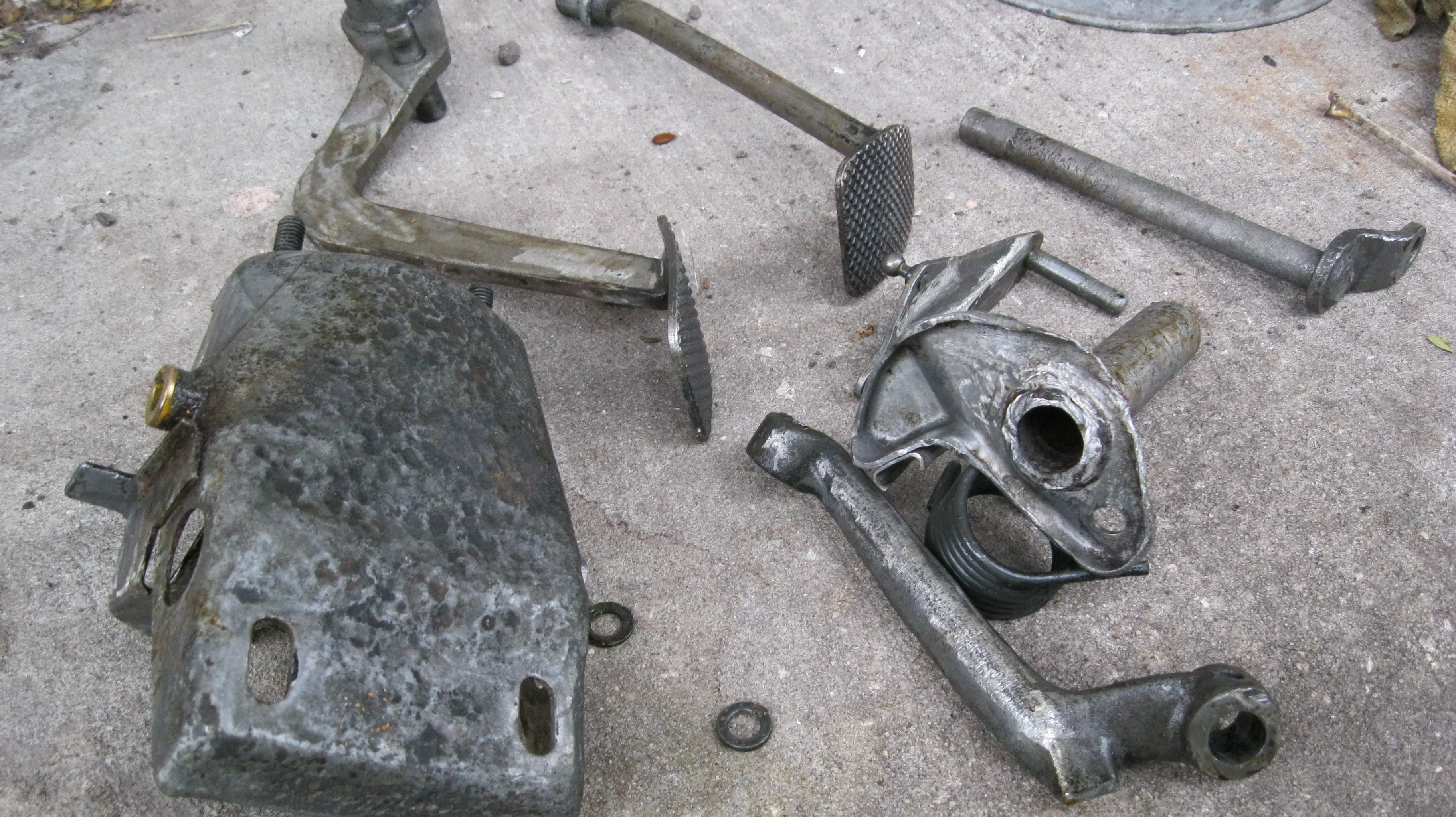

I also pulled the pedal cluster apart yesterday. What a bitch. The roll pin was the least of the worry. On this car, the clutch pedal arm had rust-welded itself to the shaft that it rides on. I resorted to a pickle fork to get the thing off, which buggered up some of the metal and welds on the cluster. I'll have to do some re-shaping and welding once the replacement bushings get here. I'll also POR it at that point. Check out the bottom of the base and all the pitting. Yikes.
Of note, I used a product called EVAPO-Rust, commonly available at Autozone, Advance, etc. Man, this stuff is amazing. Its not acid-based as far as I can tell, and will not burn your hands. I got everything as clean as I could prior to dipping it, but once I did, this stuff found its way into every pit and hole in the metal. I'll still wirebrush and clean the metal before using POR, but I was really impressed. Especially since I've been getting AWFUL results with POR's "Prep and Ready." I haven't painted a piece yet that hasn't fish-eyed. Maybe this stuff will help.

Thats scary to look at and think that I drove it.. Its worse than I remember it to be. (IMG:style_emoticons/default/barf.gif)
Looks like it was holding together with hopes and dreams..

Trash that pedal assembly. There isn't a whole lot of steel left in that pan. You are going to be kicking those pedals, but not for very long before something bad happens.
Yeah... thats what I was thinkin. Its pretty much pitted through in some spots. Not sure where to get another pedal assembly though. Don't want to pay for a completely rebuilt set.

Yep, Trash that George, I may have one or at least some good parts

If you do indeed find one, let me know. The base is really the only part that needs replacing. However, I did bend the clutch tube a little when I had to use a pickle ford to remove the clutch pedal arm. I think I got it bent back enough to be okay, but this part would help as well. Thanks brotha!

Do not Por15 the pedal assembly when you get the parts, that stuff is thick and things might not work. Just sand blast parts and paint with rattle can.
