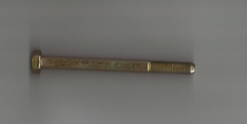

Does your bolt have the tapered end ?
Attached image(s) ![]() |

I like the tie wrap idea. I have to check next time I take the engine out if the boltis tapered.

I did have it raised to the one of the trans mounts and almost at the other. The front was making contact. I had the front bolt in, it just wasn't threading.
rgalla do you remember if your bolt tapered? Thanks guys maybe it was just off a little? |

The front bolt is the original tapered one! I guess I was not going in straight. Next time.
