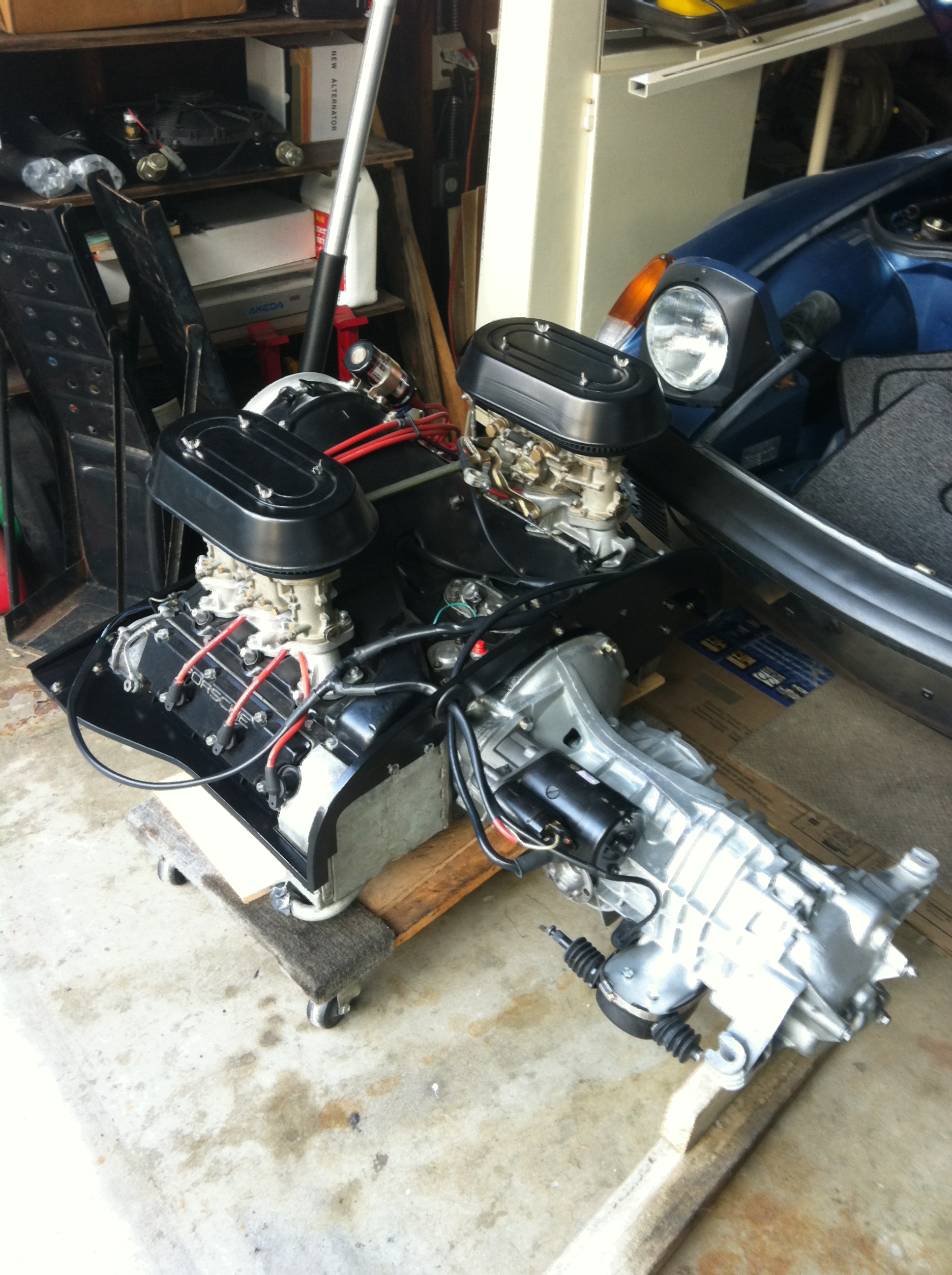

I mated the transmission to the engine and installed the starter and wiring today. For giggles I tried to pull on the clutch release arm but could not get it to budge after contacting the pressure plate.
Dumb question, is there anything to do but push the transmission and engine together and tighten up the 4 or 5 nuts/bolts? I'm wondering about that clutch, should I be able to depress those springs on that pressure plate by hand? The whole thing kinda when together alot easier than I imagined, did I miss something?
Kev

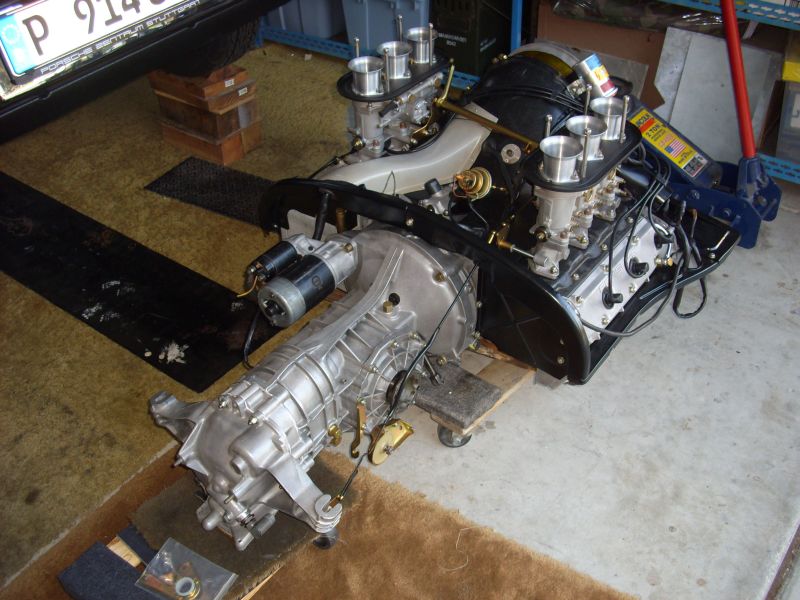

Damn. . looks like we are at the same point on our cars. . I'm stuffing mine tomorrow, ,

If you can not move the arm back and forth at all, that is concerning. There should be some play before the throwout bearing hits the pressure plate fingers. If no play, then you have a bearing hitting the plate too soon and it will not completely release. A common cause of this is the pivot ball being spaced too far. I would part it and take a look and maybe some pics.
The arm has a few inches of throw before it contacts the clutch.

Dr Evil
post Dec 31 2011, 08:50 AM
Send me your transmission!
Posts: 23,041
Joined: 21-November 03
From: Loveland, OH 45140
Member No.: 1,372
Perfect! (IMG:style_emoticons/default/thumb3d.gif)
Carry on (IMG:style_emoticons/default/biggrin.gif)

QUOTE(toolguy @ Dec 30 2011, 06:12 PM) *
Toolguy,
that motor looks 'clean' too.. one question for you, where did you secure those venturies on the webbers?
JawjaPorsche
post Dec 31 2011, 10:00 AM
Posts: 3,463
Joined: 23-July 11
From: Clayton, Georgia
Member No.: 13,351
Wow! That really looks awesome! I bet your Teener is like a rocket ship with that behind your seat!
QUOTE(toolguy @ Dec 30 2011, 09:12 PM) *
How did it go? Did you get yours in yesterday? I've been scratching my head wondering how to get mine off that dolly and on to what to lift it in to the car.
Steve
post Jan 1 2012, 10:26 AM
Posts: 5,896
Joined: 14-June 03
From: Laguna Niguel, CA
Member No.: 822
QUOTE(kconway @ Jan 1 2012, 08:10 AM) *
PIA.. I did it that way in the past. I used two floor jacks one on each side and lowered the car onto the motor and trans. I also used jack stands as a backup and then bolted everything up and raised the car back up with the two floor jacks.
I now have a scissor lift and a lift table. Much easier!!!
