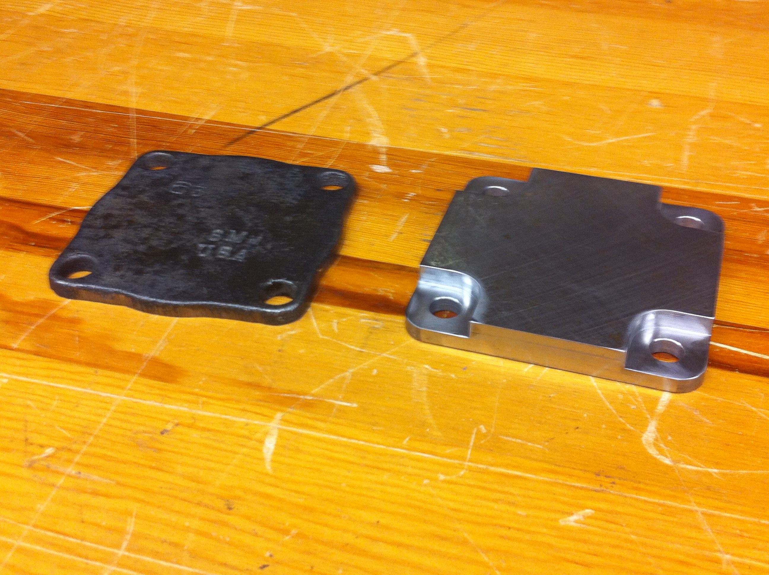

It seems as thought every new oil pump I put on a type IV motor wants to leak. I've had to flat grind three previous cover plates to get them to stop leaking. We just finished the rebuild on a friends motor (" Dion "on World) and the @#*& thing is leaking. I think the plates are too thin and deform between the bolts and leak. The onion skin gasket isn't enough to make up for the .0015"-0030" warp in the plate. Which is the amount of bow I've found in all three cover plates. It's really meant to give the correct end play for the pump gears. So I decided to make a thicker plate with counterbored recesses for the nuts. It's been flat ground and shold be nice and dry, the rest of the motor is! We're rebuilding the gearbox this winter, so it won't be back in the car for a couple of months. Here's the pic of the new one vs. the stock one.
