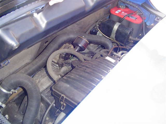

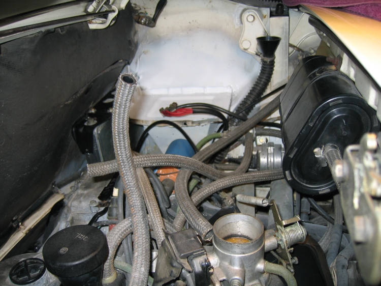

Ya, Yours probably had one long ago. It was likely mounted in the engine bay like these ones (2.0 pictured)
Here
Or Maybe here?

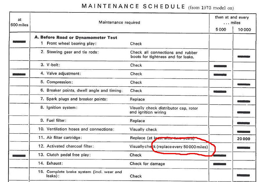

The activated charcoal was designed to be replaced after 50K miles or so. The later plastic canisters are easily opened up and activated charcoal pellets can be had online...maybe aquarium stores if you need it locally.
The charcoal just absorbs fuel odors.
