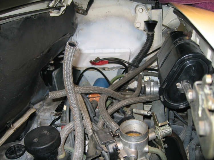

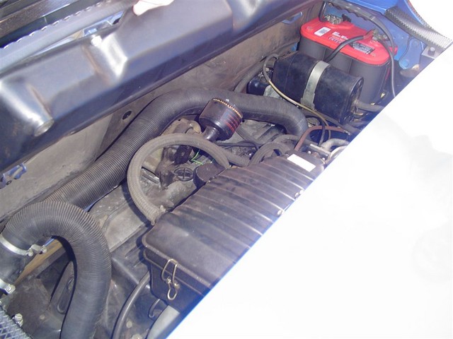

Strudelwagon
Jan 8 2012, 11:25 PM
Ya, Yours probably had one long ago. It was likely mounted in the engine bay like these ones (2.0 pictured)
Here
Click to view attachmentOr Maybe here?
