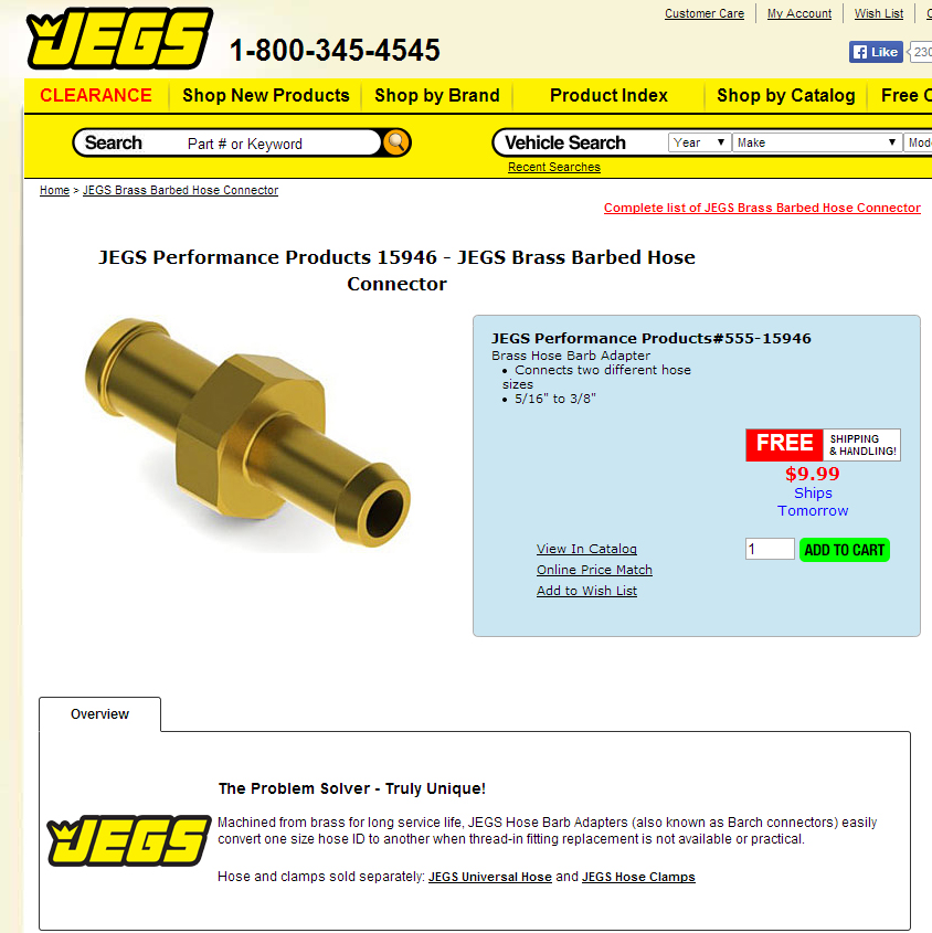

pete000   I noticed Sierra Madre lists them as NLA now too.....   Aug 6 2014, 11:18 PM
Phoenix914   That looks like a nice piece, and cheaper than a M...   Aug 7 2014, 05:09 AM
Racer Chris   That Jegs piece is perfect.   Aug 7 2014, 06:16 AM
Phoenix914   That Jegs piece is perfect. Looks like it might...   Aug 7 2014, 06:22 AM
Racer Chris   That Jegs piece is perfect. Looks like it migh...   Aug 7 2014, 07:45 AM
