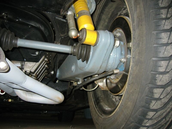

Here is my ......

Wanna run vented rotors on the rear?
BTW, I forgot to ask why ?? Why vented rotors ?? Is it race car or just for the look or are you going to use some big four piston calipers ??
I had to use them. I could not register my 3 liter six without vented rear rotors. It is not so simple to do conversions here...... (IMG:style_emoticons/default/mad.gif)

tell me about those rear sway drop links (IMG:style_emoticons/default/smile.gif)
