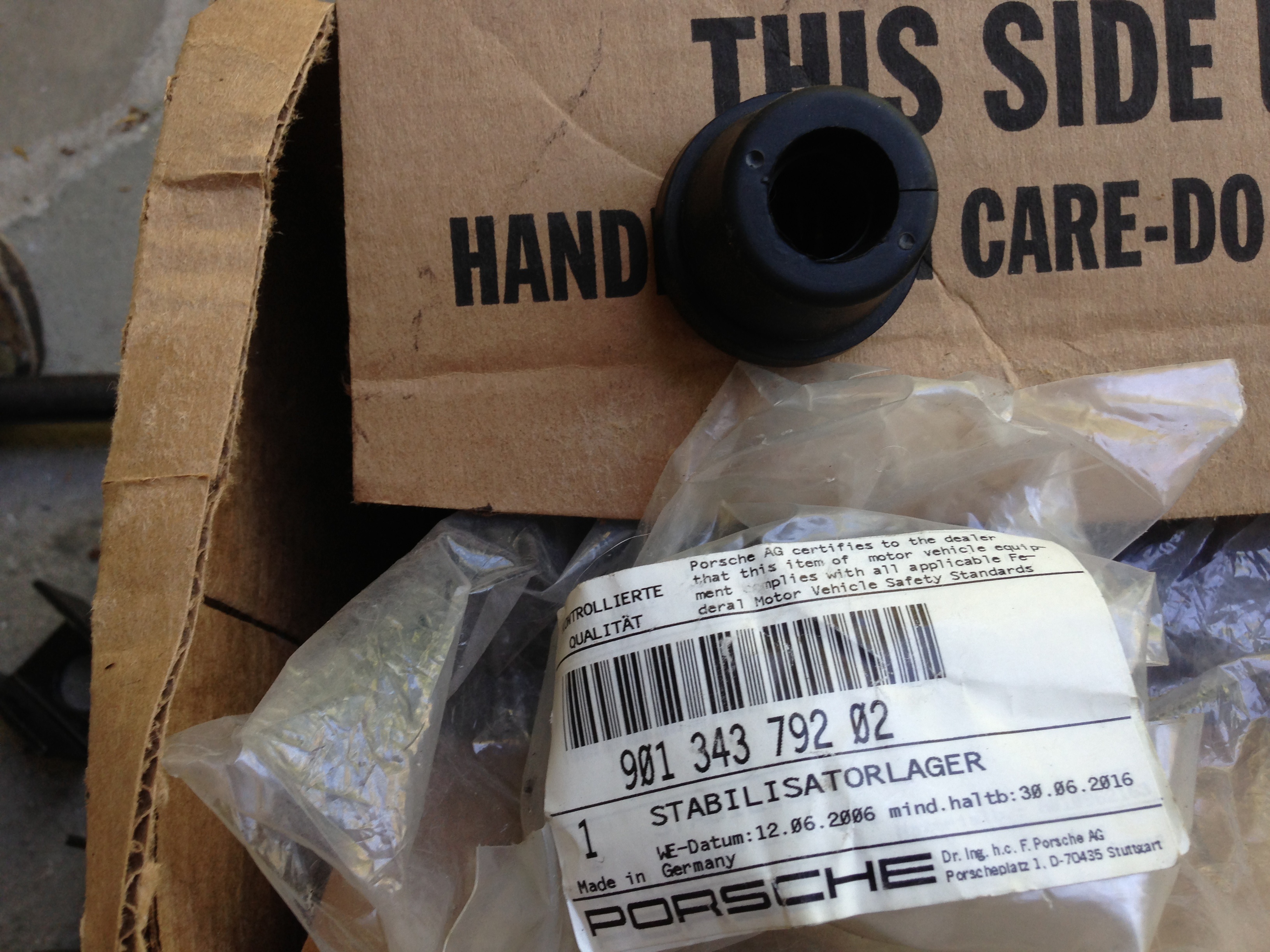

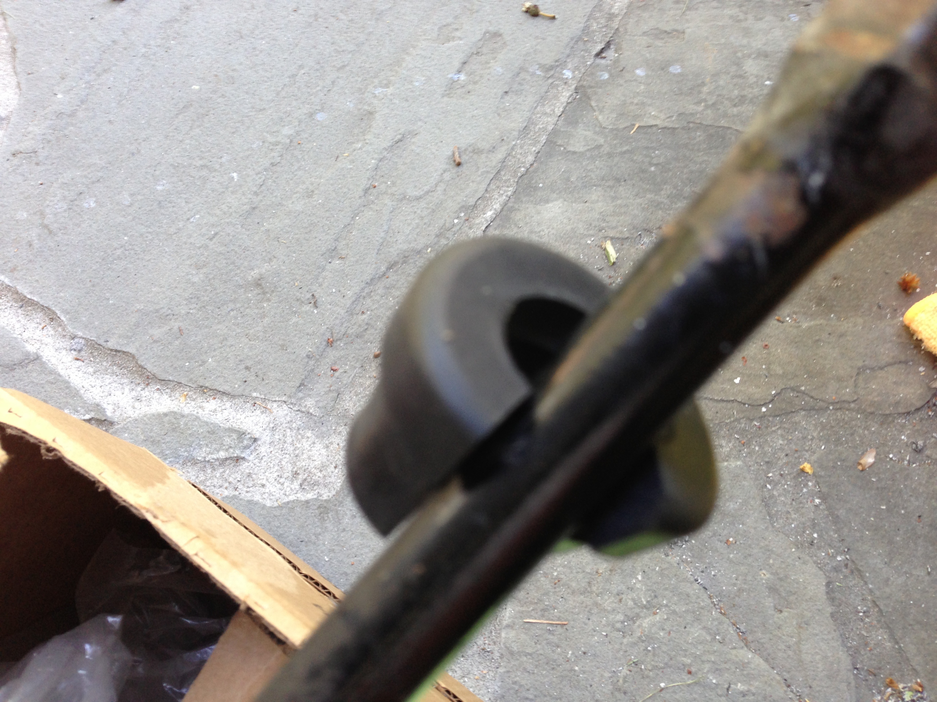

They are split from the factory
Regards
James
jesiv
post May 14 2013, 07:06 PM
Posts: 552
Joined: 5-August 07
From: Pensacola/Milton, Florida
Member No.: 7,975
These are available from Porsche now for $15
