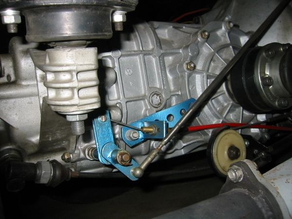

I am in the process of coming up with a linkage setup similar
to Roots post. As far as installing it on the trans I see I use the bolts
on the cover for the cable bracket but as far as the pivot arm do I have
to drill and tap into one of the round bosses on the case?

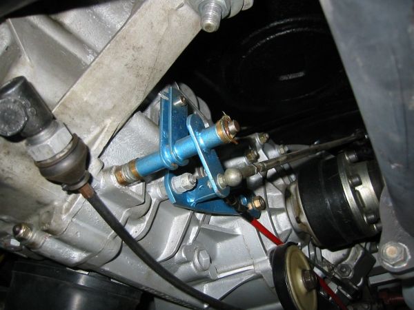

Yep, if I understood what you are doing. I drilled and tapped one round boss from the trans case.
But, I have home made linkage. If you have some kit, I dont know anything about them. Mine is a look-a-like from the original (IMG:style_emoticons/default/cool_shades.gif)
I´ll see if I can find some pics.

I took some pics....
914Timo
post Aug 27 2004, 01:11 PM
Posts: 743
Joined: 13-January 03
From: Finland
Member No.: 137
Region Association: Europe
#2

Thomas, I used to think that way too. I tried different linkages, but I have to say this is the best. It is light and there is no extra clearances.

Timo, Nice setup. I plan on making my own linkage and yours looks like a
good setup. Thanks for the pics
