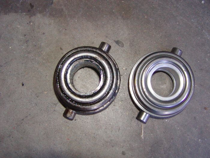

> T/O bearings continued.. Did I get the right thing, Brad or anyone.. Looks the same as stock
dan10101
post Aug 28 2004, 03:23 PM
TORQUE-o-holic
Posts: 1,140
Joined: 29-April 03
From: Eagle Point, Or
Member No.: 626
Sooo... Recieved my T/O bearing yesterday... Today Im trying to put it in.. We... As you can see. its exactly the same as the stock one. Did I tell the lady at KEP the wrong thing?? I told her its for a 901 trani, for use on a v8 with their KEP clutch/pressure plate package.
What to do?

Brad Roberts   See if the fingers line up perfectly with the stoc...   Aug 28 2004, 04:50 PM

Brad Roberts   Save yourself the headache NOW and buy a new clutc...   Aug 29 2004, 11:05 AM

Brad Roberts   Dan, I'm concerned about this for one reason:...   Aug 29 2004, 11:45 AM

Brad Roberts   Yes. That is how they are getting away with the st...   Aug 29 2004, 12:01 PM
dan10101   Brad, I told them it was for a 901 trani to their ...   Aug 29 2004, 12:02 PM
dan10101   Alright, I'll put it together.. I'll be b...   Aug 29 2004, 12:04 PM
