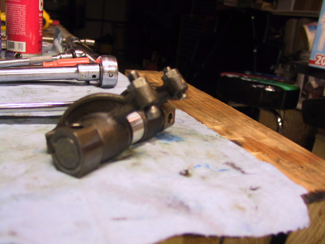

Ok, after mocking up the alignment...It looks like I need to take the .060 off the swivel side...right???

shot of rocker on head....

No, these are swivel feet to replace the valve adjusters. Instead of a solid bar rolling/rubbing on the valve stem, these have a ball and socket that is allways aligned with the end of the valve...its cool because it is used in the little winky 911 valve adjusters....one of those "got to have's" because you can.....
Makes my car more 911 than before...I also want to use them due to my high lift cam and extreme valve geometry....

Yes, you need to take .060 off the swivel side to make them clear. I have 911 adjusters on my 2270 with a 163/86b cam.
I needed a little shim under the rocker as well - .020 if I recall???
(IMG:http://www.qtm.net/~persot/t4-9-27-31.jpg)
I have one oddball adjuster with the standard head, but the rest are phillips...
Tom

Thanks for the picture...that is the only way I could think to do it....
Now to measure and cut push rods...the fun never ends...
