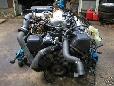

Anyone guess what the basis for this next little project is?
Hint 1: 4 cams
Hint 2: Twice the cylinders of the orginal motor
Hint 3: Twice the displacement of the orginal 73 special edition.

914 Freak!

Diesel Mercedes ?
B

Sure dosn't look like a LS2.
Must be a Lexus V8 from a GS400

I was looking at a diesel, you know how popular they are becoming in big time racing.
Yes it is a 4cam 4.0 litre Lexus 1UZ V8. All aluminum, 6 bolt mains, four valve heads, lighter than the factory LS2 engine, about 20 times cheaper than the LS1 or Ls2. From what I have heard on the net shipped weight for this engine, with all the stuff on it was less than 400lbs. Try that witha small block.
Rumor has there are a few blown drag cars running this engine making 2000+ hp on the stock block and crank. Obviously I am not looking for that but it is noce to know the potential is there.
As soon as I finish the blue car this winter, I begine the next project. V8 monster, semi tube frame, dual a-arm, Sheridan Wide body kit, the whole 9 yards.
Kinda like the CarreraGT Junior.

f-ing awesome. too scary to be true.

Check out
http://www.lextreme.com
for more info.

Pretty crazy. I knew those where pretty stout engines.. but I had NO idea they where that stout.

That is why I chose it over the small block and current variants. The Japanese know how to build a motor right. THis thing is really small dimensionally. I may even try a test fit in the stock chassis. It would be neat if this engine could actually fit in stock chassis.
