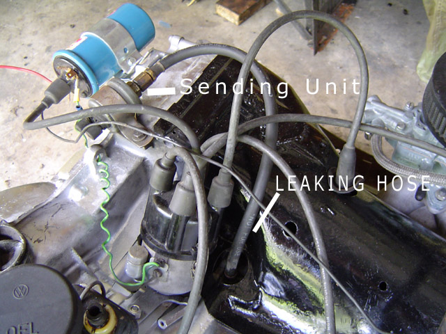

Does anyone know where I can get another hose for this sending unit? Apparently the kit is NLA from VDO.

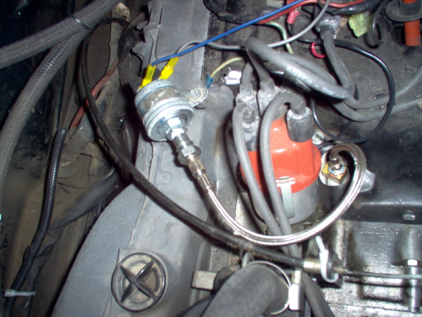

Aircooled.net sells a braided steel hose for that application. It's about $20. The threads on the sender will depend on which sender he has. Could be m10x1. See this link

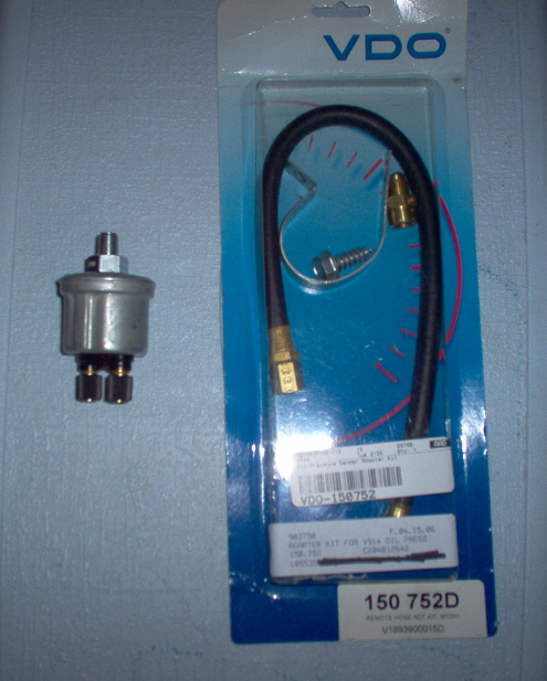

I have one in the box still,I think it was the last one around, I paid 38.00 plus shipping, but I made my own kit. I did not like the way the threds were on the VDO kit. The threds were 1/8 inch pipe thread into the case, your old hose may be the same, with 10x1mm fitting for the sender. I will post pictures if I can find them. If you would like to buy this one 25.00 and I can send it to you or you can make your own. If you need more help building on let me know. Thanks Mark

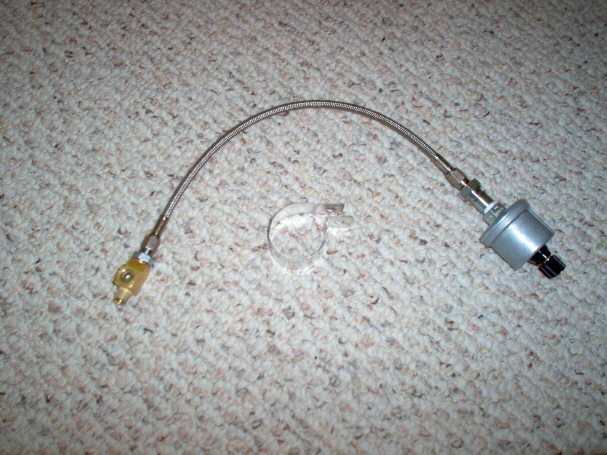

MXMARK
post Aug 29 2004, 12:47 PM
Posts: 205
Joined: 15-February 04
From: Riverside, Ca. the new (951)
Member No.: 1,656
New kit that I made. It uses a VDO adapter at the bottom. Mark
