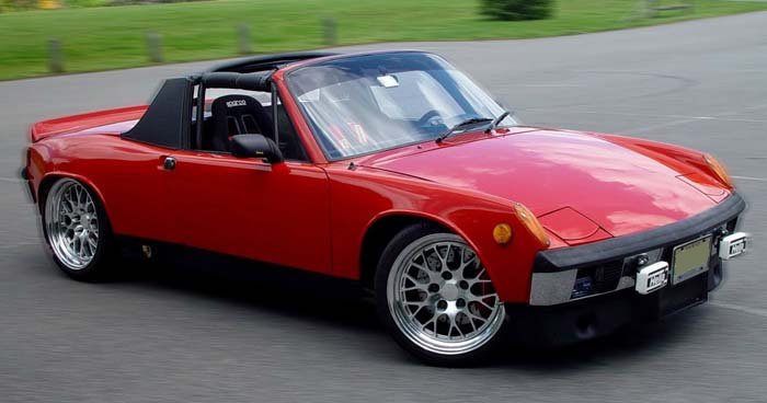

It's been done; there is a member on the Pelican 914 BBS who had a shop transplant a Boxster trans onto the 3.2 in his 914. He said it cost more than the original conversion, but that it shifted very well.

Seems like there was a very nice red 914 with a Boxster tranny.... I remember pics from a few years ago on here. Maybe the same one DD is referring to.

I found a couple pics of the red car. Gotta be a thread somewhere.

That car is goergeous, hell I can't even spell it right now!

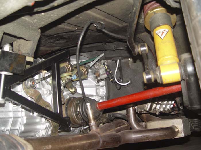

I just made my first tranny mount for the Boxster/Audi tranny. Walk in the park if you've got a welder.

There are a few companies that make adapter kits (including Kennedy) to mate an LS motor to the 996/986 S transaxle. Both transaxles are basically the same with the exception of mid/rear engine configurations. Ultima uses the 996 version in their kit cars and invert it for mid-engine use with better CV/axle geometry.
Both transaxles use G50 differentials and G50 style parts, but the main shaft/gears are an interference fit rather than splined which could be the limiting factor in the horsepower department.
I'll be pumping 400whp through the Boxster version (G86/20) and 360ft/lb with the Subaru engine. I'll find out exactly where the limit is soon enough I'm sure.
