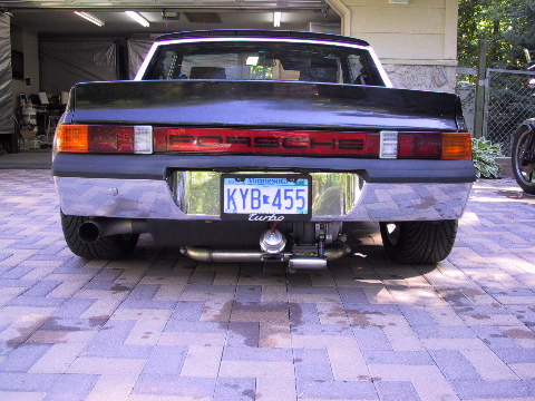

You cant miss me I drive the 914 Turbo Carrera.
