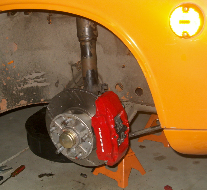

echocanyons
post Aug 29 2004, 10:55 PM
Posts: 2,112
Joined: 24-December 02
From: Bay Area, CA
Member No.: 7
pic
redshift
Bless the Hell out of you!
Posts: 10,926
Joined: 29-June 03
Member No.: 869
Looks like a good enough reason.

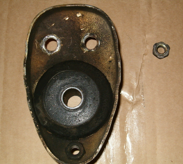

Has anyone encountered the bolts on the underside breaking free? It looks like they were just spot welded to the tops.
echocanyons
post Aug 29 2004, 11:22 PM
Posts: 2,112
From: Bay Area, CA
Member No.: 7
heres a pic
Brad Roberts
post Aug 29 2004, 11:25 PM
914 Freak!
Posts: 19,148
Joined: 23-December 02
Member No.: 8
This normally means the strut took a serious hit.
B
