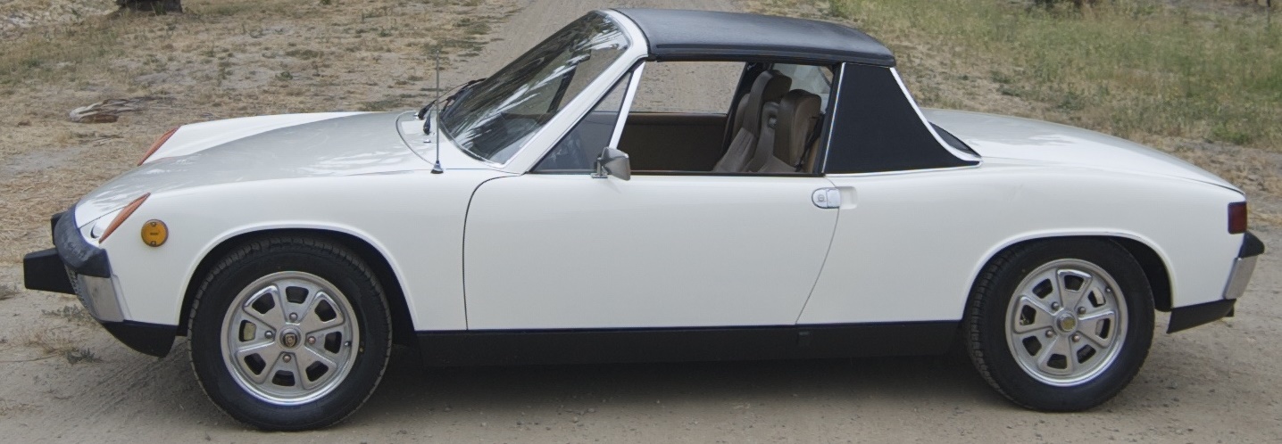

Here's what she looks like now-

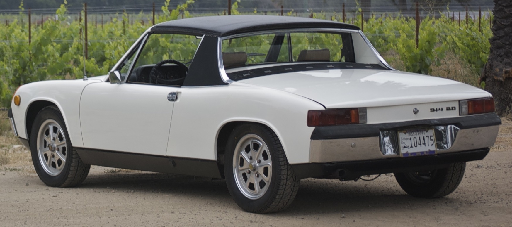

She's supposed to be white and I think I'll go back to the original color. Here's my inspiration:

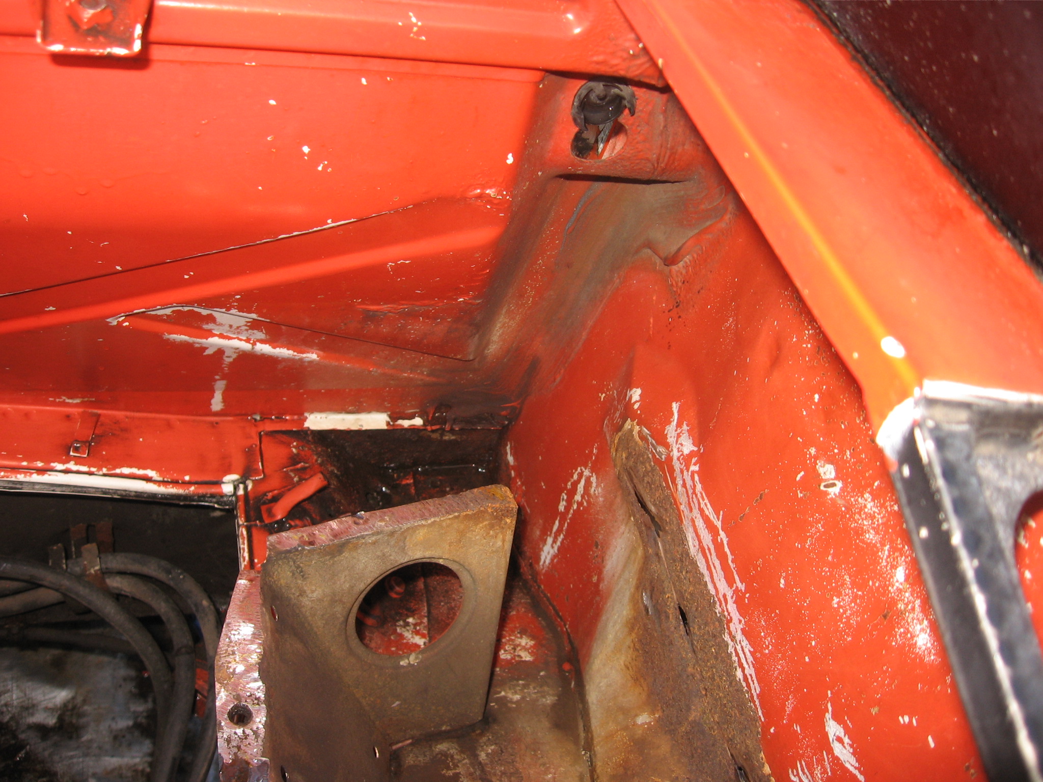

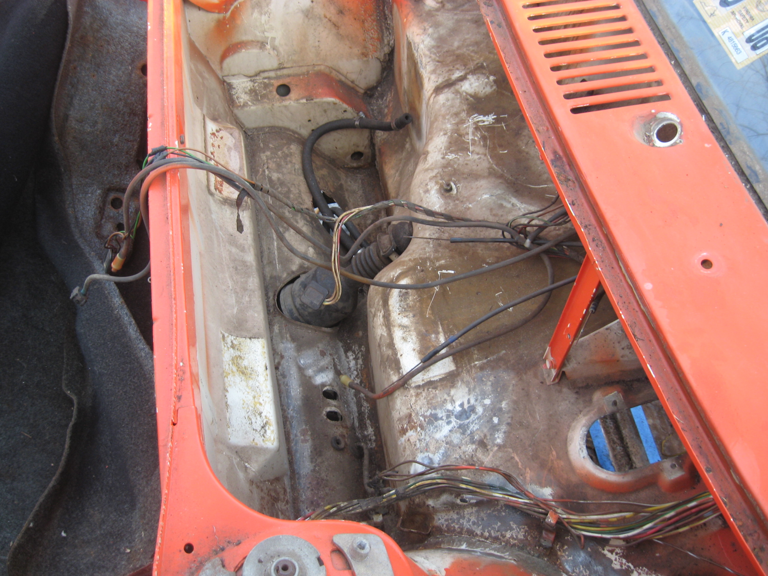

OU8AVW   Hell hole after clean up Other side.   Jan 31 2012, 08:33 PM

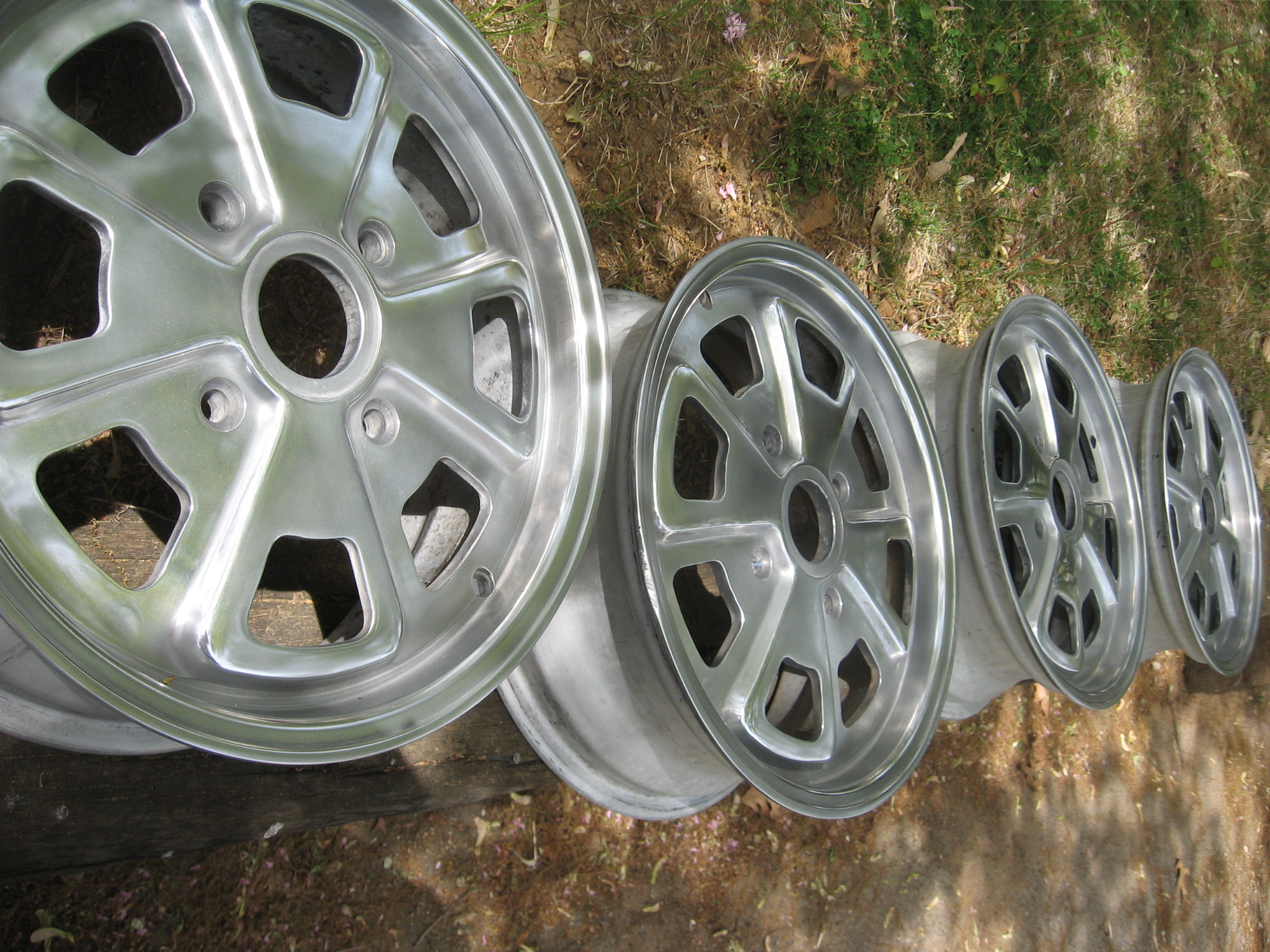

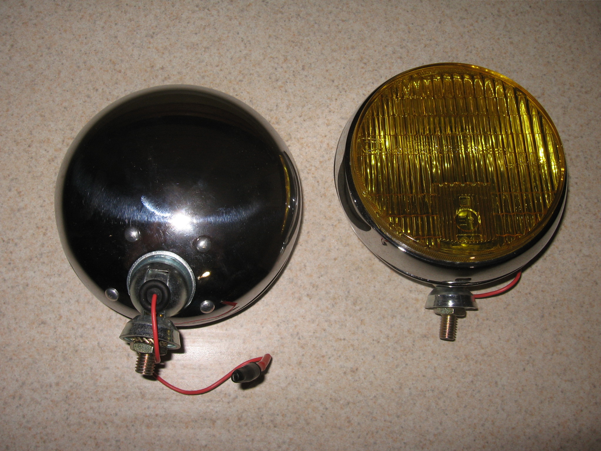

OU8AVW   Are these cool? They are new but really old. I was...   Jan 31 2012, 08:35 PM

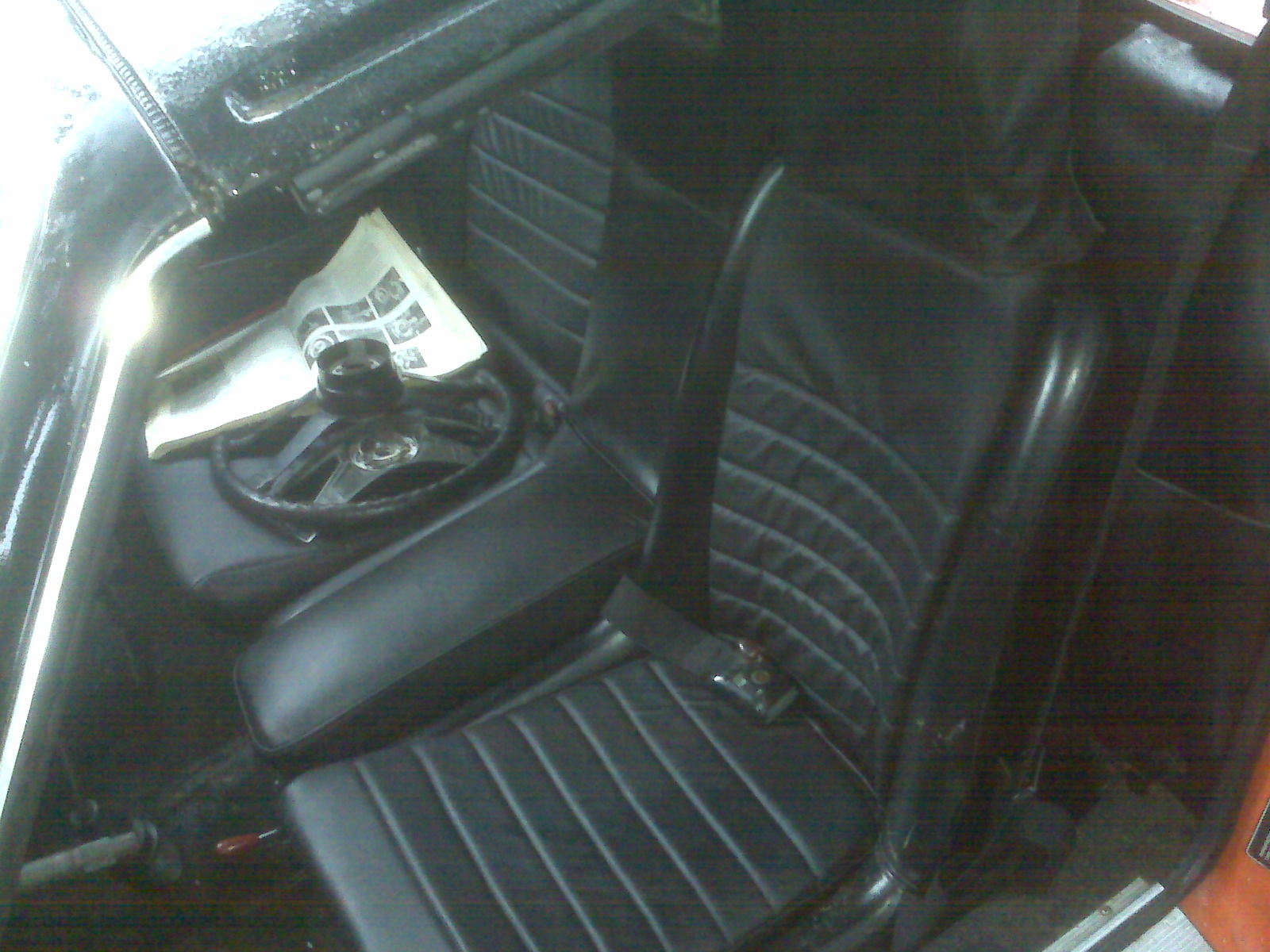

OU8AVW   Here's my seats. They came to me in leather bu...   Feb 11 2012, 12:53 PM

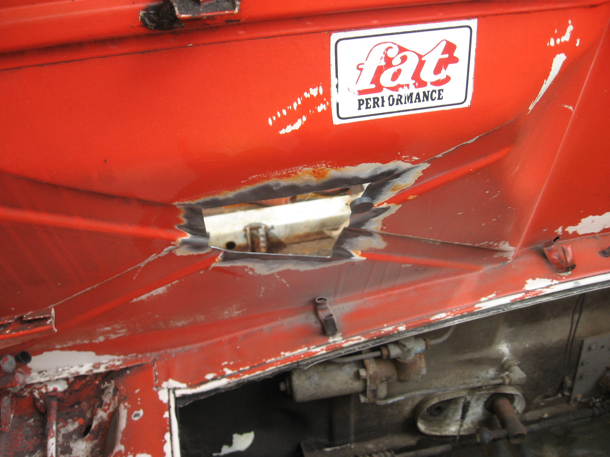

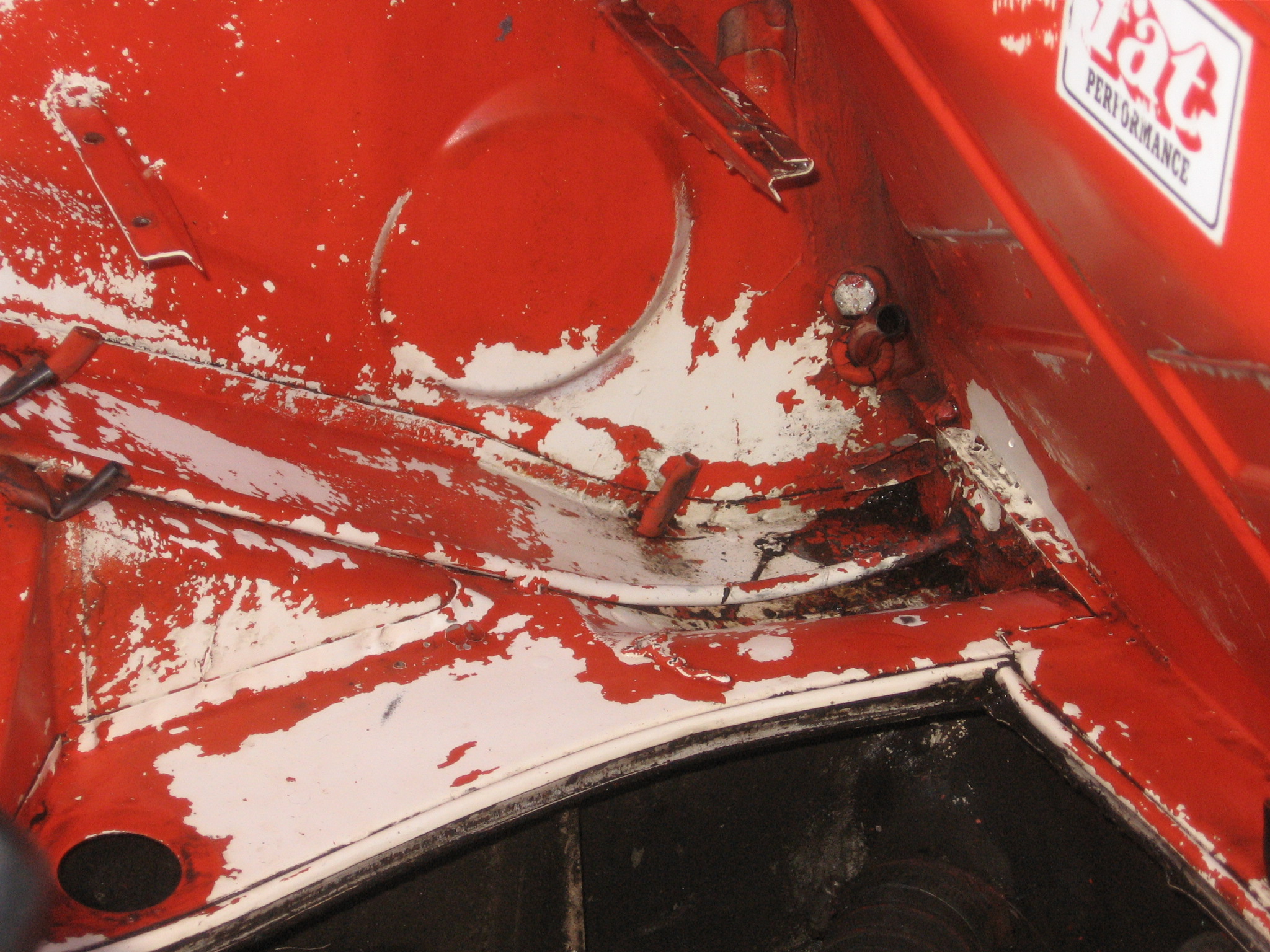

scotty b   Roll bar was coverd in straight libne scrathches f...   May 20 2012, 08:16 PM
scotty b   The plan on Mikes car was to repair the rear 1/4...   May 20 2012, 08:30 PM

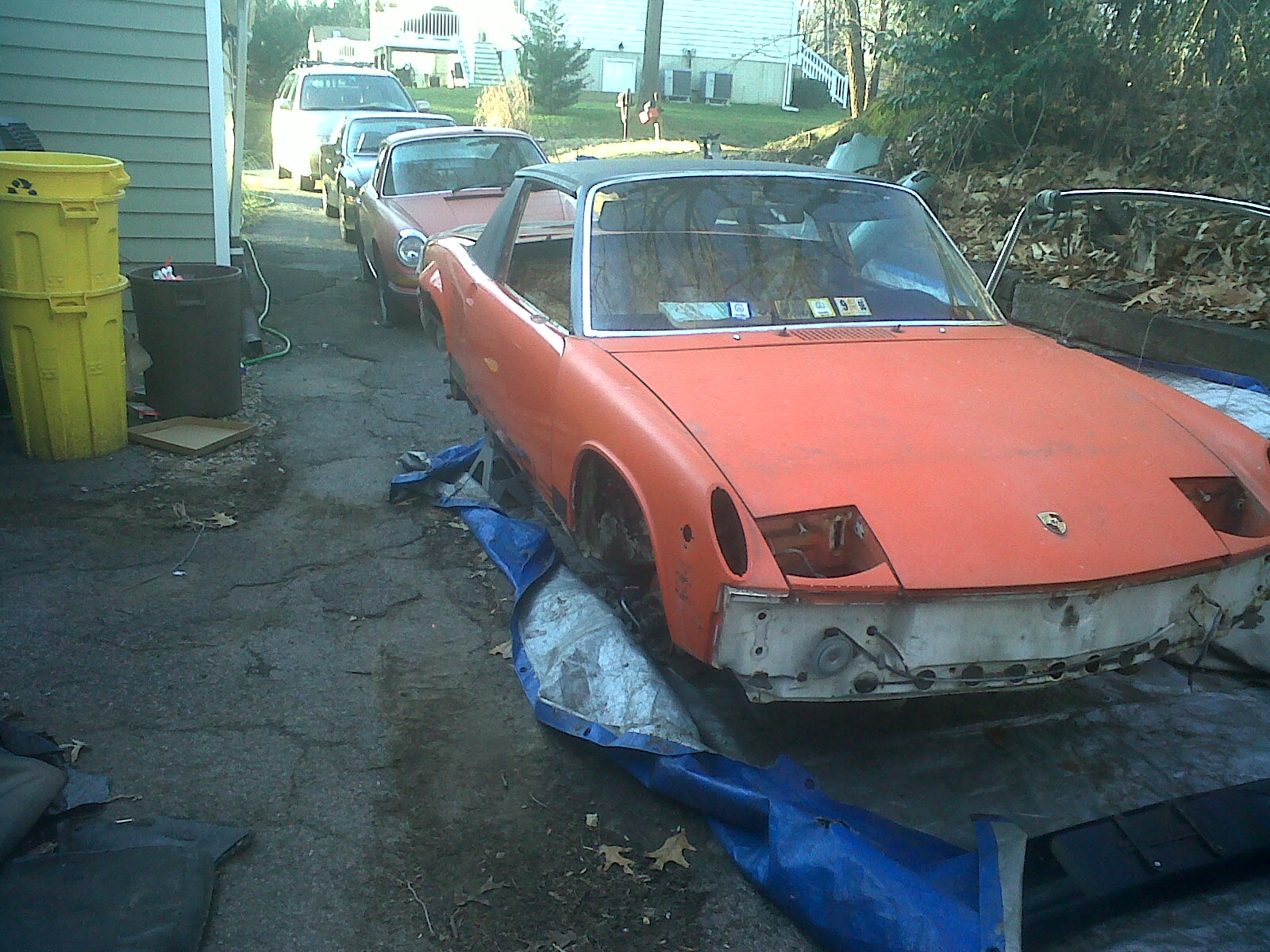

OU8AVW   A quick reference for what it looked like when I b...   Jun 24 2012, 09:11 AM
OU8AVW   Few More   Jun 24 2012, 09:14 AM

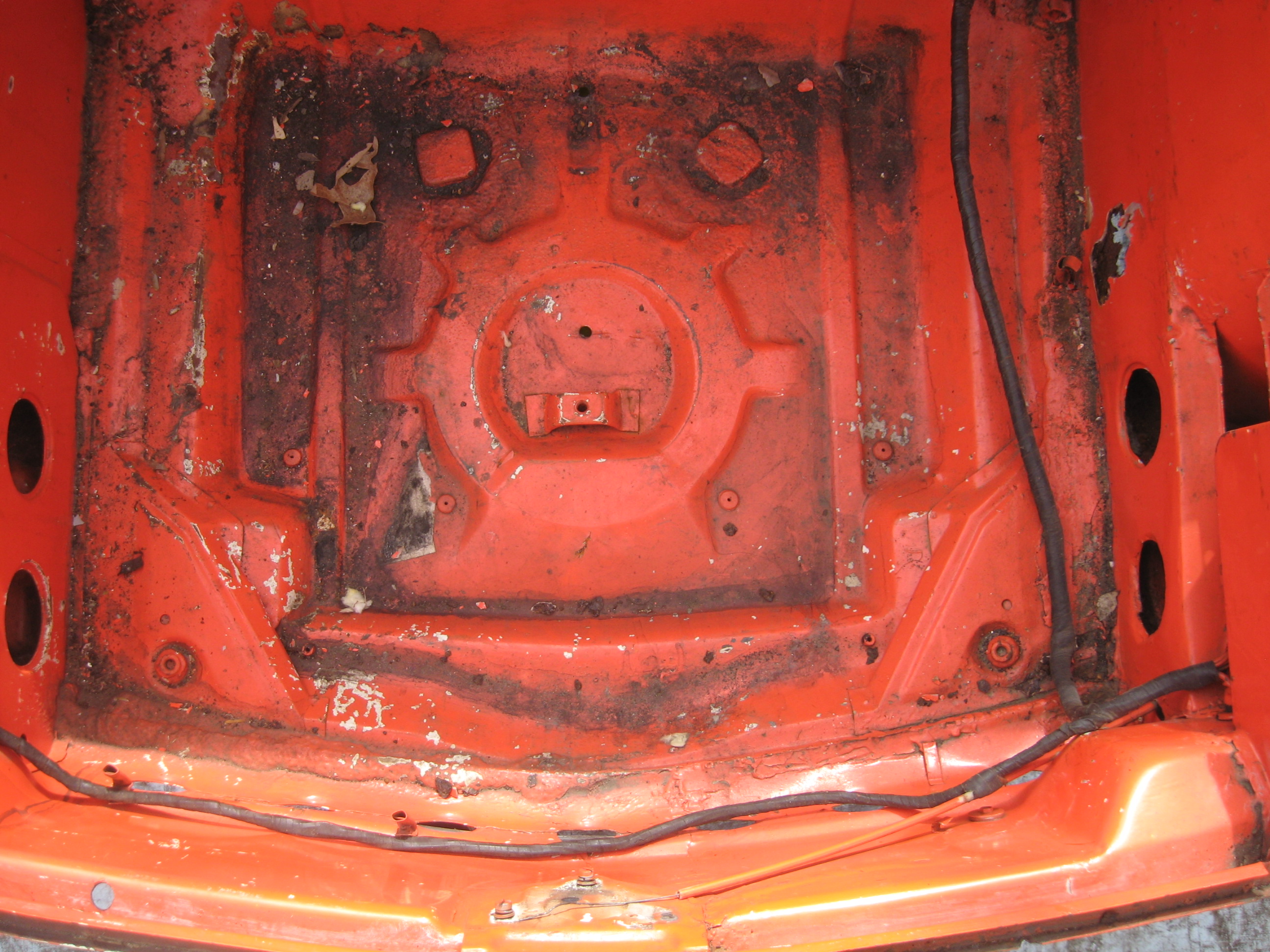

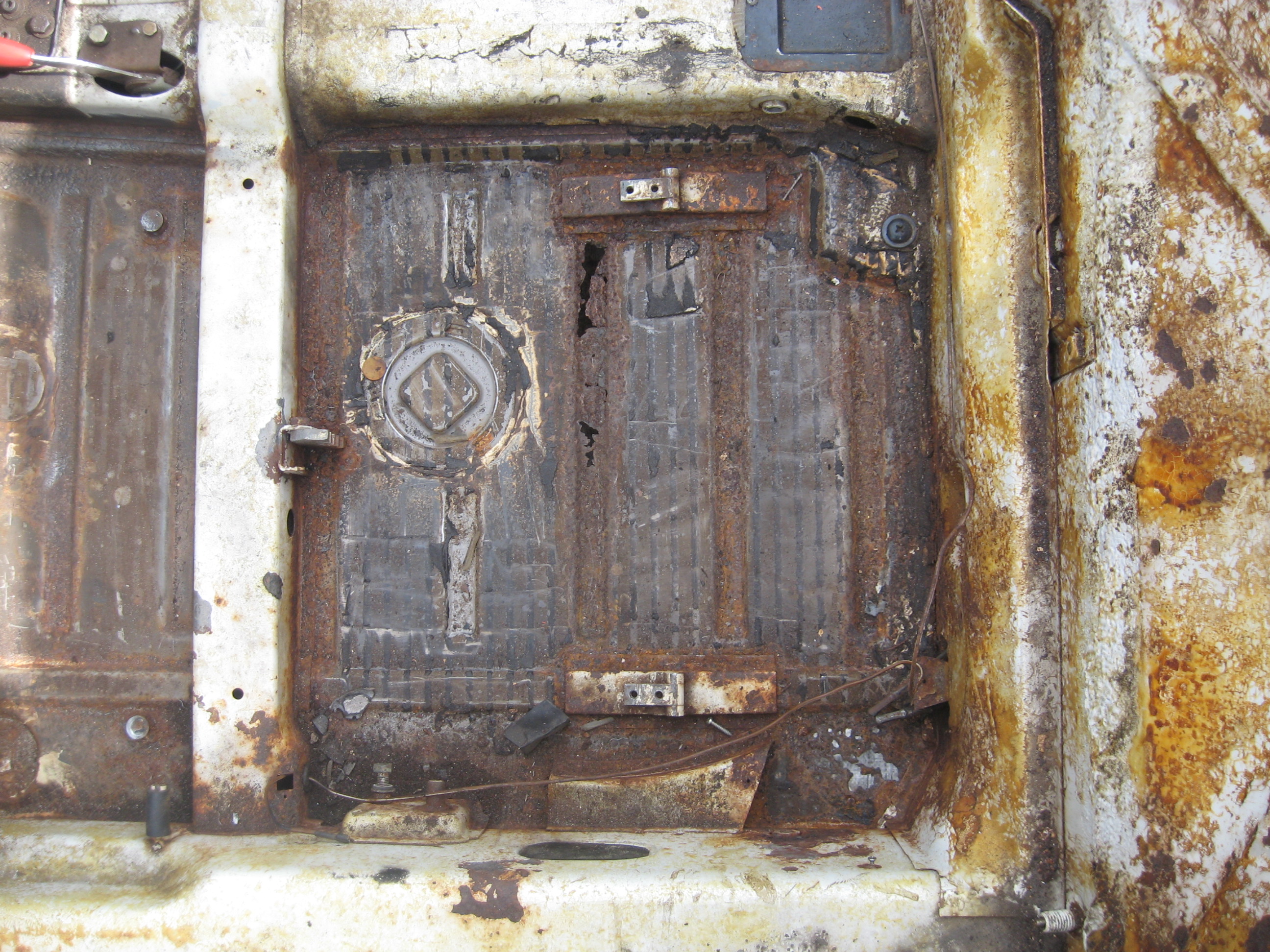

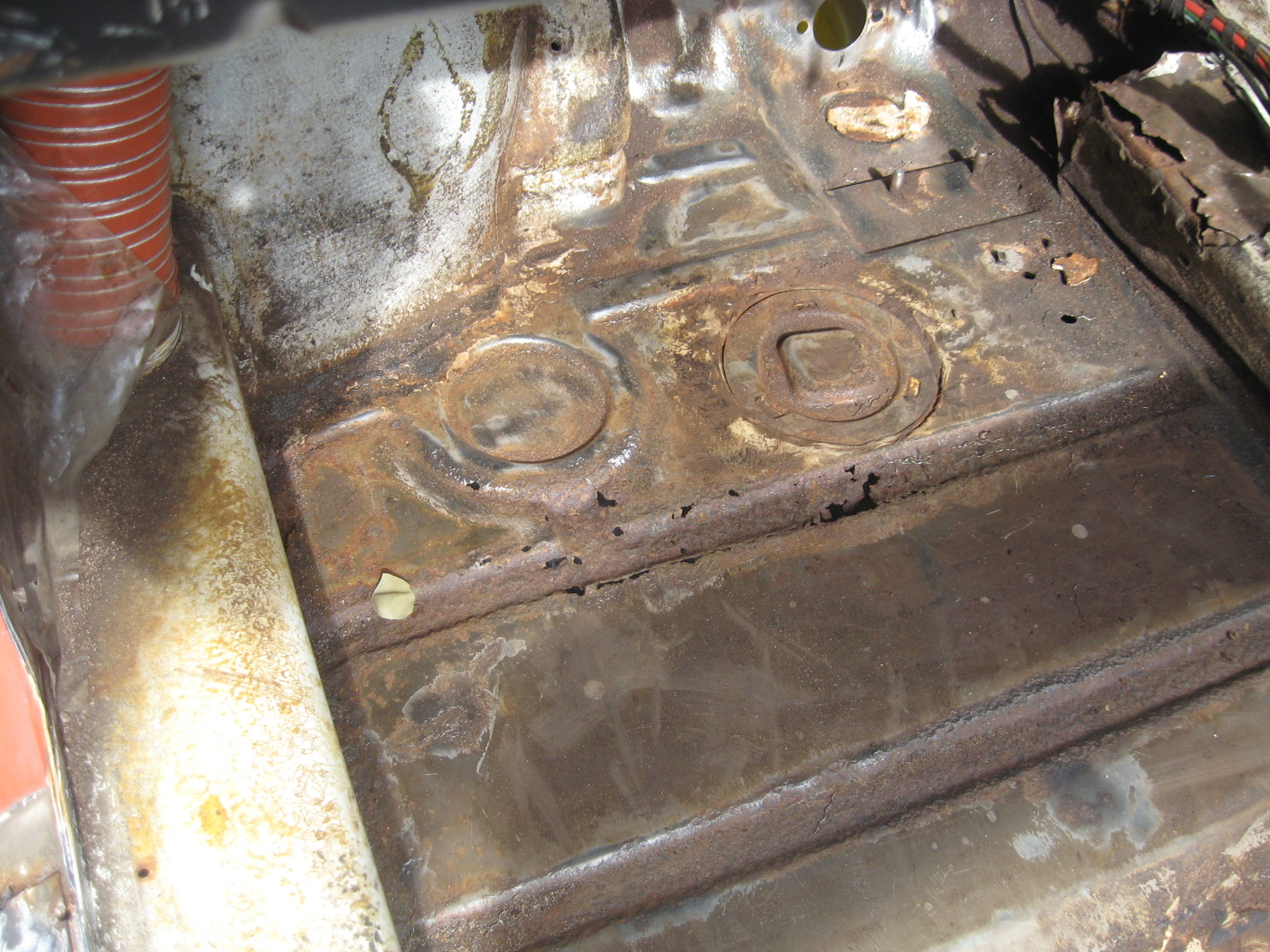

OU8AVW   I started to remove the rear trunk pan. Using an a...   Feb 11 2013, 09:03 AM
OU8AVW   So, I just got my replacement panel from Restorati...   Feb 11 2013, 09:12 AM
