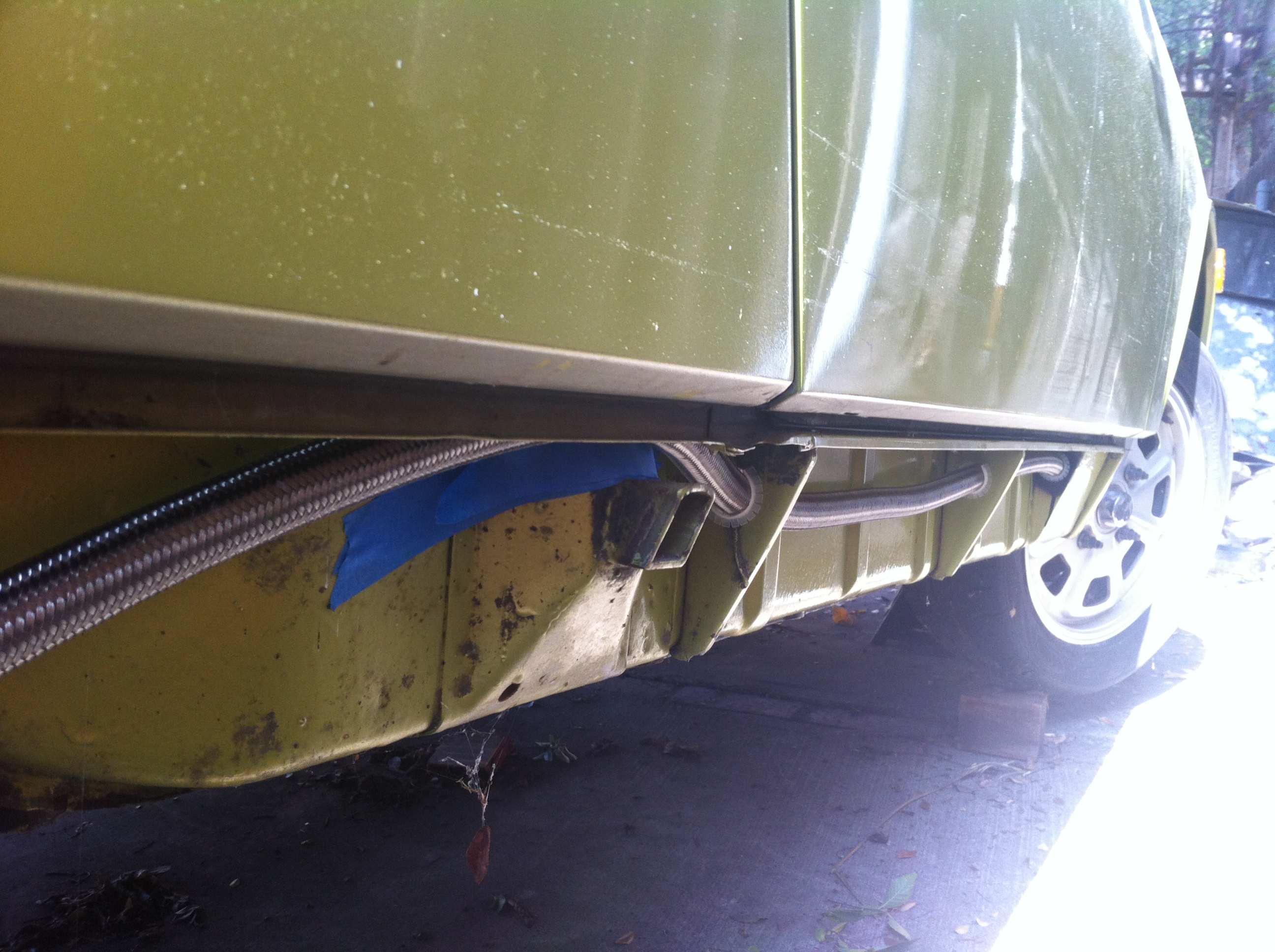

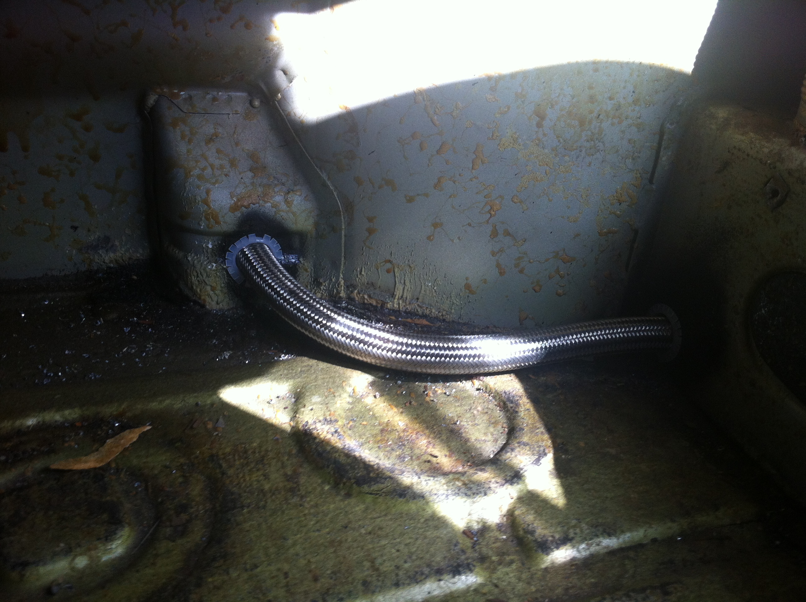

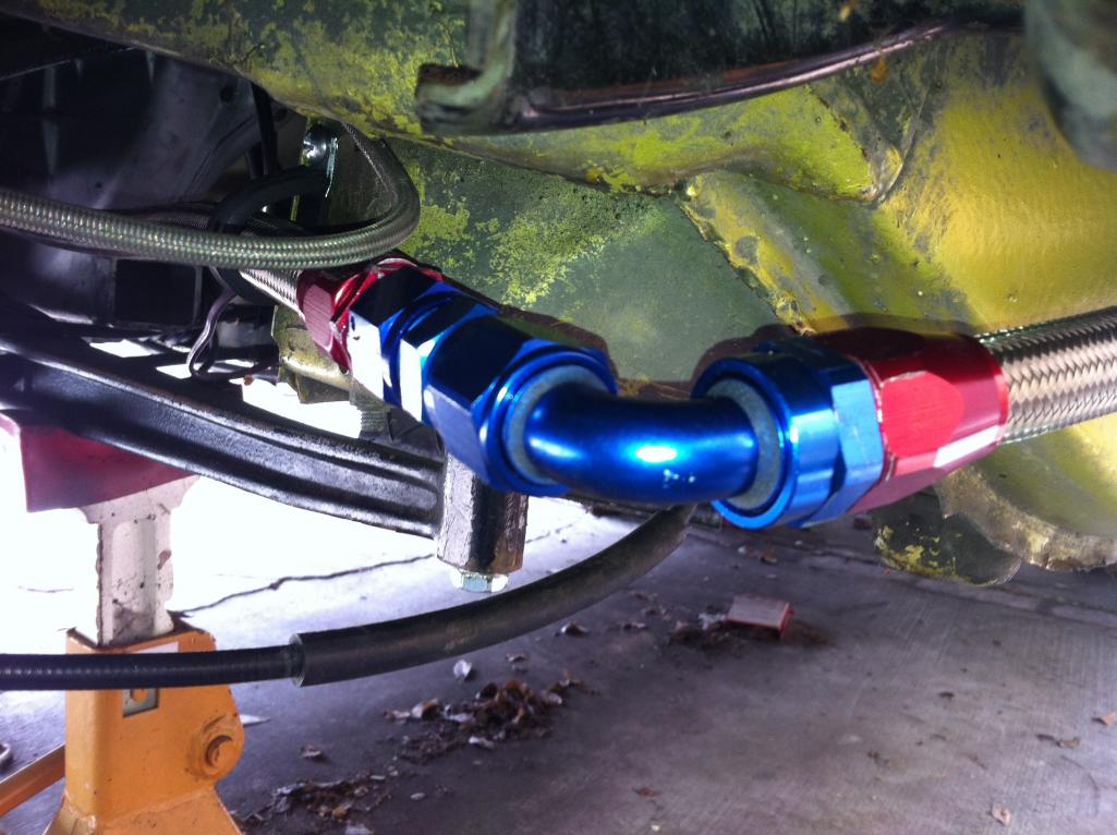

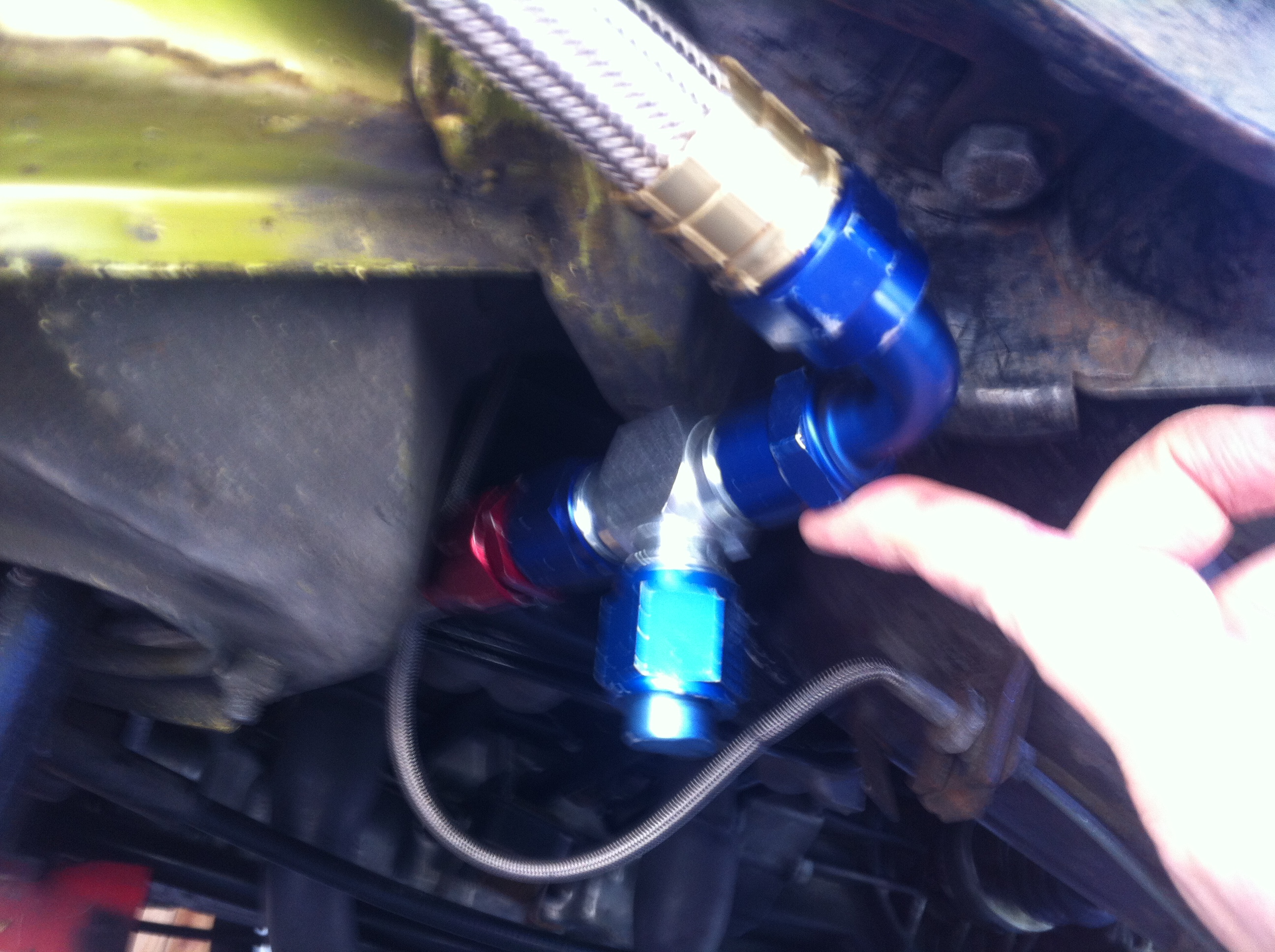

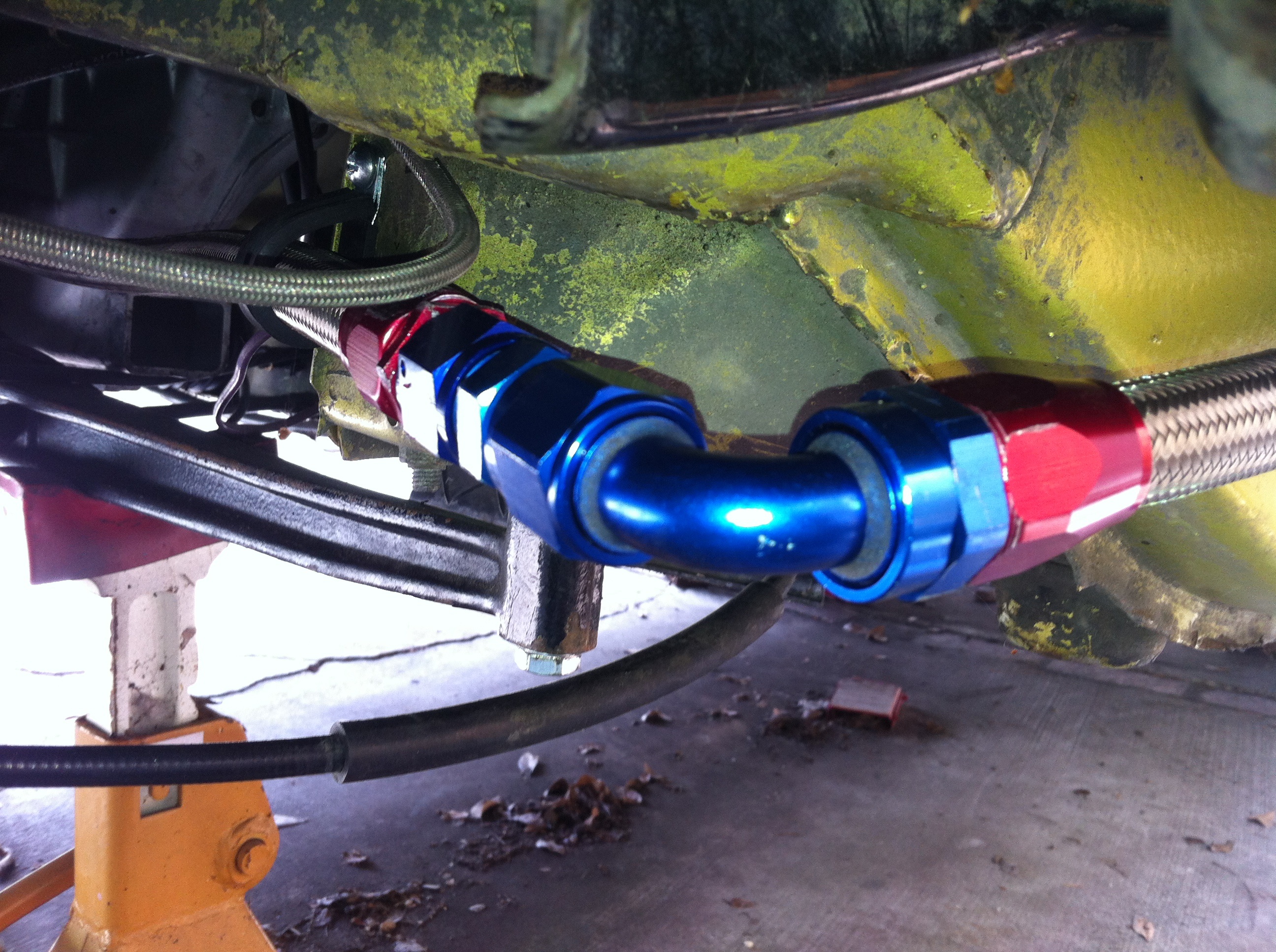

Some craptastic iPhone photos of the progress. Passenger side scavenge side oil line run and the holes are drilled for the drivers side return. I still have to actually hook the lines up and clean up the install a bit.
mrbubblehead
post Dec 11 2012, 07:15 PM
Post #45
Twodollardoug
Posts: 1,155
Joined: 17-December 10
From: calimesa ca.
Member No.: 12,492
looks good. what size is that? -8, -10?
yeahmag
post Dec 11 2012, 07:31 PM
Post #46
Posts: 2,468
Joined: 18-April 05
From: Pasadena, CA
Member No.: 3,946
-10 on the scavenge side. -12 for most of the run, necking down to -10 at the very end for the return.

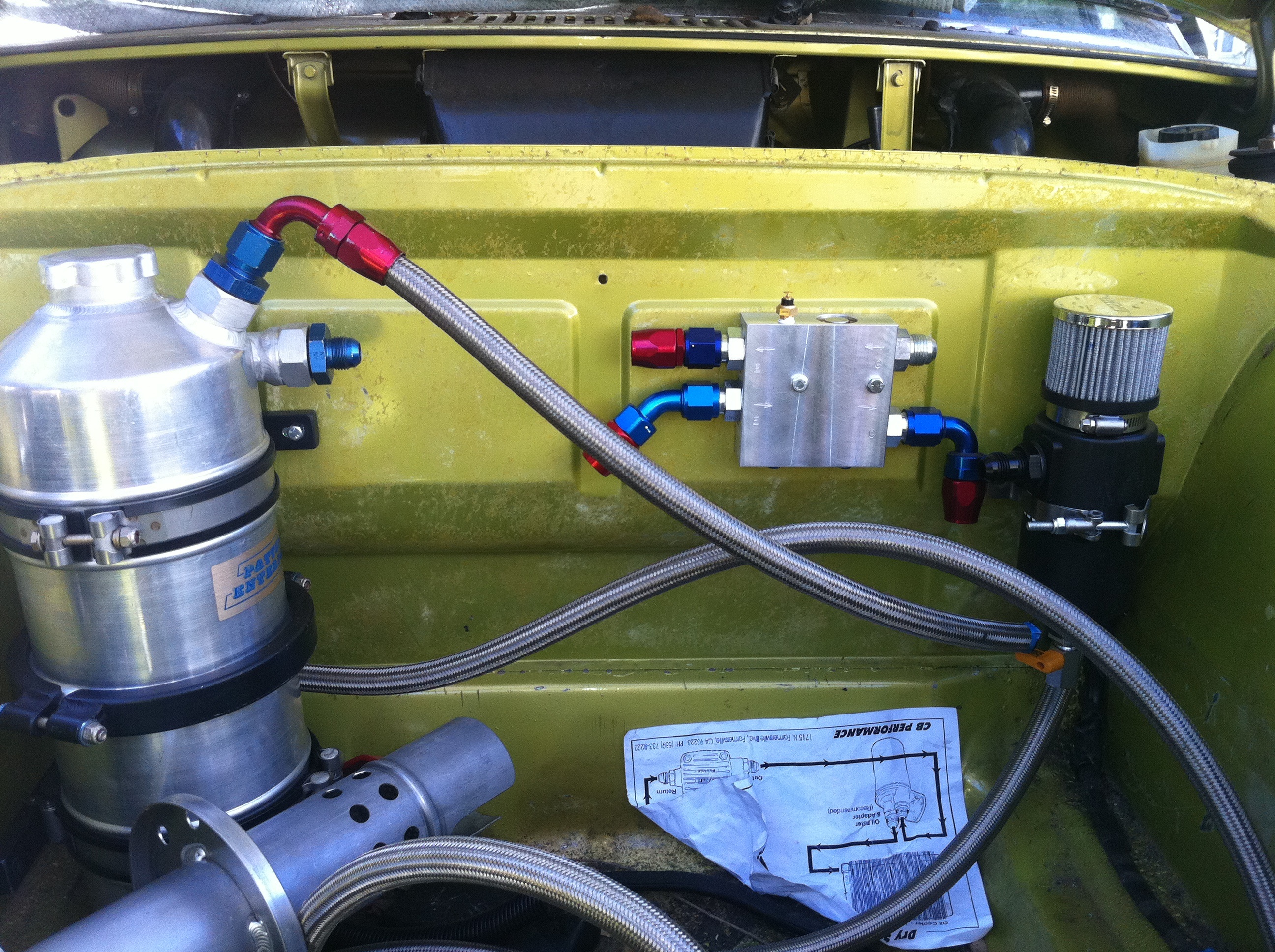

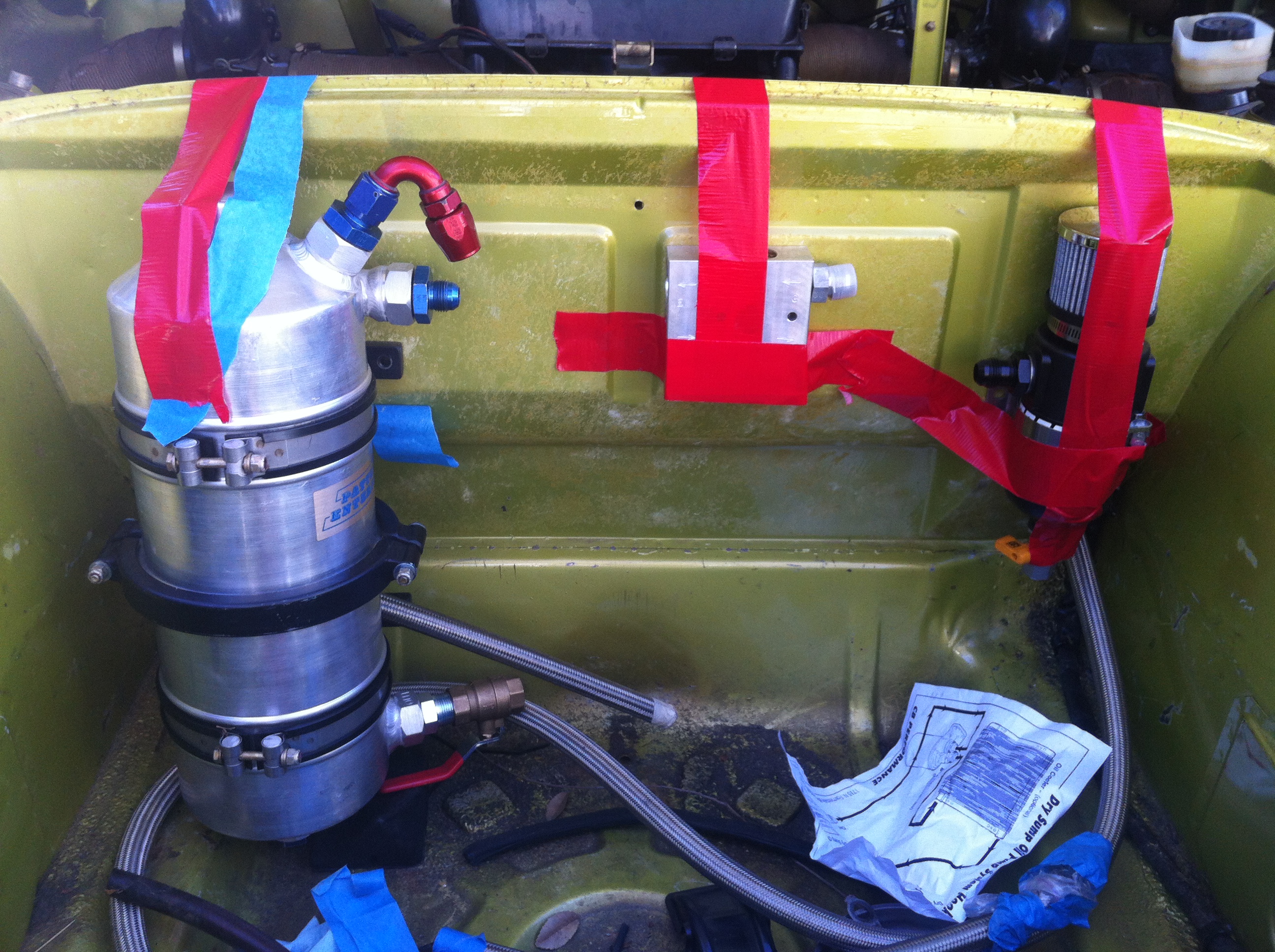

Here are some pic's of my mock up of the tank, thermostat, and catch can:
...along with the return T for changing the oil:

nice yeamag. i did the same thing with the T fitting it makes oil changes a snap. I'm using the same thermostat also. i chose that one because of all the ports for the sensors. cool project....
btw my plug on my T fitting is male, so i drilled a 1/16 hole in it and safety wire that sucker. you should think about doing the same some how. that would be a shame to lose that cap and roast your new engine....

Good idea! Not sure it has any higher probability of coming undone than ant other fitting, but no need to tempt fate.

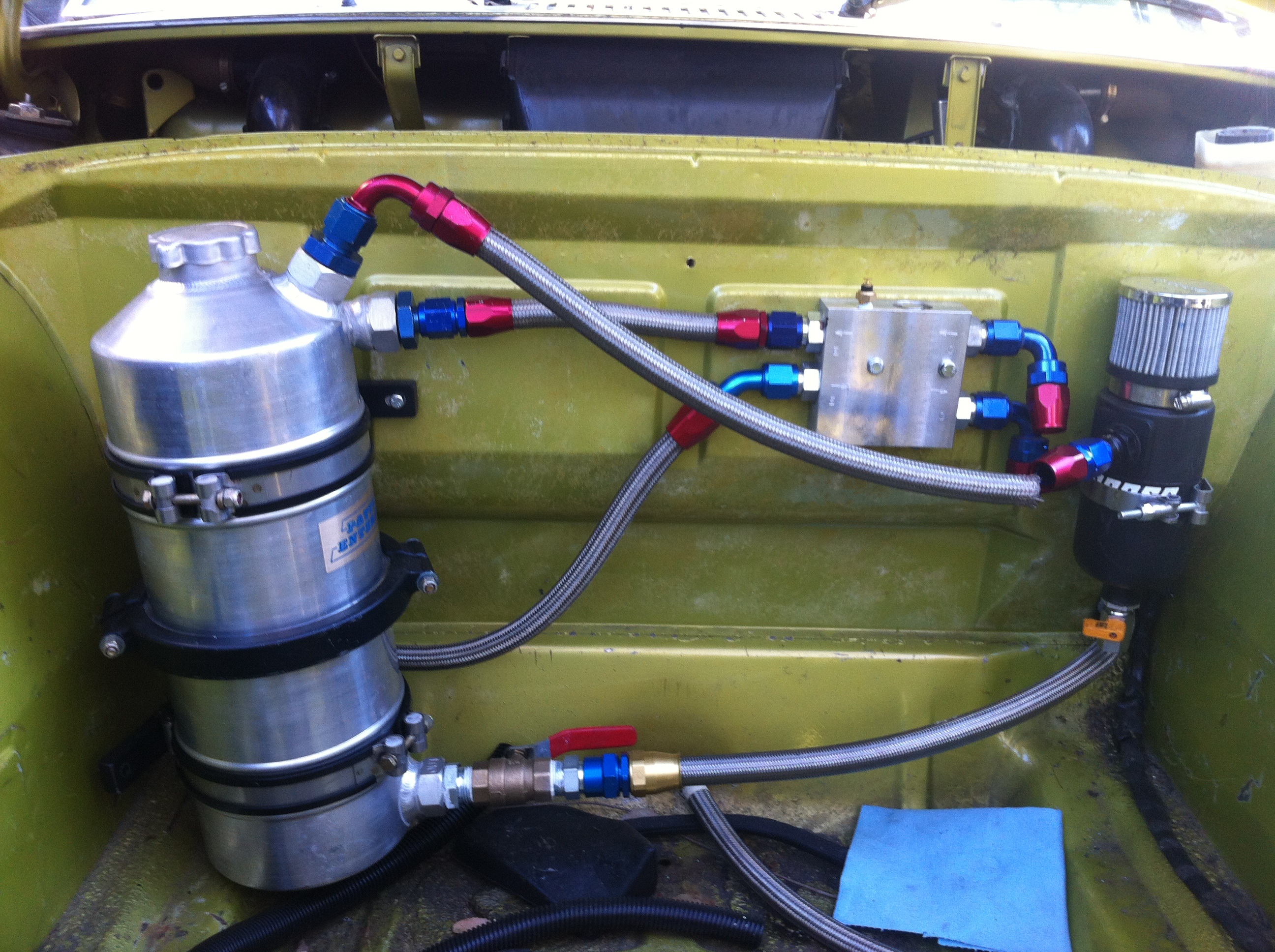

And passenger side is finally done.

looks good yeamag. those an fittings sure get expensive after you buy a couple dozen of them. right?

...and yet more fittings to be ordered.

that looks awesome bro. im glad summit has the return policy that they do.... its hard to anticipate every single bend and what degree you need. i end up over ordering and then send back what i dont use. cuz you never know if the bend you need is gonna work until you have it in your hand.....
