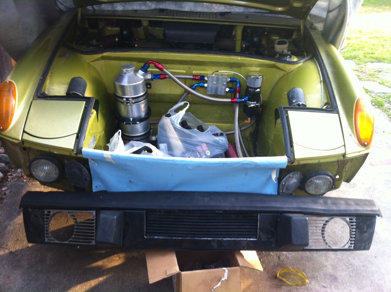

...and if anybody has any words of wisdom how to prime all of this I'll take it. Right now I'm just planning on putting 3 quarts in the engine and filling the tank 3/4 of the way and cranking for pressure. After that topping the tank up to 1/2-3/4 and cranking for pressure again. One final top off to make sure i'm above 1/2 way and firing the motor.
Before I drive it I'll probably pop a fitting off the oil cooler and fill it... It's huge.

good luck bro. sounds like a good plan. the only thing i can think of is to fill the remote oil filter and pull the spark plugs. but im sure you already new that...

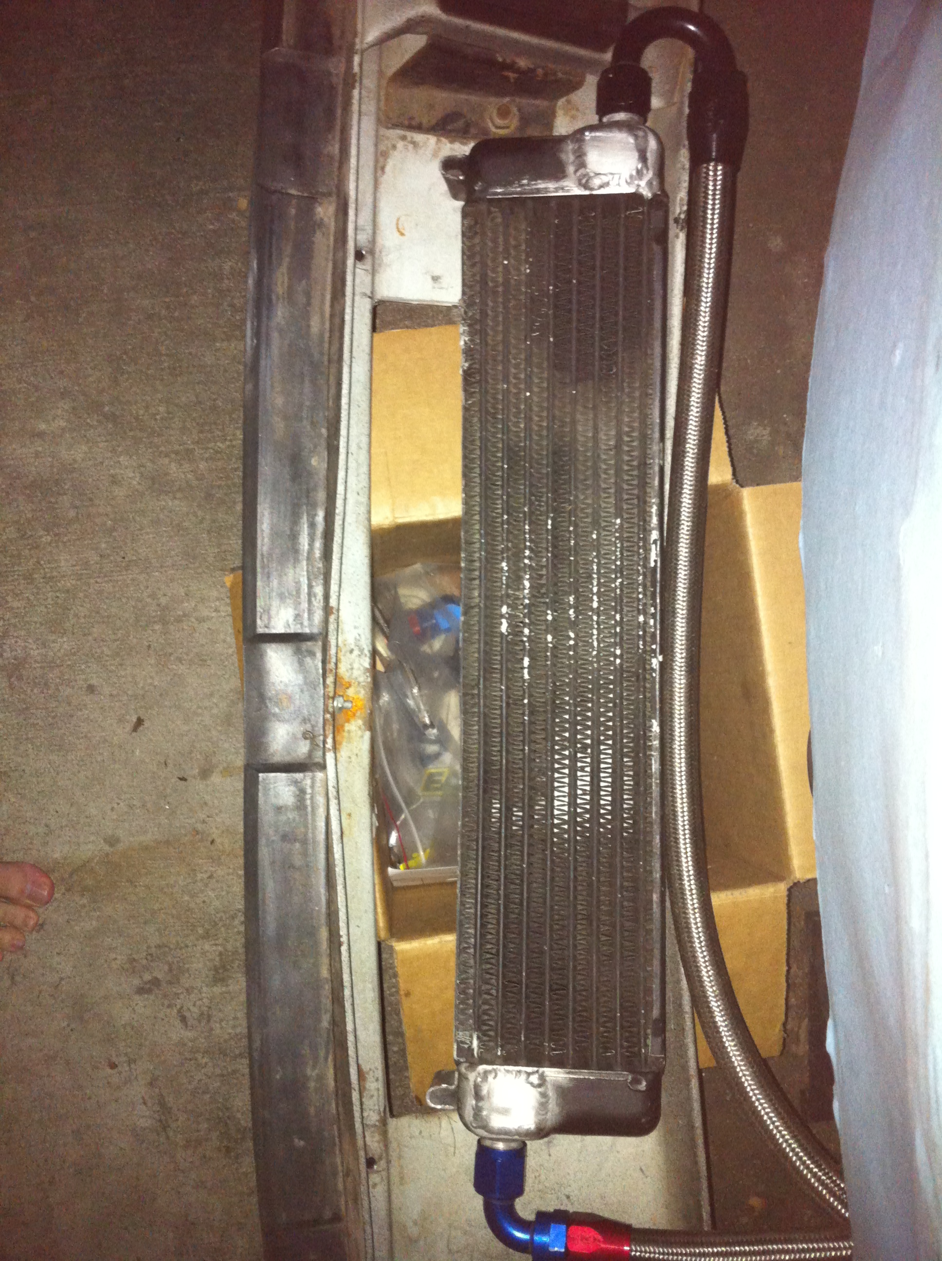

I like your set up a lot, looks really good. are you cutting out anything behind the cooler?? or is the exit of hot air just right back into atmospheric area between bumper and front clip??
yeahmag
post Mar 5 2013, 05:46 PM
Post #73
Posts: 2,468
Joined: 18-April 05
From: Pasadena, CA
Member No.: 3,946
Yes. No cutting of the body.

Very cool, i saw you had a CB dry sump pump, are the aftermarket pumps similar for doing a dry sump set up compared to just adding a front mounted cooler?
