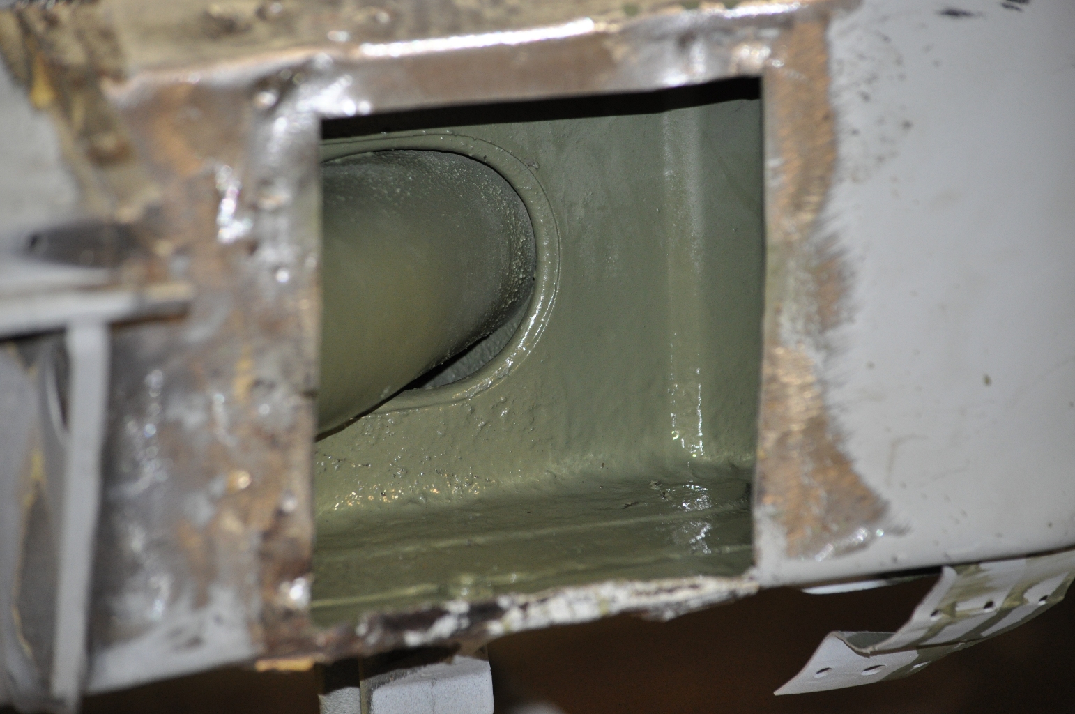

post Feb 8 2012, 11:54 PM
Its got to be Yellow!!!
Posts: 2,432
Joined: 29-August 09
From: Orange
Member No.: 10,742
I used the repair opening to clean out and spray inside the longs, first pic is dry and second one of the long is still wet
