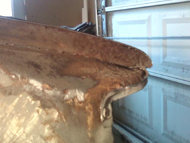

So once again I find myself going where the sun don't shine.
Eventually, I plan to post the receipt from where the body shop charged the interim owner for "replacing quarter panel"...but that's fun for another day.
Here's my question: Am I correct that, from the factory, the little void in the point at the rear of the quarter panel (above the tail light) is left empty--or full of spray foam--and that there's a very large glob of seam sealer supposedly preventing tire-slung moisture from finding the foam?
I had to open mine up all the way and I'm toying with actually welding in a custom baffle in front of that pointed tip so that I could seal it up tight from the front side of the baffle. I would do this as part of the process when I fit in the new fender section.
What I want to do is make sure moisture can't get into that rear point and fester.
Anybody who's reworked the rearmost part of the fender/light socket, what have you done???

I have had very good results with leaving that area open instead of putting foam/sealer back in.

I'm of two minds here when it comes to that pocket. I could agree with sir Andy if I lived on the gold coast unless you drive near the beach and salt water. That is one of the most diffecult areas to clean out and derust without cutting it open like yours. The trouble is over time the calk will release and moisture gets between the calk and the panel. I think todays urothane seam sealers are far superior to what Porsche used in the early 70's. I would take all the proper steps to etch, seal and paint the inside and then reseal the pocket with modern seam sealer. But that's just me.

I thought about sealing/painting it up as best as I can and also leaving it open to the air. It seems to be a bit down-hill, though, and I thought water might settle in there. And then I thought a drain hole or two might not be a bad idea.

The Ospho cured over night so the rust looks "halted" now. I can get some primer on it now but I'll be welding all around the general vicinity when the fender skin goes on--not good for sealer. Are you suggesting making the repairs, maybe some more Ospho, spraying primer/paint into the point, and then packing it back full with sealer?

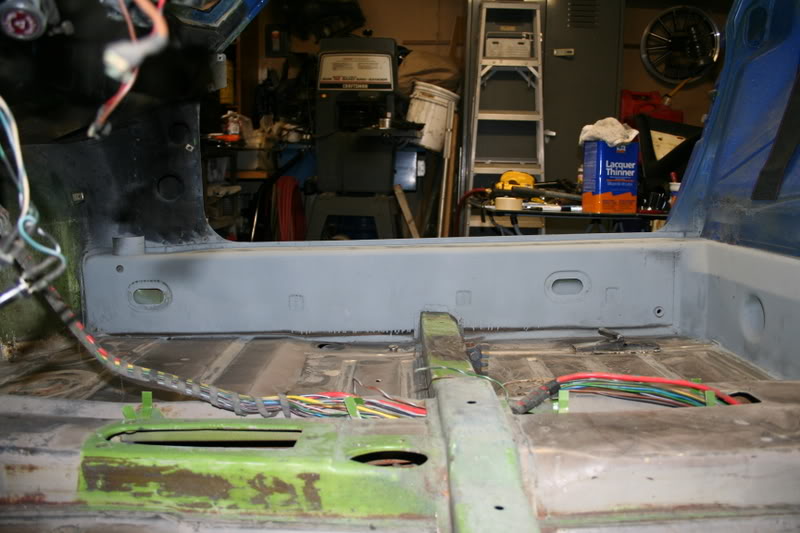

Hey Andy, in your last pic, did you spray the Eastwood ('green stuff') into the longs and then cut them open to do some patch work afterwards? ... and was it wet or dry when you took the pic ?
burton73
Feb 8 2012, 06:35 PM
I put the Eastwood stuff into the longs through the seat belt holes with my 914-6 on the rotisserie and painted the shit out of it and turned it. You can work it all around till it comes out of the holes in the bottom of the pan. I think I have gotten the longs sprayed well. I had no rust showing before and my jack posts looked great so this should just add extra protection.

Feb 8 2012, 11:54 PM
I used the repair opening to clean out and spray inside the longs, first pic is dry and second one of the long is still wet

I recently bought one of those inspection cameras from HF (the pricer one with the camera head small enough to insert into a spark plug hole.) Should be easy enough to see inside the tunnel, but I'll need to find a good location to insert the camera head to take a peek inside longs. I'm almost certain that I'll need to spray 'something' in both places.
Do these oval openings allow full access into the long?

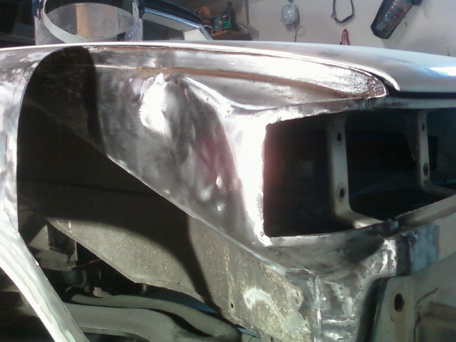

Today, I cleaned up a nose section which will eventually be a donor for at least one headlight box.
I used a cheapy Walmart spray bottle to get the Ospho into the recesses where you can't quite reach below the headlights. Then, I rocked the section around to make sure the excess rolled into the varies crannies.
Wear a good respirator/filter if you go misting this stuff. It's not good for you to inhale.
For now, I'll probably just squirt some primer or paint over the converted rust which will keep it stabilized until I need to start working on this section.
