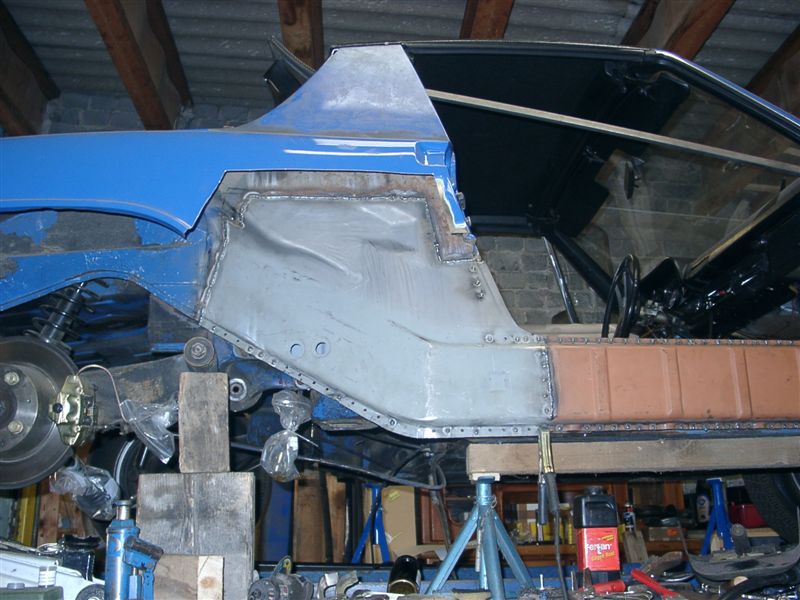

Hi together,

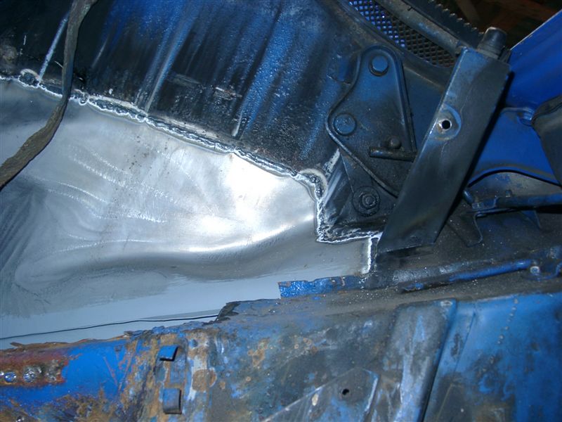

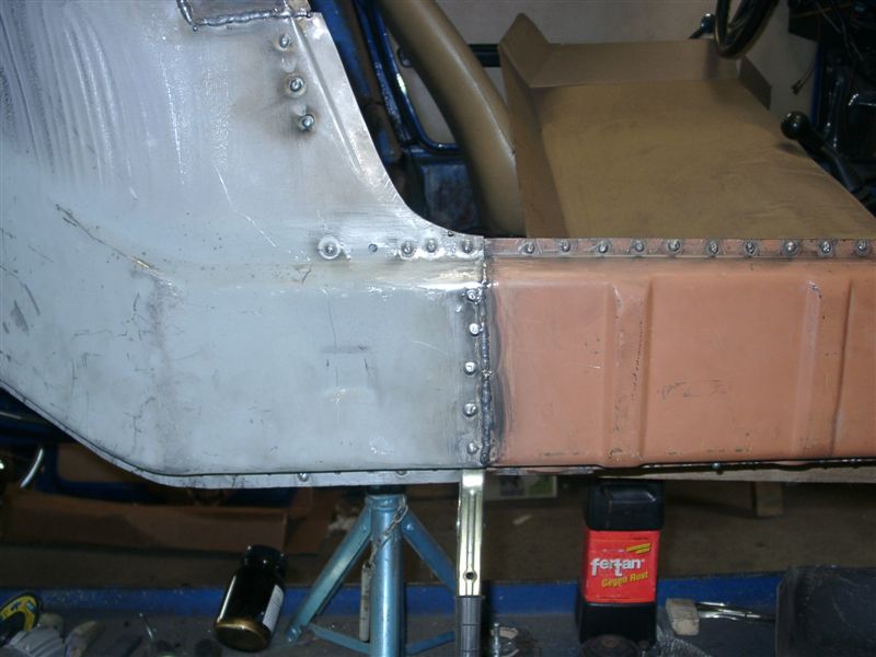

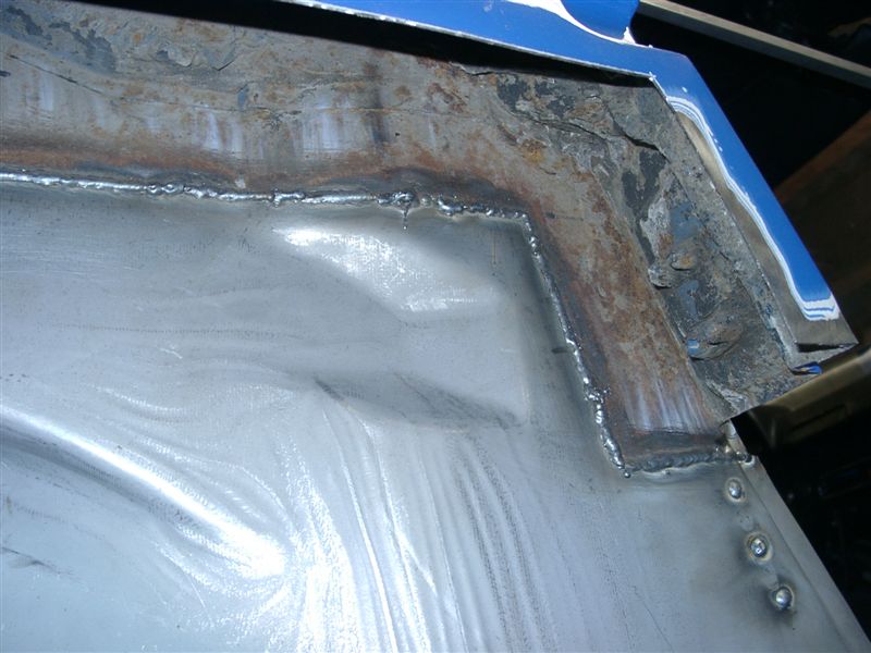

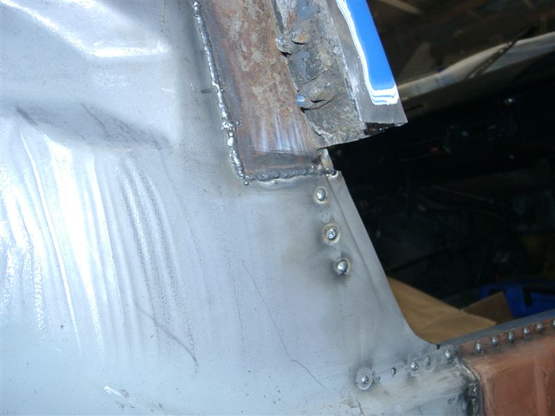

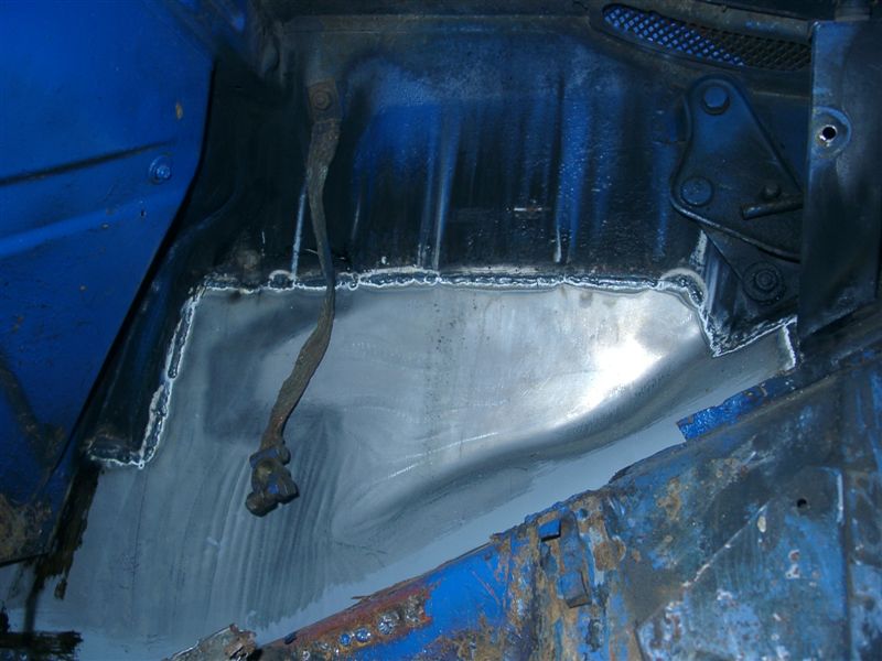

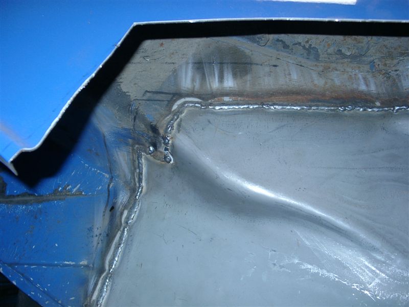

here are some update pic´s.
Welded in the repair panel from AA.
michelko
post Oct 9 2004, 05:12 AM
Post #129
Posts: 867
Joined: 30-November 03
From: Germany, Lambsheim
Member No.: 1,404
was a straight forward work.
I love welding (IMG:style_emoticons/default/wub.gif) (IMG:style_emoticons/default/welder.gif)

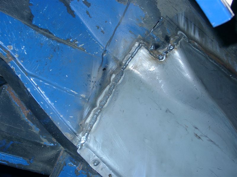

michelko
post Oct 9 2004, 05:13 AM
Post #130
Posts: 867
Member No.: 1,404
nother one

Member No.: 1,404
#3

Member No.: 1,404
back side
michelko
post Oct 9 2004, 05:15 AM
Post #133
Posts: 867
Member No.: 1,404
one or two weeks, and it will stand on his own feet again.

Member No.: 1,404

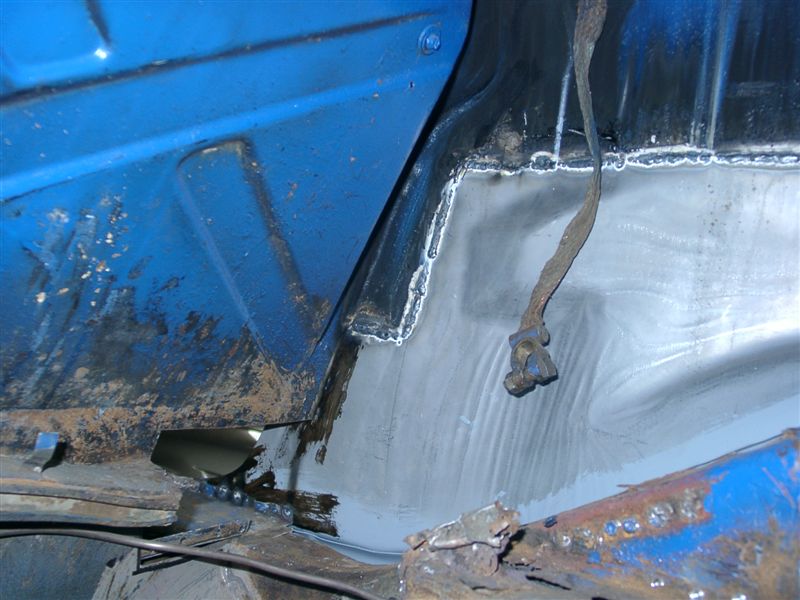

view from inside of the engine bay
michelko
post Oct 9 2004, 05:17 AM
Post #135

Member No.: 1,404
nother one
michelko
post Oct 9 2004, 05:18 AM
Post #136
Posts: 867
Member No.: 1,404
the welding burned nicely through. So i think this should be strong like new. (hope so)

Jeroen
post Oct 9 2004, 05:30 AM
Post #137
Posts: 7,887
Joined: 24-December 02
From: The Netherlands
Member No.: 3
Region Association: Europe
Again... nice job!
Those welds look very nice
