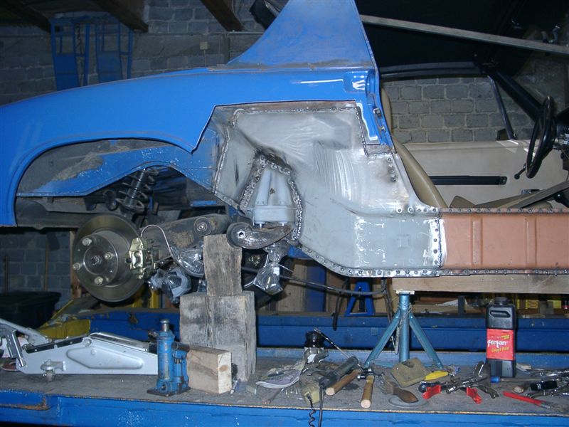

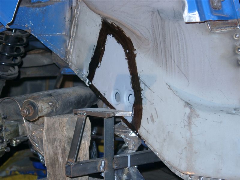

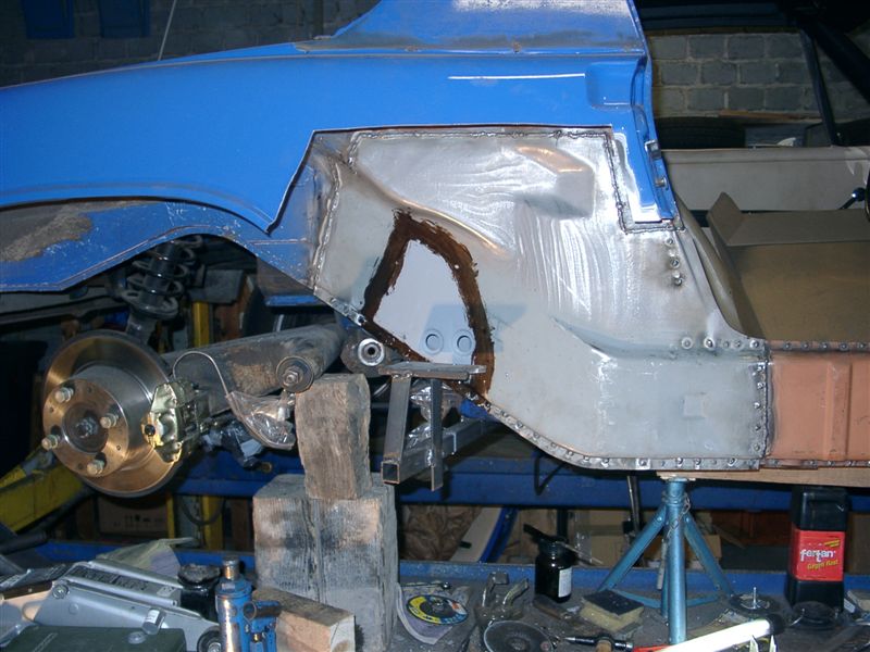

today i welded in the outer suspension console. I made a brace to match the original place. Hope it worked. An allignment Job will show it (IMG:style_emoticons/default/wink.gif)
first pic shows the primed area. Dark colour is weldeable primer.
michelko

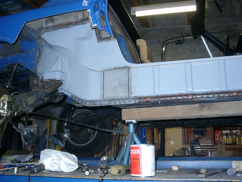

brace

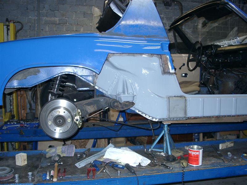

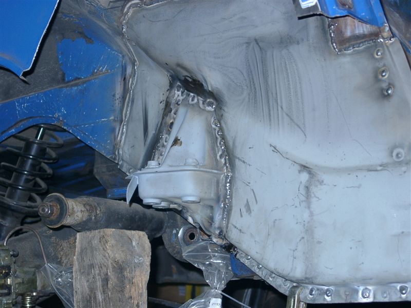

console in place

with mounting hardware

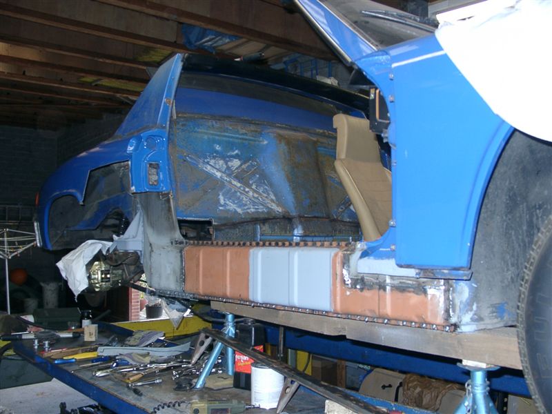

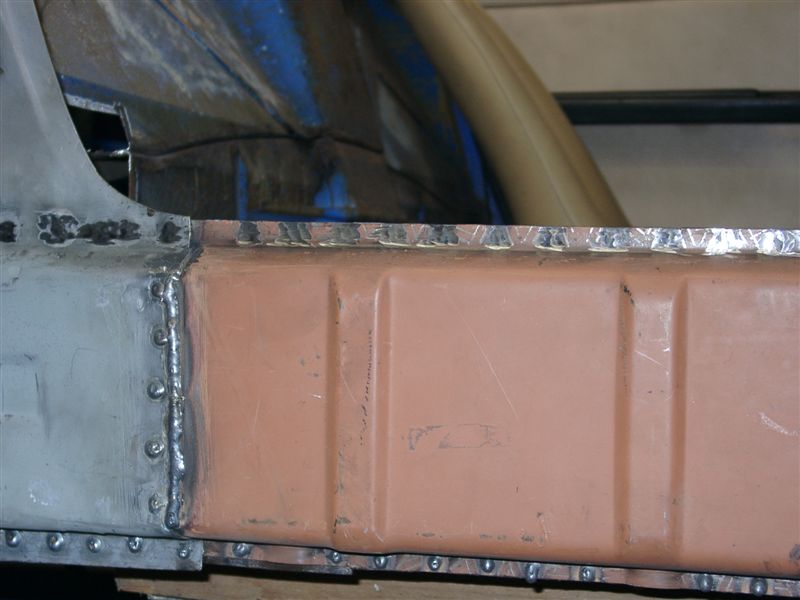

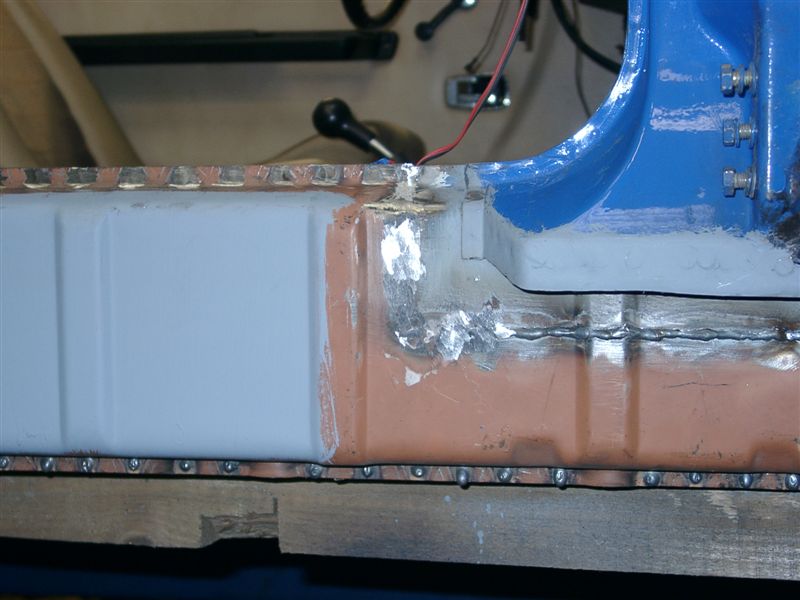

test fitting of the new door sill
michelko
post Oct 12 2004, 02:04 PM
Post #146
Posts: 867
Joined: 30-November 03
From: Germany, Lambsheim
Member No.: 1,404
nother view.
this piece fits perfect. Don´t know the manufaturer. Got them from e-bay.

Michelko, very nice work. I am jealous. (IMG:style_emoticons/default/smile.gif)
Do you know who made the outer suspension console or is that one of the pieces that you bought off of ebay? I need one and I did not know they were available new. After seeing your posted pictures I checked on a few websites but I could only find the inner suspension console ear.

The "outer" console or bracket if you've gone through the thread you'll see what Michelko has done. He took off the old one sandblsted it, primed it 'n' WHALA new piece!!! So Michelko, did you just regular (grey) prime the various pieces? Then the black stuff that looks like POR 15 is really welding primer on top of regular primer???
Thanks, keep it up, the next major piece I assume is the "ear"? Looking forward to it!!!

QUOTE(BatAc @ Oct 12 2004, 05:19 PM)
Hi,
batac is right. The console is the old one, sandblasted, etc.
The welding primer is NOT painted over the other primer. That should not work.
under the welding primer is clean metal, so there is no sputtering during the welding.
Again, first rule for welding :clean surfaces!!!
I also haven´t a supplier for the outer console.

Oops, I guess that I have not been following this thread closely enough. Thanks guys. I will now follow that example myself and repair the old one off the car. Great inspiration.

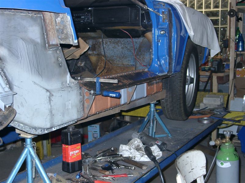

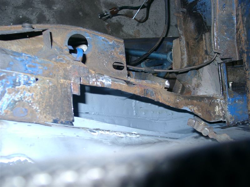

Hi guys, here is a little update on the project.
Today i did some grinding on the spotwelds and cleaning at the engine shelf.
I am not sure if i should replace the whole part or rescue as mutch as possible of the original metal.
michelko
post Oct 16 2004, 09:59 AM
Post #154
Posts: 867
Member No.: 1,404
grinded spotwelds
michelko
Post #155
Posts: 867
Member No.: 1,404
much more to go

how are you going to adress the fender cut out issue? you must have lost some material when taking the lower section out.
kevin
michelko
post Oct 16 2004, 11:34 AM
Post #160
Posts: 867
Member No.: 1,404
QUOTE(rhodyguy @ Oct 16 2004, 08:32 AM)
kevin
Yes a little bit is lost. But i used the smal "dremel" Cutting wheels.
I think they are less then one mm thick.
I am also looking for an new quarter panel, to replace the whole thing.
Till then, the old one should work fine.
(IMG:style_emoticons/default/smilie_flagge6.gif)
