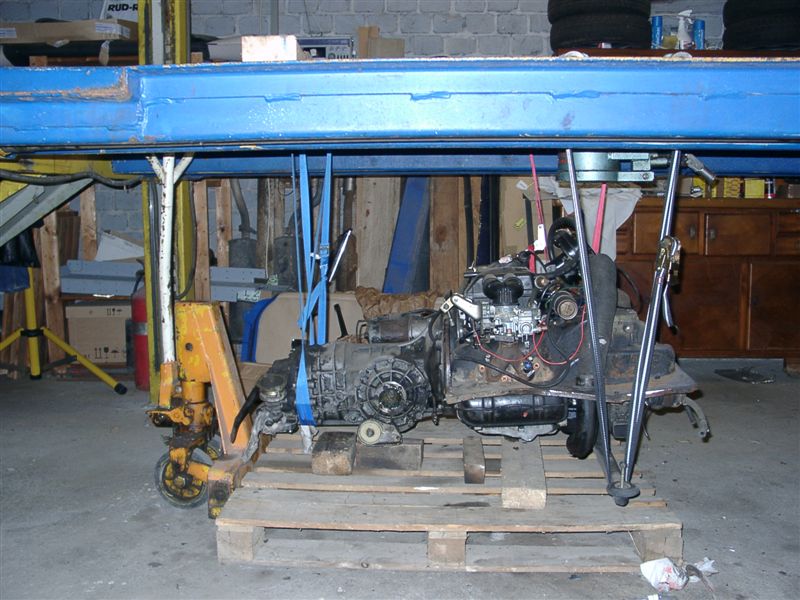

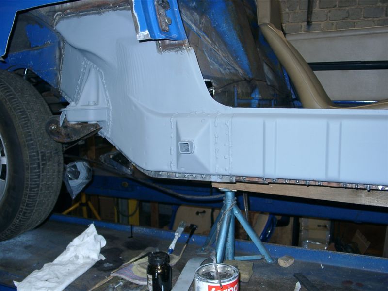

so here is the next update. Welded in the jacksupport and did some priming.
Today i lowered the car on its tires and removed the brace. What should i say, there is no shrinkage (IMG:style_emoticons/default/smilie_pokal.gif) The measurement is originaly like listed in the 914 info section. I am just so happy (IMG:style_emoticons/default/aktion035.gif)

here is a shot of the original engine.
It will be replaced with an second one that always has the injection and dont make strange sounds while running. (IMG:style_emoticons/default/wacko.gif)

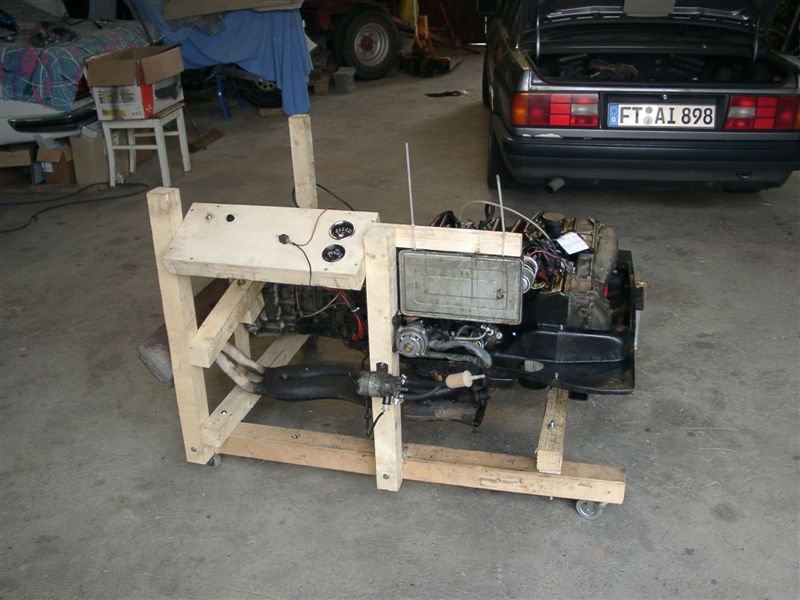

Member No.: 1,404
second engine in the test-stand.
will keep you informed.
(IMG:style_emoticons/default/smilie_flagge6.gif)

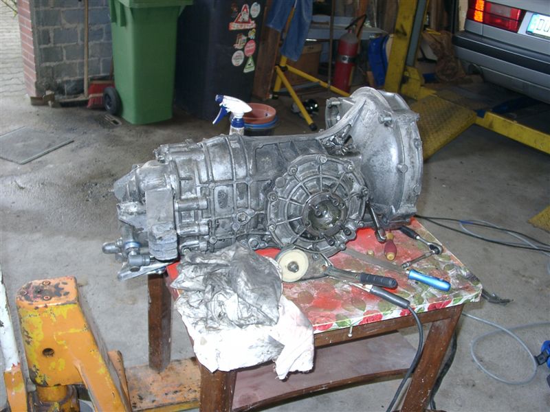

Hi Guys,
here ara some news.
Some progress at the hell hole. No pics yet will take them saturday.

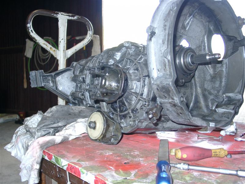

In the mean time i worked on the transmission. What an oily mess. That little ball with the threads that holds the clutch fork was loose. So there was an oil leak. Sorry forgot to take a pic of that, here is one after cleaning with new Seals and oil waiting to get assambled to the engine.
michelko
post Nov 11 2004, 02:20 PM
Post #168
Posts: 867
Joined: 30-November 03
From: Germany, Lambsheim
Member No.: 1,404
shiny and clean. i have also a new clutch disk , bearing etc.
Can´t wait to drive that car again.
By the way, yesterday we had the first snow! And it gets realy cold in the gararge. <_<

QUOTE(michelko @ Nov 11 2004, 01:18 PM)
hey michelko, what year is your car? that sure looks like a "sloppy" tailshifter to me ...
(IMG:style_emoticons/default/unsure.gif) Andy
michelko
post Nov 11 2004, 02:27 PM
Post #170
Posts: 867
Member No.: 1,404
Hi Andy,
it is an 1970. It was manufactured as #7092. No Problem with the tailshifter. (after replacing al the bushings, some fine tuning,etc But i have no comparison to an side shifter. Those cars are realy rare here in good old germany.

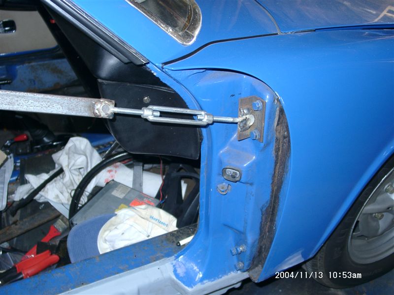

Michelko-
Do you have any close ups of the cross bar you made, and how it mounted to the body of your 914? Looks like I am going to have to fab something up, and any ideas/pics you can share would be helpful.
Thanks,
Chris
michelko
post Nov 12 2004, 02:42 PM
Post #173
Posts: 867
Member No.: 1,404

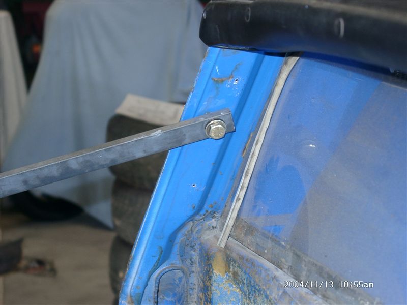

Hey Chris,
tomorow is again fighting day. I will take some pics of the brace and post it for you.
The brace mounts at the original safetybelt mount and the upper doorhinge mounting point. It was done in about 5 -10 minutes. You only need a drill an d a welder to do this.

Hi Chris,
here are the promised pics.
First shot: Doorhinge mounting
michelko
post Nov 13 2004, 12:36 PM
Post #176
Posts: 867
Member No.: 1,404

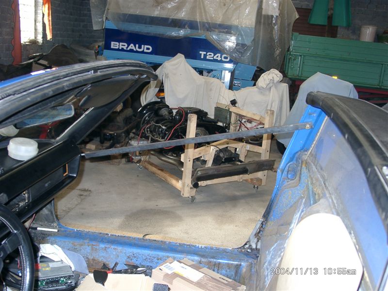

don´t know the english word for this.
It let you adjust the measurement of the chasis.
I managed to hit the factory specs with this brace (IMG:style_emoticons/default/smilie_pokal.gif)
second shot: Security belt mounting

Member No.: 1,404
as you can see, it is no rocket science to keep the measurements of the car.

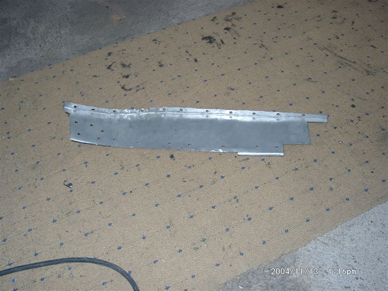

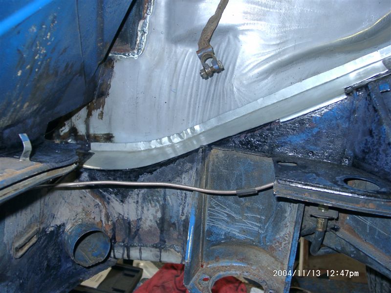

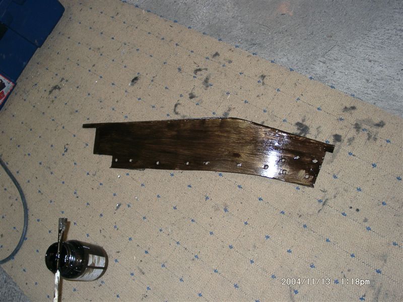

And now to the realy good news. The hell hole is closed with fresh metal.
The patch:
michelko
post Nov 13 2004, 12:40 PM
Post #179
Posts: 867
Member No.: 1,404
patch plus weldable primer

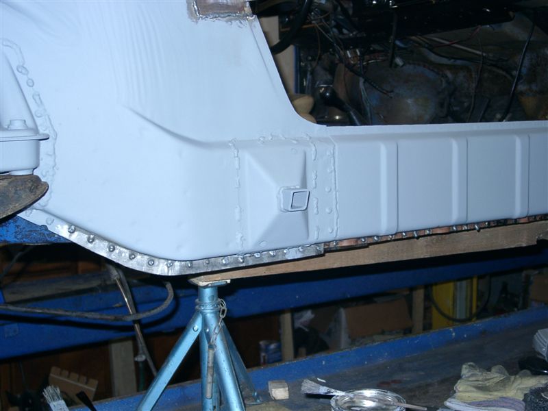

michelko
post Nov 13 2004, 12:41 PM
Post #180
Posts: 867
Member No.: 1,404
patch in place
