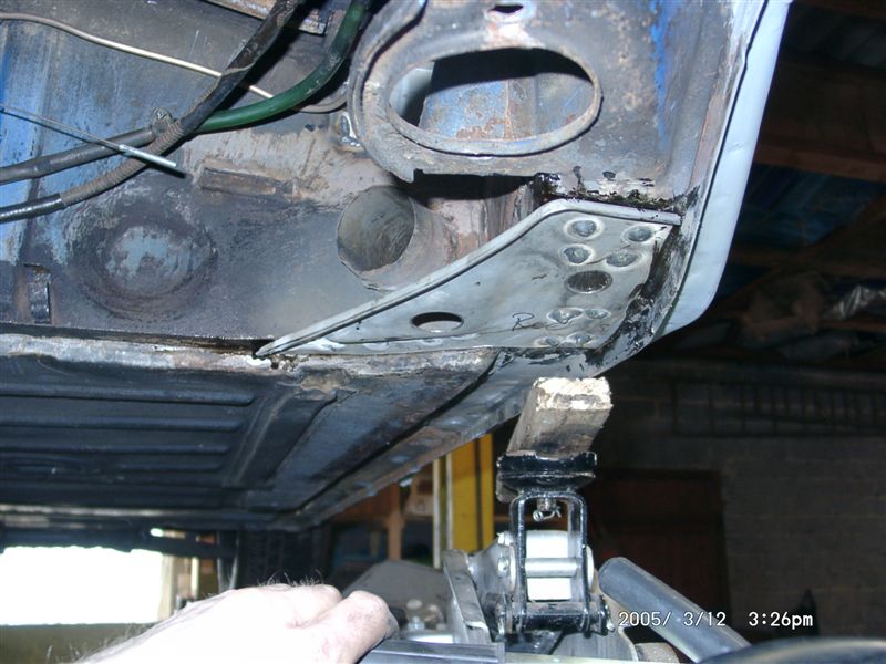

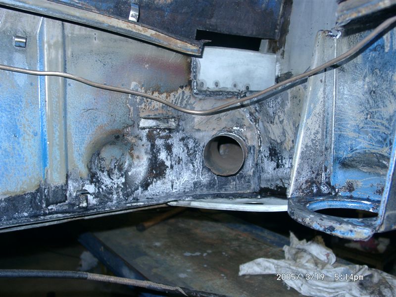

Hi guys,

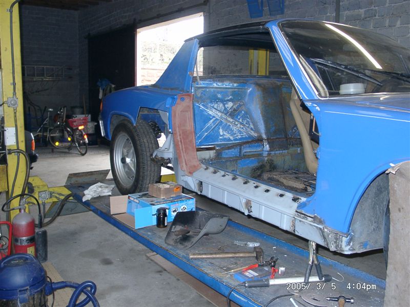

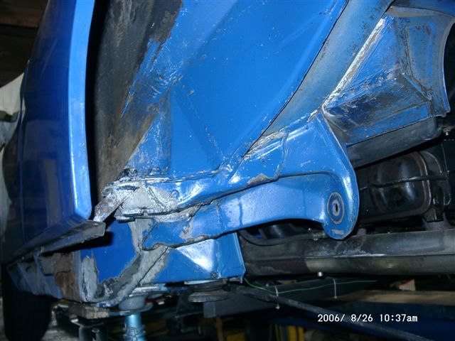

look what i found under the fender. The PO did some very fine work to repair the hell hole (IMG:style_emoticons/default/ar15.gif)
michelko   diggin into hell   Sep 5 2004, 03:13 AM
michelko   another   Sep 5 2004, 03:14 AM

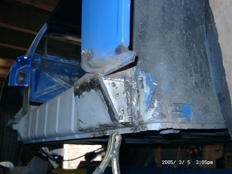

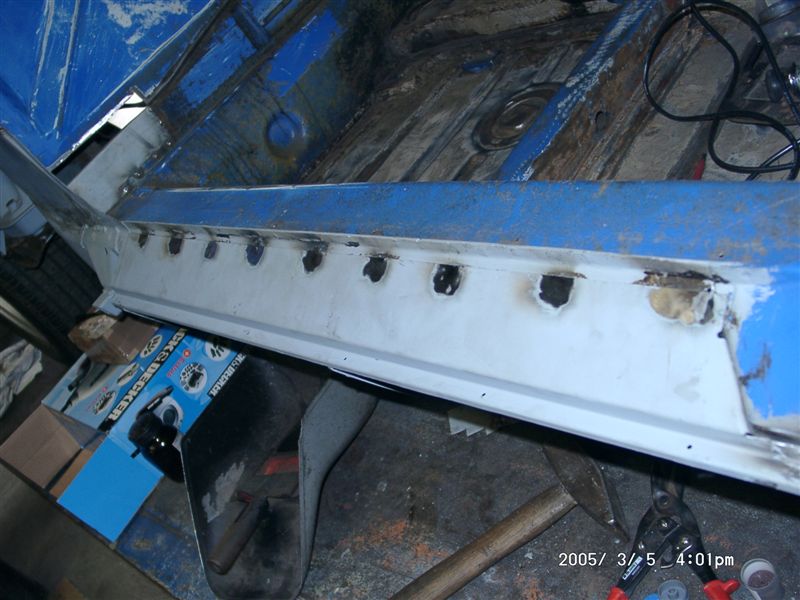

michelko   The sheet metal was riveted to the longitudinal :w...   Sep 5 2004, 03:16 AM

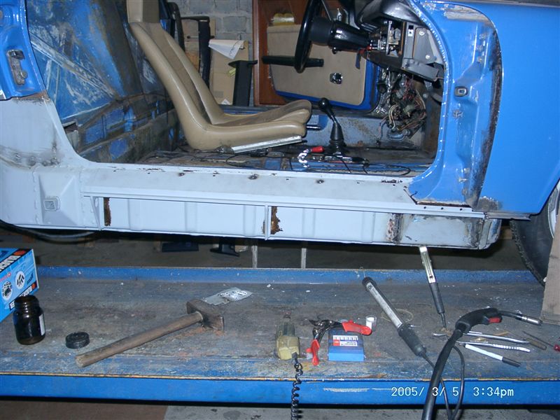

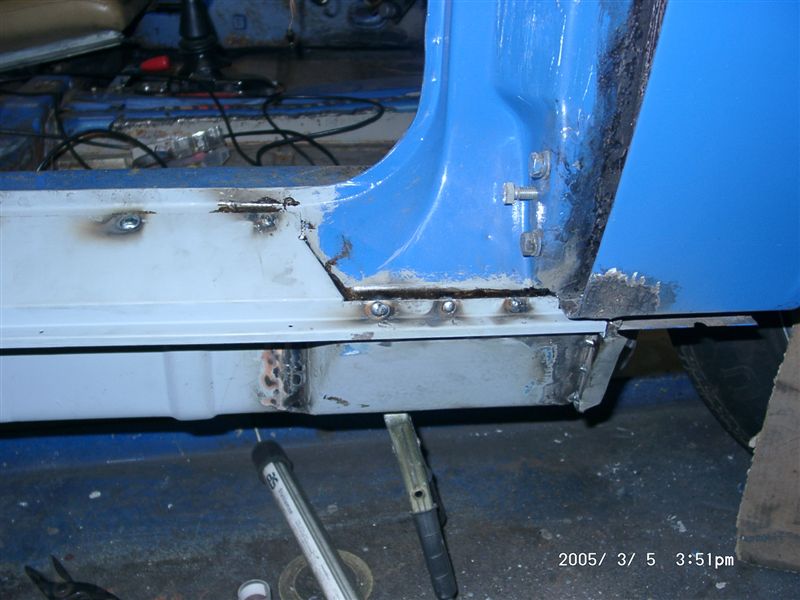

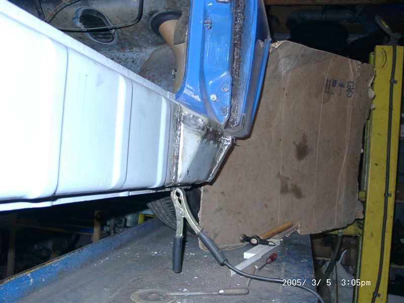

michelko   here you can see the new metal. Think next weekend...   Sep 5 2004, 03:20 AM
michelko   Some advice to keep the door gap stable? I made a ...   Sep 5 2004, 03:23 AM

Joe Sharp Old   Reminds me of one of my ex's, so pretty outsid...   Sep 5 2004, 03:59 AM
redshift   Oh my god dood, you went waaaaaaaaay too far! ...   Sep 5 2004, 05:21 AM
Jeroen   Hey Michael, good job! The only thing worse t...   Sep 5 2004, 07:26 AM
michelko   Hi Jeroen, got that nice piece of metal on US Ebay...   Sep 5 2004, 09:18 AM
Brad Roberts   WOW !!. That is crazy. You did a great jo...   Sep 5 2004, 09:24 AM
Brad Roberts   You should also look in our Vendors area for the n...   Sep 5 2004, 09:25 AM
michelko   Hi Brad, received the part with no problems. The t...   Sep 5 2004, 09:42 AM

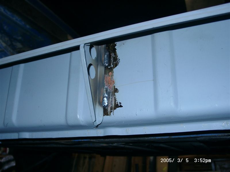

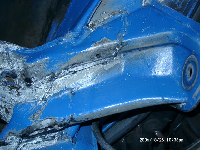

michelko   additional pic from inside of the long. Have to dr...   Sep 12 2004, 10:26 AM

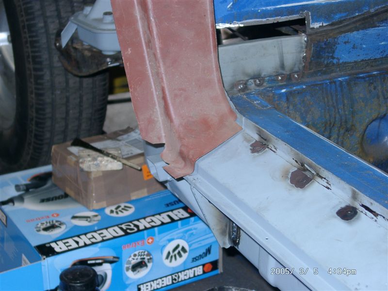

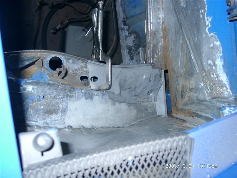

michelko   hi everybody, did some work on the rustbucket. Cut...   Sep 16 2004, 02:54 PM
michelko   Hold the new sheetmetal in place. looks very nice ...   Sep 16 2004, 02:56 PM
michelko   should add the pic ;)   Sep 16 2004, 02:56 PM
michelko   nother one   Sep 16 2004, 02:59 PM
michelko   inside of the console and the safetybelt mounting ...   Sep 16 2004, 03:02 PM
michelko   outside saturday will be weldingtime again :welde...   Sep 16 2004, 03:04 PM

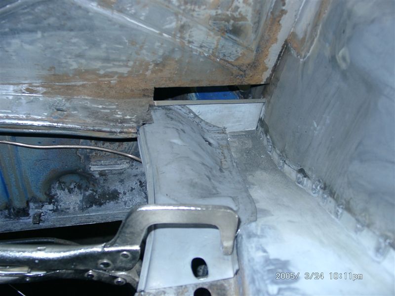

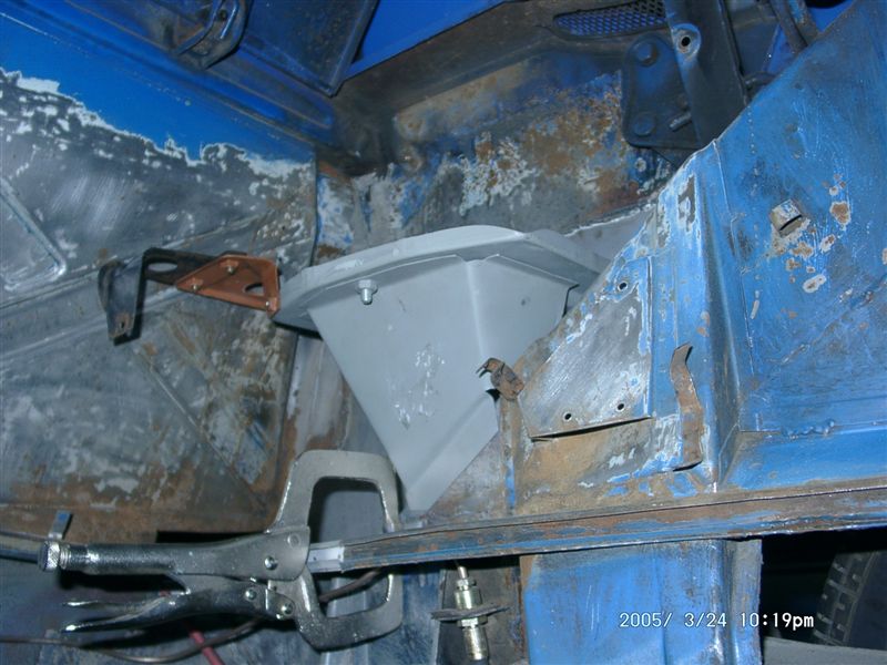

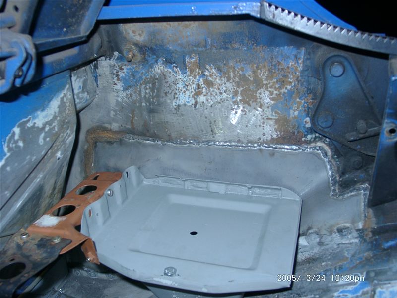

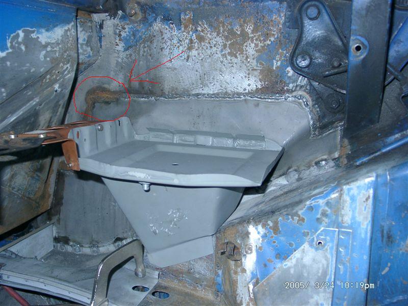

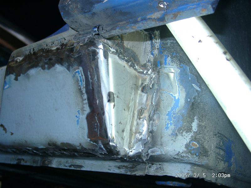

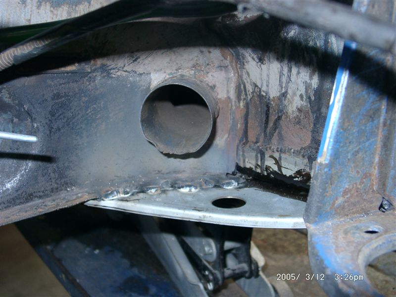

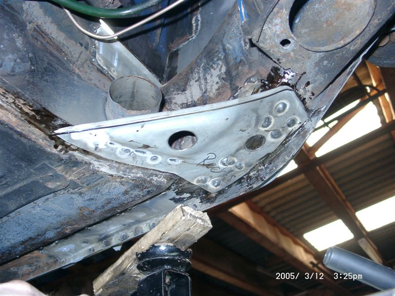

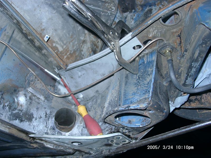

michelko   And the story goes on. removed the batterytray tod...   Sep 18 2004, 09:50 AM
michelko   the firewall was also infected. The first replacem...   Sep 18 2004, 09:52 AM
michelko   wr   Sep 18 2004, 09:53 AM
michelko   thats for today. did i tell you that i hate rust? ...   Sep 18 2004, 09:56 AM
BatAc   As much as you're scarin' the sh*t out of ...   Sep 18 2004, 10:29 AM
d7n7master   Damn - you do beautiful work :trophy: I don't...   Sep 18 2004, 10:39 AM
michelko   during study i worked one day per week in an metal...   Sep 18 2004, 11:24 AM

SpecialK   The flux core seems to do a dandy job on thicker m...   Sep 18 2004, 02:11 PM
fiid   Some flux core welders are upgradeable to mig for ...   Sep 18 2004, 03:05 PM
michelko   Hi Special_K "how do you say "You've got ball...   Sep 18 2004, 03:12 PM

BatAc   Michelko, I assume you're going to "sandwhich"...   Sep 19 2004, 12:13 AM
SpecialK   I don't know about michelko, but I'd "weld...   Sep 19 2004, 01:38 AM

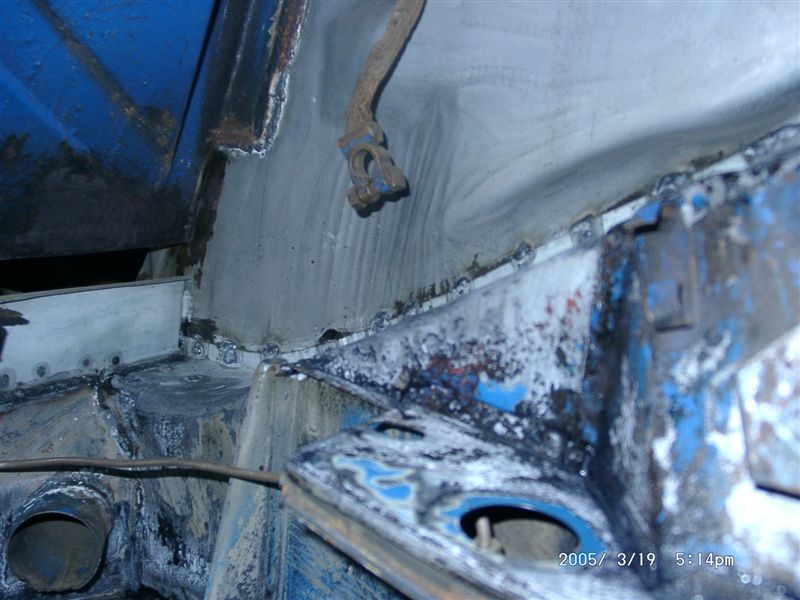

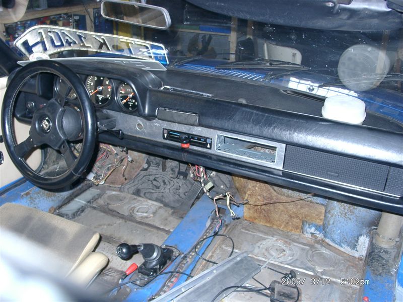

michelko   The story goes on, ....slowly but steady :) . Did ...   Sep 25 2004, 09:53 AM
michelko   nother one   Sep 25 2004, 09:55 AM
michelko   from the inside   Sep 25 2004, 09:55 AM
michelko   nother   Sep 25 2004, 09:57 AM
michelko   I wil have to do some more cleaning till i can wel...   Sep 25 2004, 10:10 AM

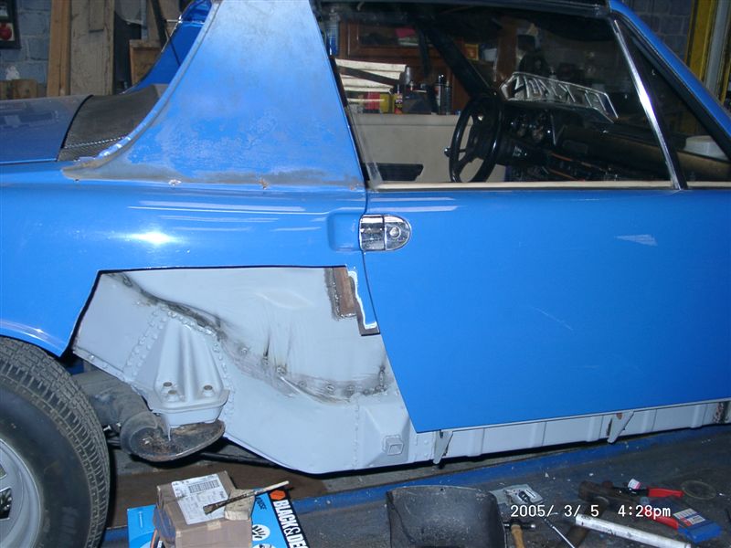

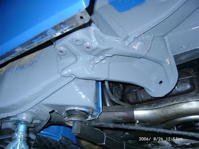

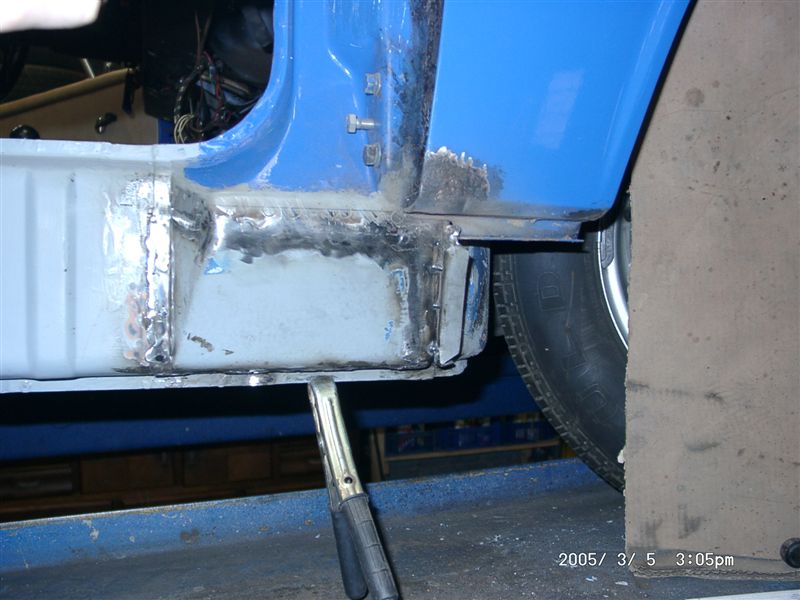

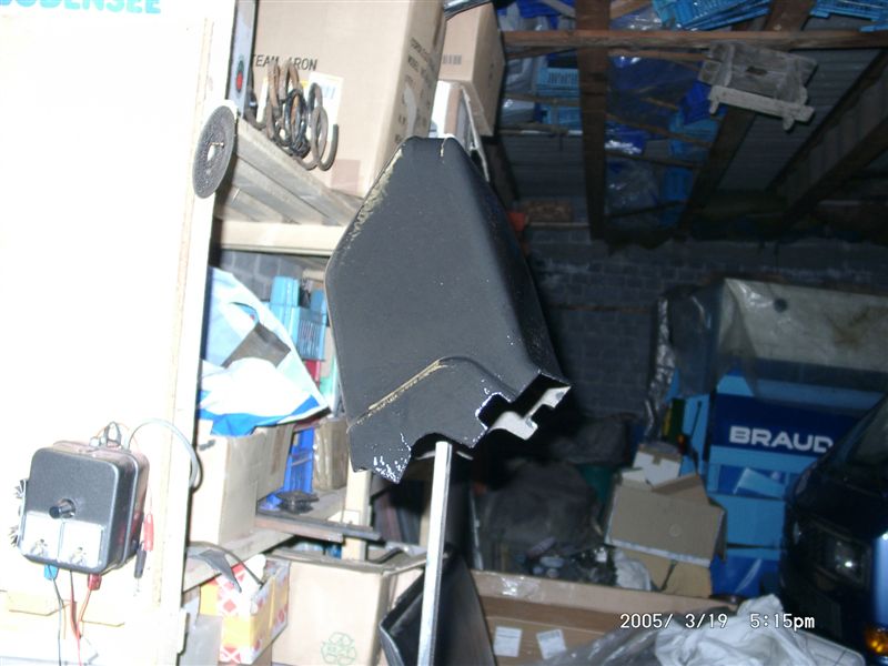

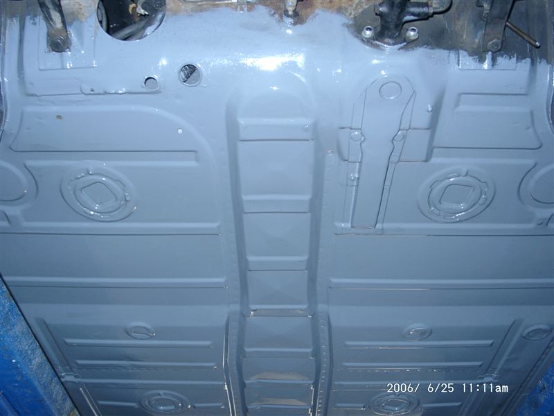

michelko   Here we go. Some progress pics. Fitted the outer r...   Sep 30 2004, 01:18 PM
michelko   blabal   Sep 30 2004, 01:19 PM
michelko   :wub:   Sep 30 2004, 01:20 PM
michelko   primed area 51   Sep 30 2004, 01:22 PM
michelko   front   Sep 30 2004, 01:23 PM
michelko   nother   Sep 30 2004, 01:24 PM

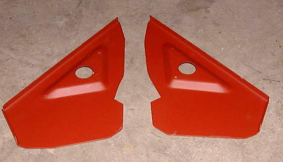

michelko   and the new parts   Sep 30 2004, 01:25 PM
michelko   can you count the number of paint jobs? :wacko:   Sep 30 2004, 01:26 PM
michelko   and some more new parts and a bottle of fuel :wooh...   Sep 30 2004, 01:53 PM
michelko   i also received last week engman´s stiffenig kit....   Sep 30 2004, 01:56 PM
