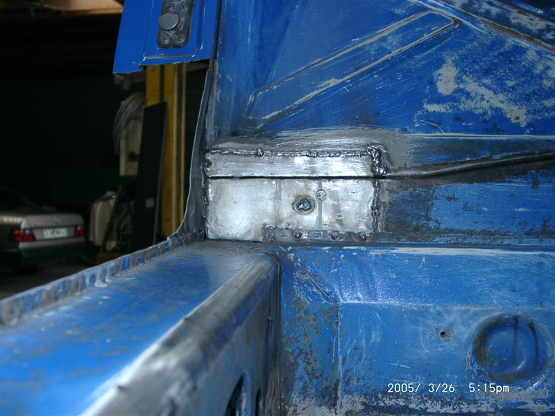

If it were me, I would grind down that bead flush - You are doing everything on the car where you cannot tell it is different than how it came from the factory - why leave large telltale signs now?

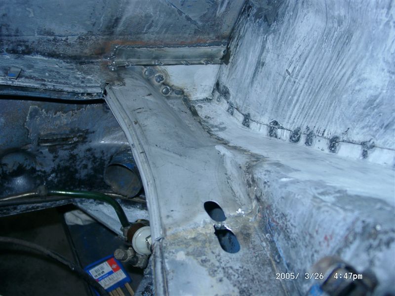

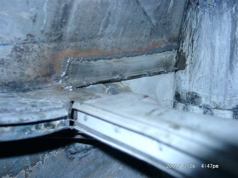

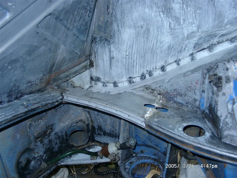

Hello together,
today i made again big progres.Closed the firewall and welded in the last part of the engine shelf. Did some grinding, and metal ready.
michelko
post Mar 26 2005, 10:09 AM
Post #263
Posts: 867
Joined: 30-November 03
From: Germany, Lambsheim
Member No.: 1,404
the shelf

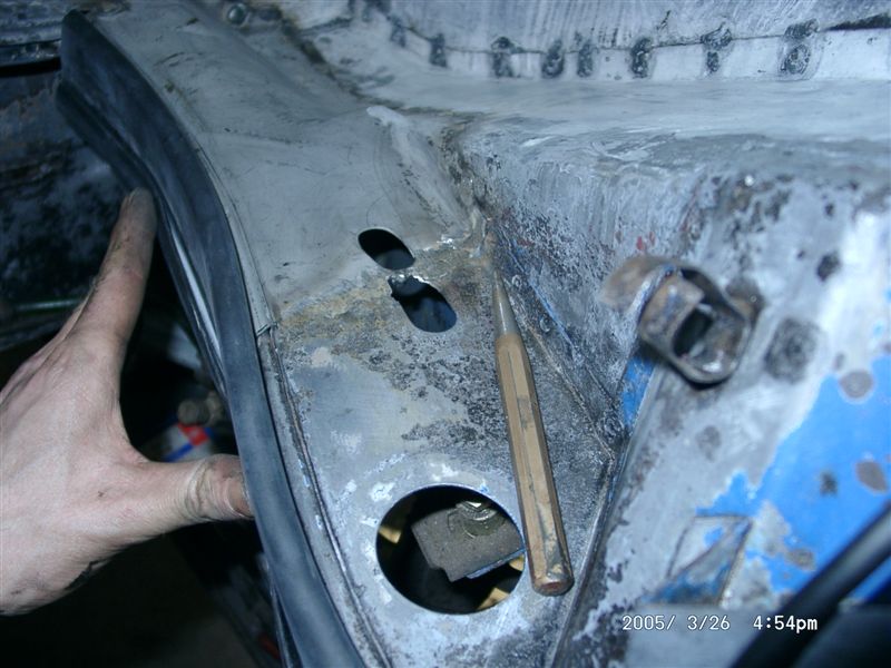

the engine seal in place

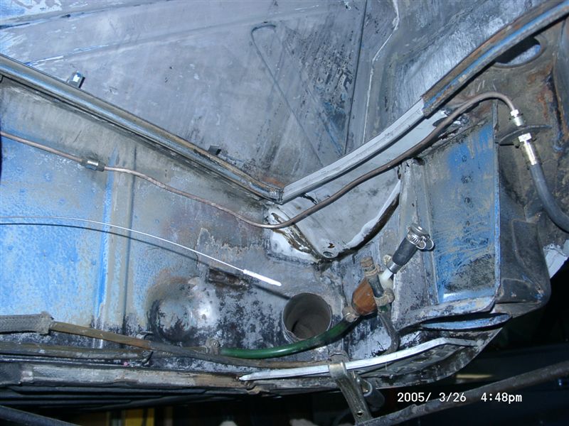

Fire wall from inside
