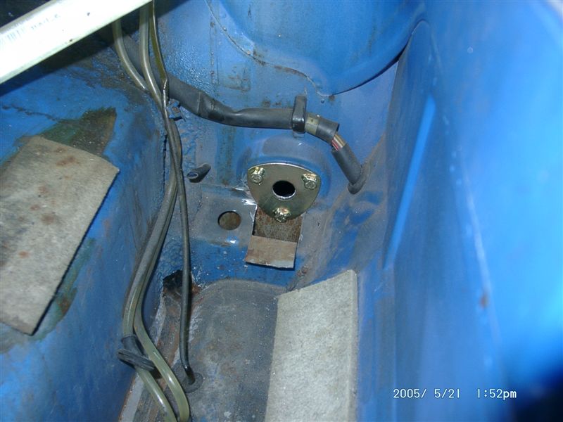

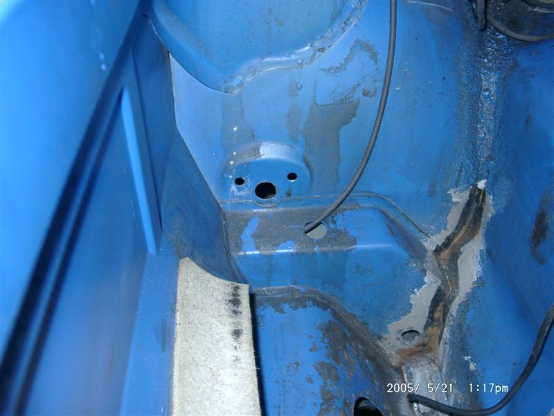

passenger side
michelko
post May 22 2005, 02:12 AM
Post #342
Posts: 867
Joined: 30-November 03
From: Germany, Lambsheim
Member No.: 1,404

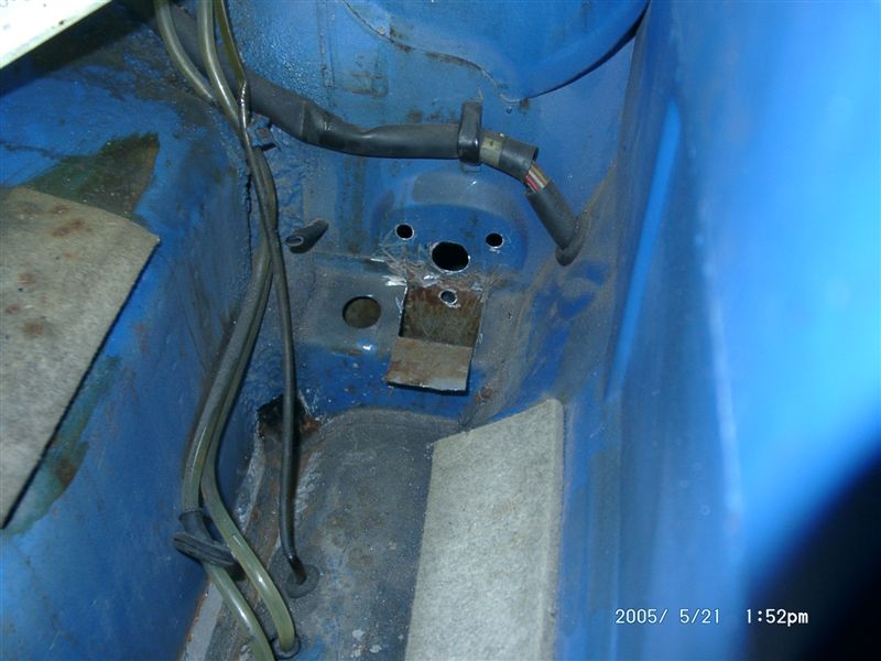

cutting the opening
michelko
post May 22 2005, 02:13 AM
Post #343
Posts: 867
Member No.: 1,404
without the plate
michelko
post May 22 2005, 02:14 AM
Post #344
Posts: 867
Member No.: 1,404
view from the wheel side

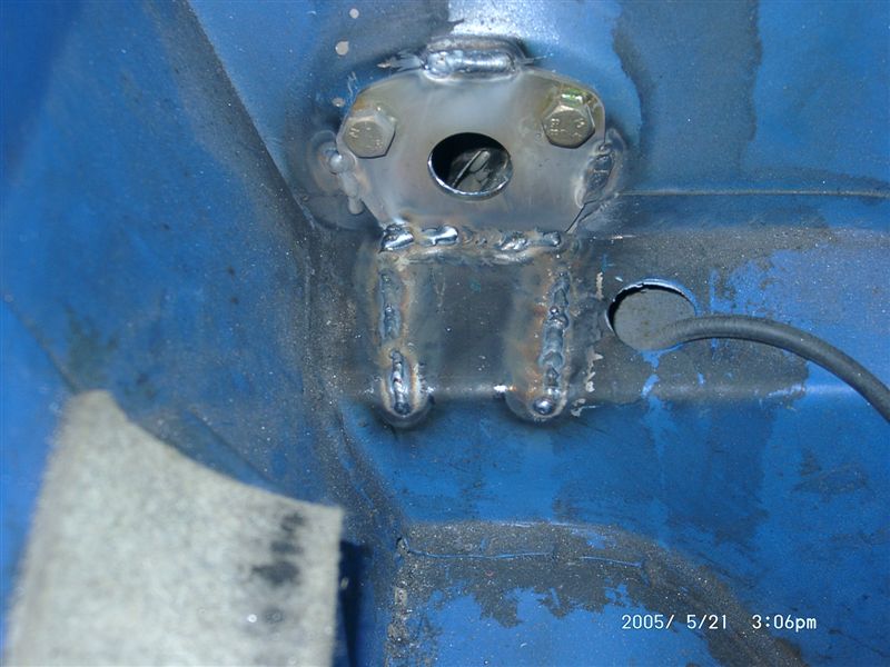

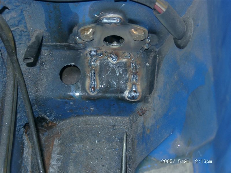

Plate welded in and the hole closed (IMG:http://www.914world.com/bbs2/html/emoticons/welder.gif)
michelko
post May 22 2005, 02:16 AM
Post #347
Posts: 867
Member No.: 1,404

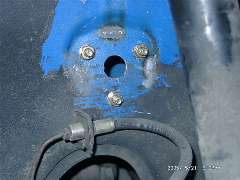

same procedure on passenger side
michelko
post May 22 2005, 02:17 AM
Post #348
Posts: 867
Member No.: 1,404
welded and closed
michelko
post May 22 2005, 02:19 AM
Post #349
Posts: 867
Member No.: 1,404
and the last one view from wheel side again

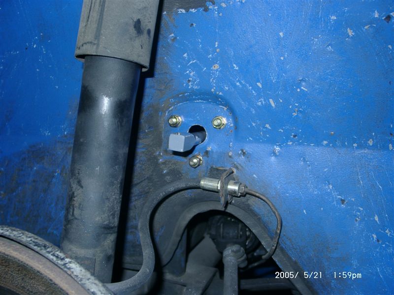

michelko   Posted on May 22 2005, 01:10 AM last week i drilled the holes for the front sway bar.
this weekend i cutted out the sheet metal to put in the reinforcement plates.
Did your car have the original factory swaybar upfront?

QUOTE (Lou W @ May 22 2005, 12:19 AM)
nope. i bought a used 911 swaybar. and new reinforcment plates from a 914 parts dealer in germany. I grinded down the sway bar to bare metal and por15ed it. I think i will bring the drop links to the sand blaster, it is to much work to clean them by hand (IMG:http://www.914world.com/bbs2/html/emoticons/dry.gif) . maybe i will get them plated or they will also be por15ed.
(IMG:http://www.914world.com/bbs2/html/emoticons/smilie_flagge6.gif)

nope. i bought a used 911 swaybar. and new reinforcment plates from a 914 parts dealer in germany. I grinded down the sway bar to bare metal and por15ed it. I think i will bring the drop links to the sand blaster, it is to much work to clean them by hand dry.gif . maybe i will get them plated or they will also be por15ed.
Oh, ok, I was trying to figure out if you were stiffening the mounts for the stock swaybar, or adding one. I'm trying to decide if powder coating the sway bars would work, If not, then I'll probably just paint them. I'm getting ready to powder coat parts of my suspension, and now would be the time to do it.

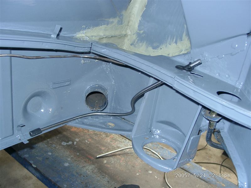

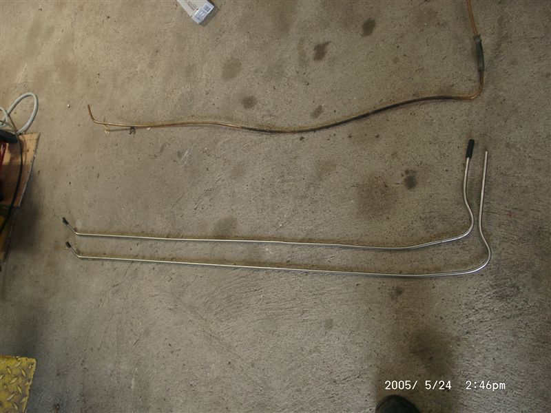

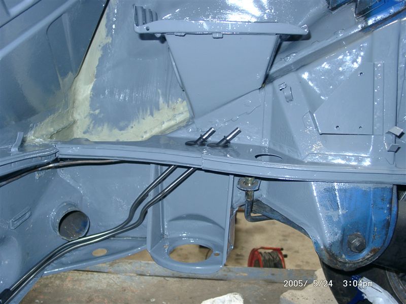

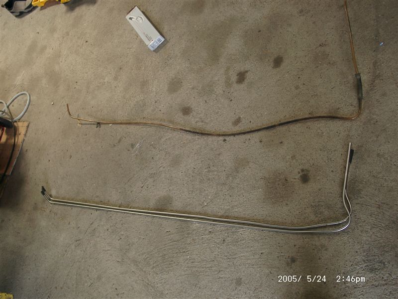

Hi ogether,
yesterday i gotm the stainless steel piping for the fuel lines.
Very nice to work with. I made both lines of 8 mm pipes.
michelko
post May 24 2005, 12:57 PM
Post #357
Posts: 867
Member No.: 1,404
nother view
michelko
post May 24 2005, 12:59 PM
Post #358
Posts: 867
Member No.: 1,404
i decided to make two parts of each line and conect them with high pressure fuel line. much easyer to handle
michelko
post May 24 2005, 01:00 PM
Post #359
Posts: 867
Member No.: 1,404
with grommets installed
michelko
post May 24 2005, 01:03 PM
Post #360
Posts: 867
Member No.: 1,404
i flared the ends of the pipes so they should hold the pressure, hope so. (IMG:http://www.914world.com/bbs2/html/emoticons/dry.gif)

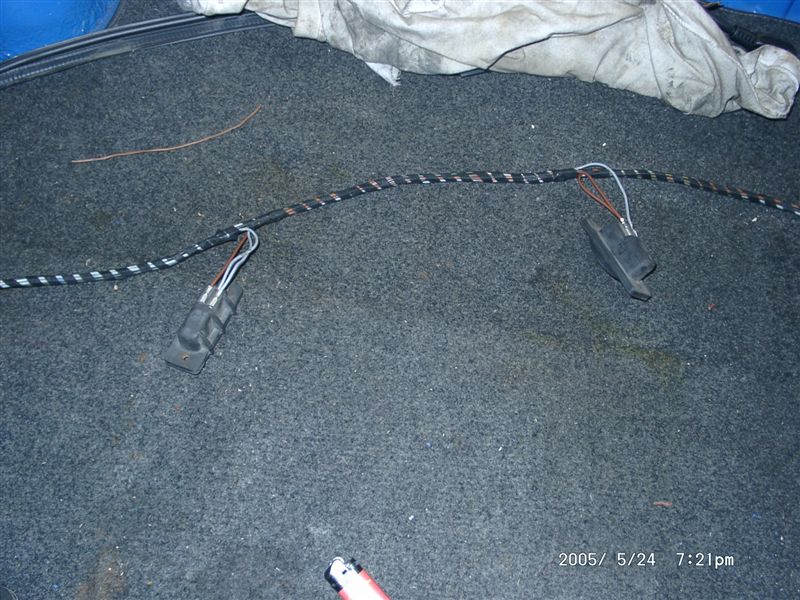

i did also some wire work. the trunk cables are new wraped with tape and i made the connection for the licence plat light new
