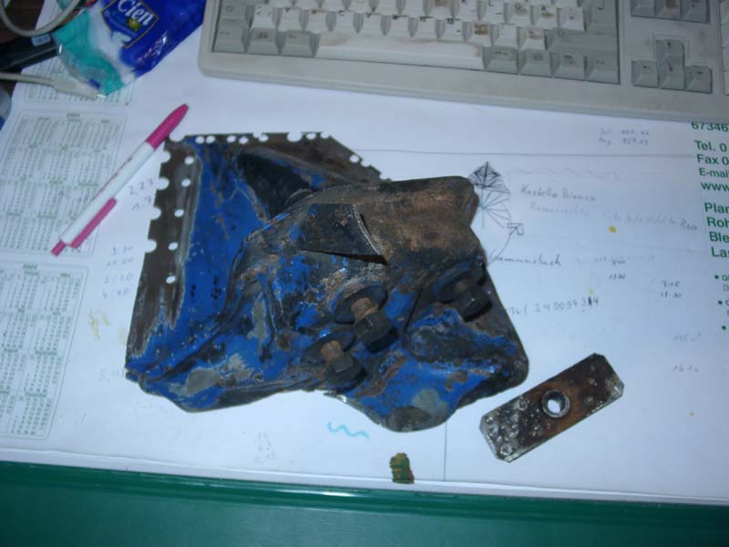

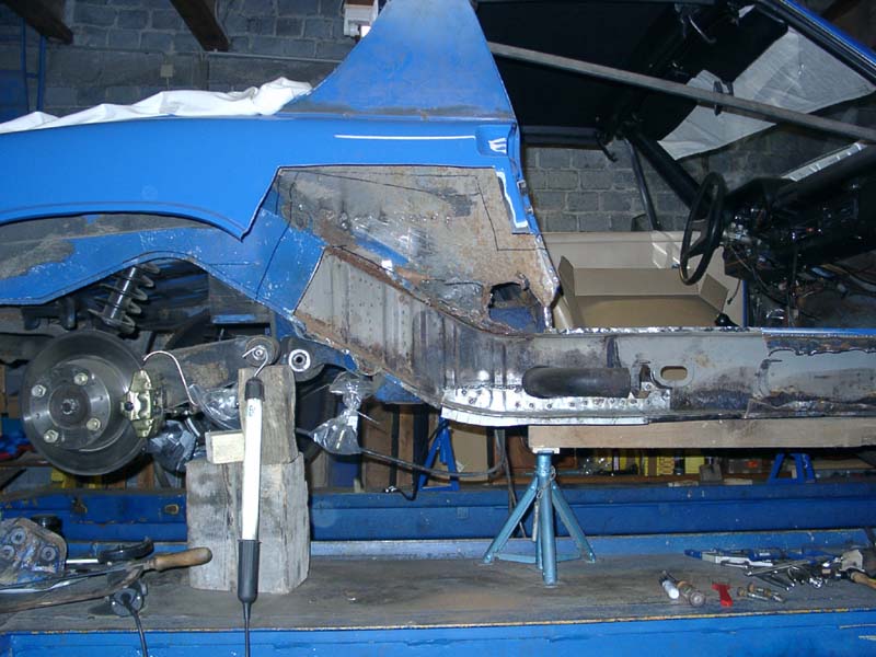

hi everybody,
did some work on the rustbucket.
Cuted out the Suspension console. No way way to solve the problem with less cutting <_< It was rusted directly to the console, so there was no metal left to weld the new one against.

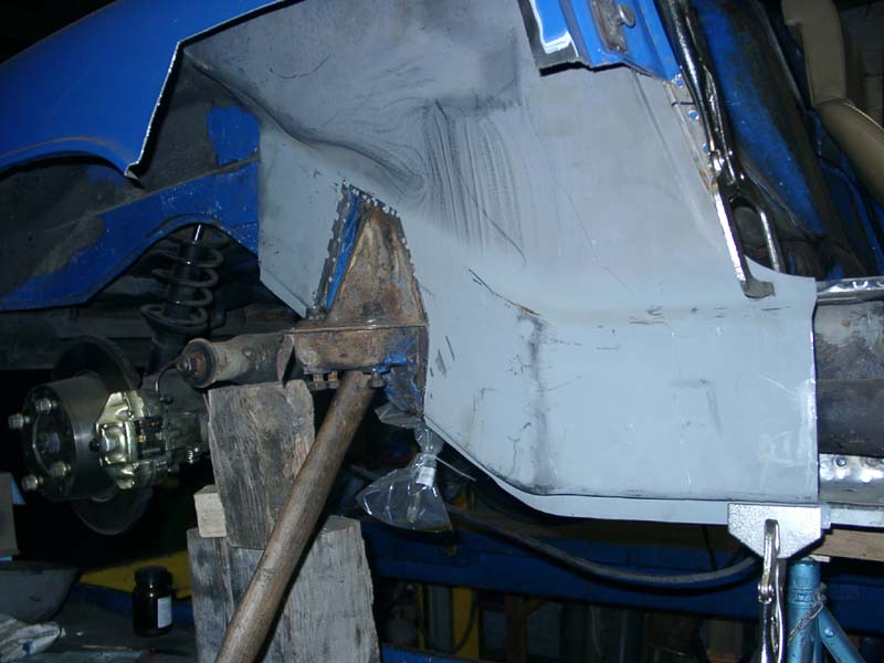

Hold the new sheetmetal in place. looks very nice (IMG:style_emoticons/default/wub.gif) the car will be strong again in this area.

should add the pic (IMG:style_emoticons/default/wink.gif)

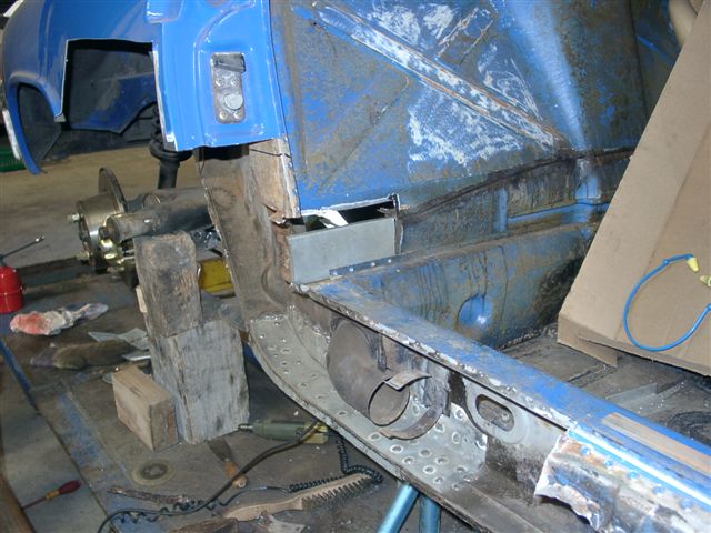

nother one

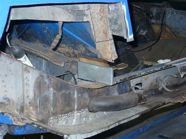

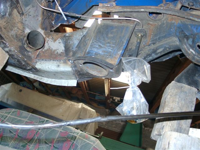

inside of the console and the safetybelt mounting point.
Will bring them tomorow to the sandblaster.

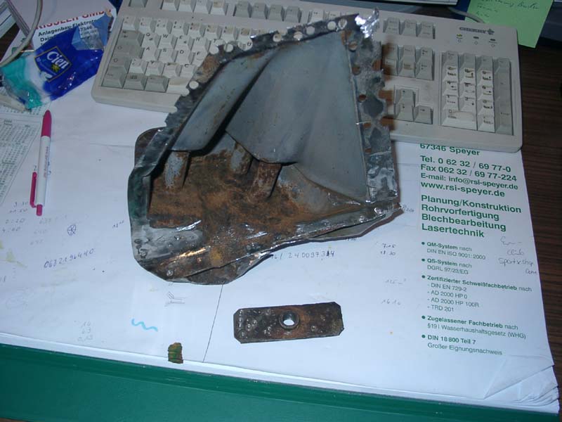

outside
saturday will be weldingtime again (IMG:style_emoticons/default/welder.gif) (IMG:style_emoticons/default/welder.gif) (IMG:style_emoticons/default/welder.gif)

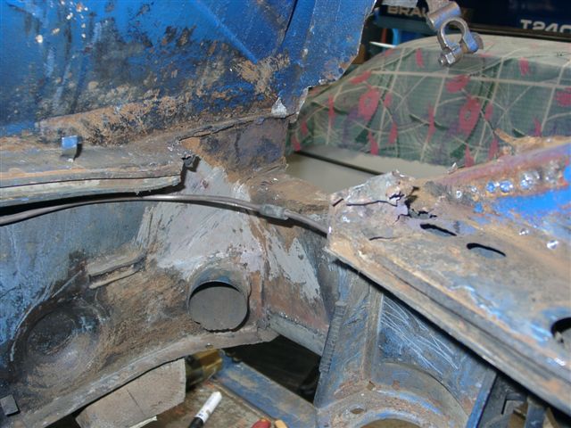

And the story goes on.
removed the batterytray today. The PO purchased a new on and welded it in like crap (IMG:style_emoticons/default/barf.gif) . I hate PO´s!! It took me 2 hours to remove the tray, and when iz was out i saw that shitty welding. sory no pic of it.
next step was cutting out pieces of the engine shelf

the firewall was also infected. The first replacement sheet is fabricated.
