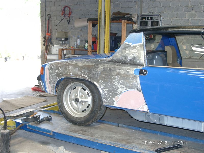

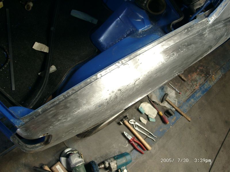

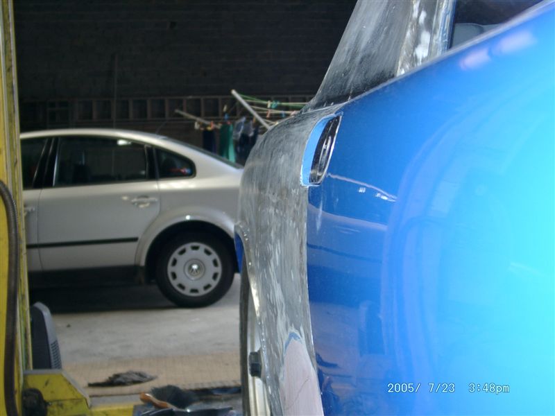

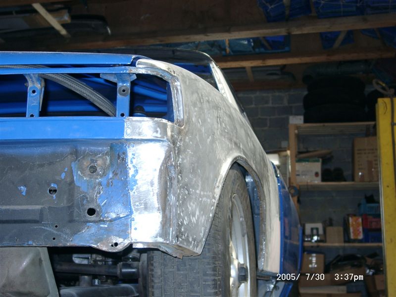

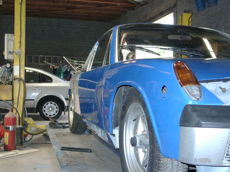

spend nearly the whole day to grind down to bare metal. I think there was abóut 3-4mm Bondo filler and paint on the quarter. don´t know why (IMG:http://www.914world.com/bbs2/html/emoticons/confused24.gif)
As shown in the pics the panel is nice and straight. The car lost some kilo´s today.

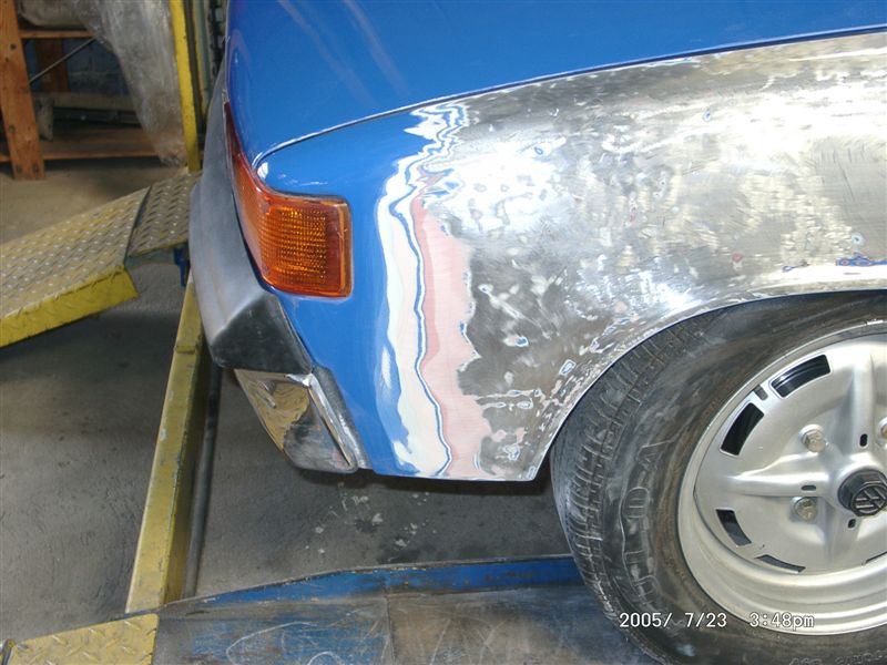

nother view

see what i mean?

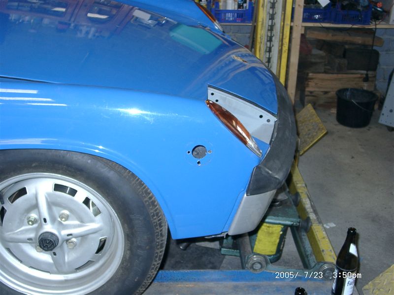

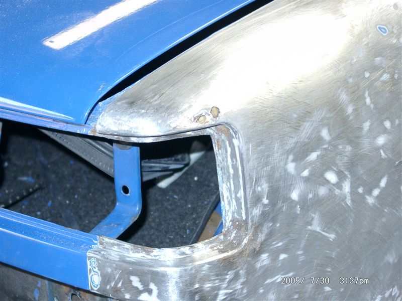

I am also eliminating the side markers

i am thinking of using por15 as first coat on the quarter panel. then tie coat primer then filler and paint. any sugestions?

As much as I like POR 15 (and I've got it damn near everywhere), I'd be a little leery about using it under my paint job. I'm planning on laying down a coat of epoxy primer:
House of Kolor (copied from their website)
KWIKURE EPOXY PRIMER (KP21)
KP21 is a 2.1 VOC hi-solids catalyzed Epoxy Primer that meets all current air quality regulations. It is designed to be the first primer applied to bare steel, aluminum, fiberglass, magnesium and galvanized surfaces. It's strong adhesion, hi-build, excellent durability, and corrosion resistance make it the logical choice for the base of a long lasting paint job.
For the inside of the wheel wells and floor pan, I think POR is a good choice for it's durability.

QUOTE (Special_K @ Jul 23 2005, 07:59 AM)
yes, epoxy base primer was the other thought. Not sure what is better under paint (IMG:http://www.914world.com/bbs2/html/emoticons/confused24.gif)

I'm planning to use House of Kolor products for the paint job on my '73 just because of the results my friend got on his '67 Camero (IMG:http://www.914world.com/bbs2/html/emoticons/wub.gif) . PPG and other brands are probably just as good, but you wouldn't want to mix and match primers and paints from different companys, i.e. - POR under PPG primer, topcoated with House of Kolor base coat (or that's what I've been told).
You've done such a beautiful job of getting your car solid, you're definitely going to want to have the paint job last as well. (IMG:http://www.914world.com/bbs2/html/emoticons/beerchug.gif)

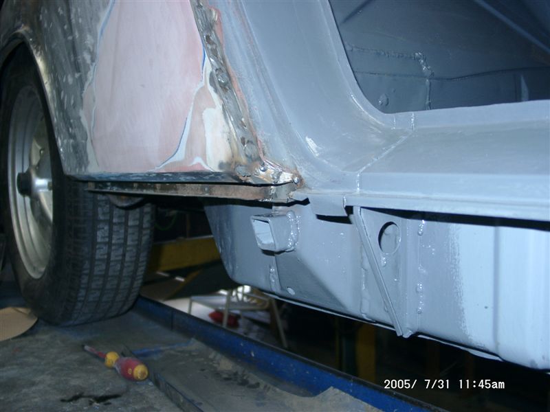

oh my god, grinding, grinding, grinding, sanding etc. (IMG:http://www.914world.com/bbs2/html/emoticons/huh.gif)
don´t want no more (IMG:http://www.914world.com/bbs2/html/emoticons/wacko.gif)
i have the right rear quarter ready, think so.
Stripped to bare metal. let the painting begin (IMG:http://www.914world.com/bbs2/html/emoticons/w00t.gif)

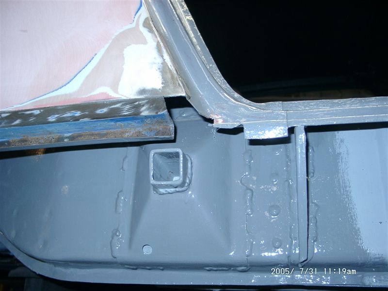

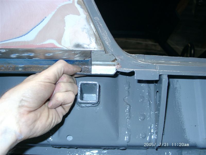

found a little rust hole. can you see it?

nother

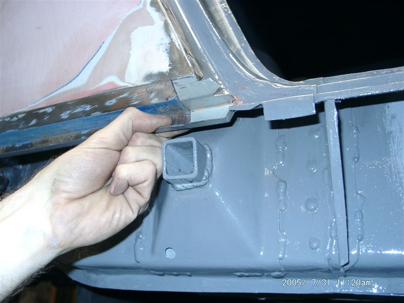

(IMG:http://www.914world.com/bbs2/html/emoticons/stromberg.gif) forgot to fab the little missing piece. Now it realy hard to get it welded in

the part

nother view
its amazing what you can do with some sheet metal and a hammer

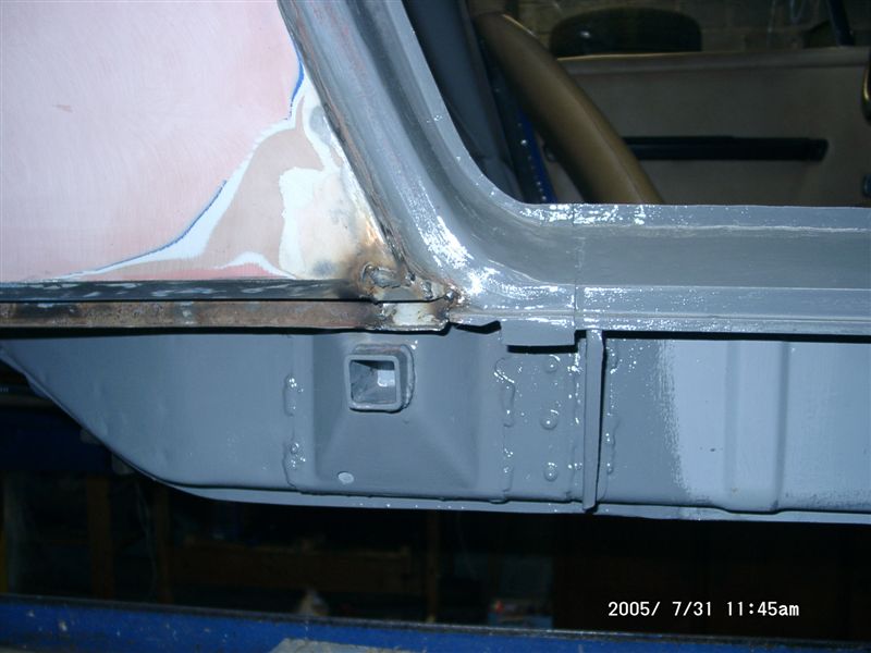

welded in, not my best welding, but it should be good enough for that hidden place. Some grinding and it should be fine

nother view

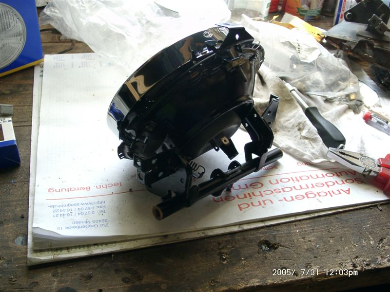

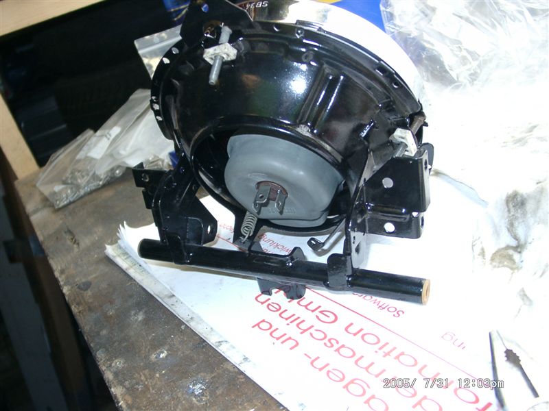

and here the realy nice parts. sandblasted painted reasambled front light. with new reflector
michelko

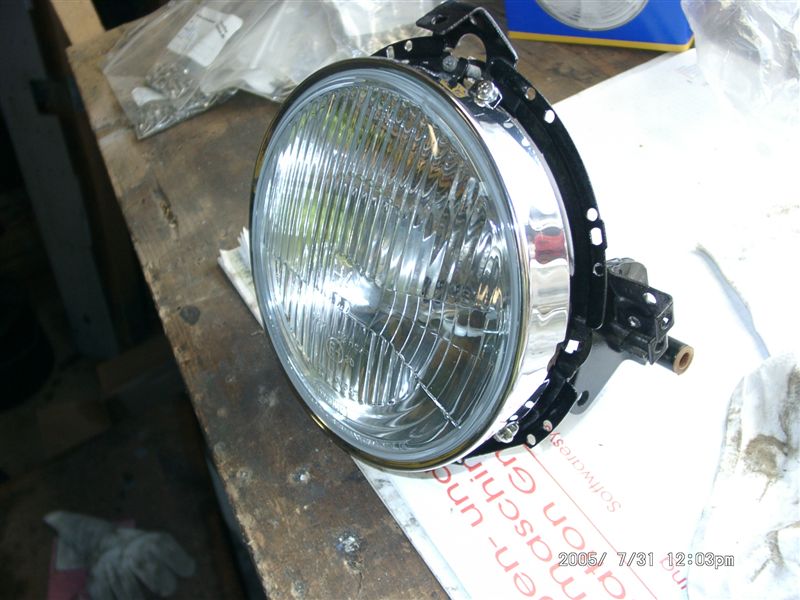

#2

last one
have a nice weekend
