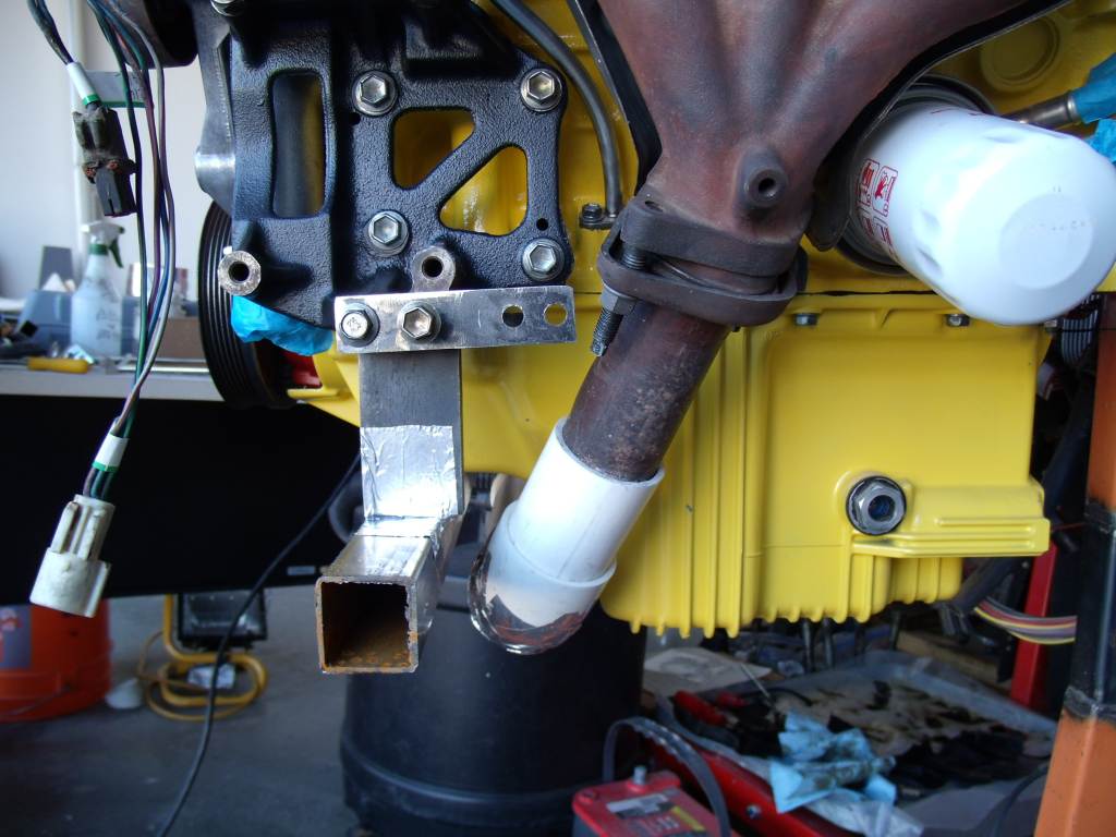

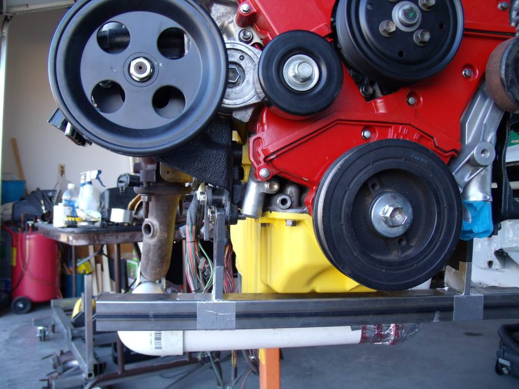

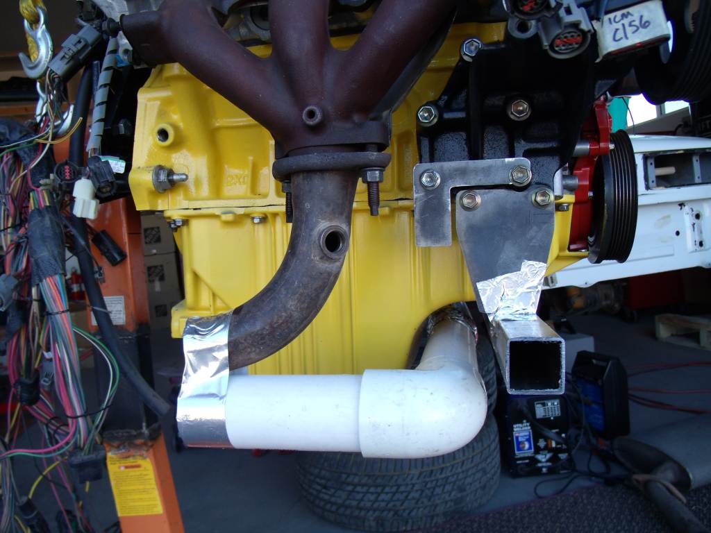

Here's the mockup pics for the down pipes from the two headers that will merge into a single 2.5" exhaust. Fortunately it merges on the right side, away from the shift bar. PVC is 2in ID - same as mandrels.
Left side. Piece of 1.5" square steel represents the engine bar. Don't want to weld it until I test fit in the engine bay.
Front. Could have come straight down with the right pipe, but need an extra inch of clearance when its on the engine cradle during testing.
Right - well already see something I'll need to fix. Mockup's doing its job.
