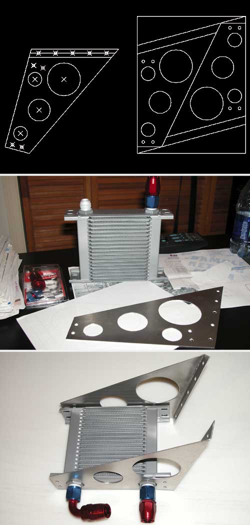

There are a pair of coolers, these brackets were 4 hour to fab, about 3.5 hours longer than I planned. Gotta do the second set sunday.
Planning on mounting coolers out back. If they work out I'll let you know. dr Attached thumbnail(s)

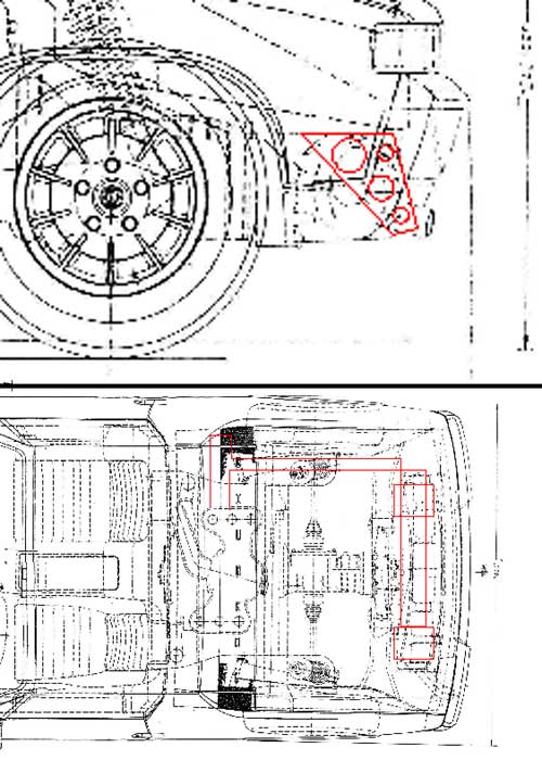

QUOTE(lagunero @ Sep 11 2004, 06:10 PM) Very nice! Out back...where? In the are where the stock muffler is located. Removed the old brackets. Don't plan on running at idle more than 1 minute, on the grid or in the pits. I think there will be quite a bit of airflow back there between 80 => 130 mph. I am prepared to move them or duct them if there is not enough cooling capacity. Won't know till she runs at speed. dr Attached image(s)

Hard to see in the pic, but are you using any rubber insulators between the mounts and the cooler?
Pieces look very nice (just like the rest of you car) |
| machina |
Sep 12 2004, 06:15 AM
#7
Advanced Member ![]() ![]() ![]() ![]() Group: Benefactors Posts: 2,030 Joined: 21-June 03 From: Miami Beach, FL Member No.: 848 |
QUOTE(Jeroen @ Sep 11 2004, 06:37 PM) Hard to see in the pic, but are you using any rubber insulators between the mounts and the cooler Yes, rubber spacers at each of the 8 mounting points. They are not in the picture, waiting on proper hardware from the UPS man. dr |
