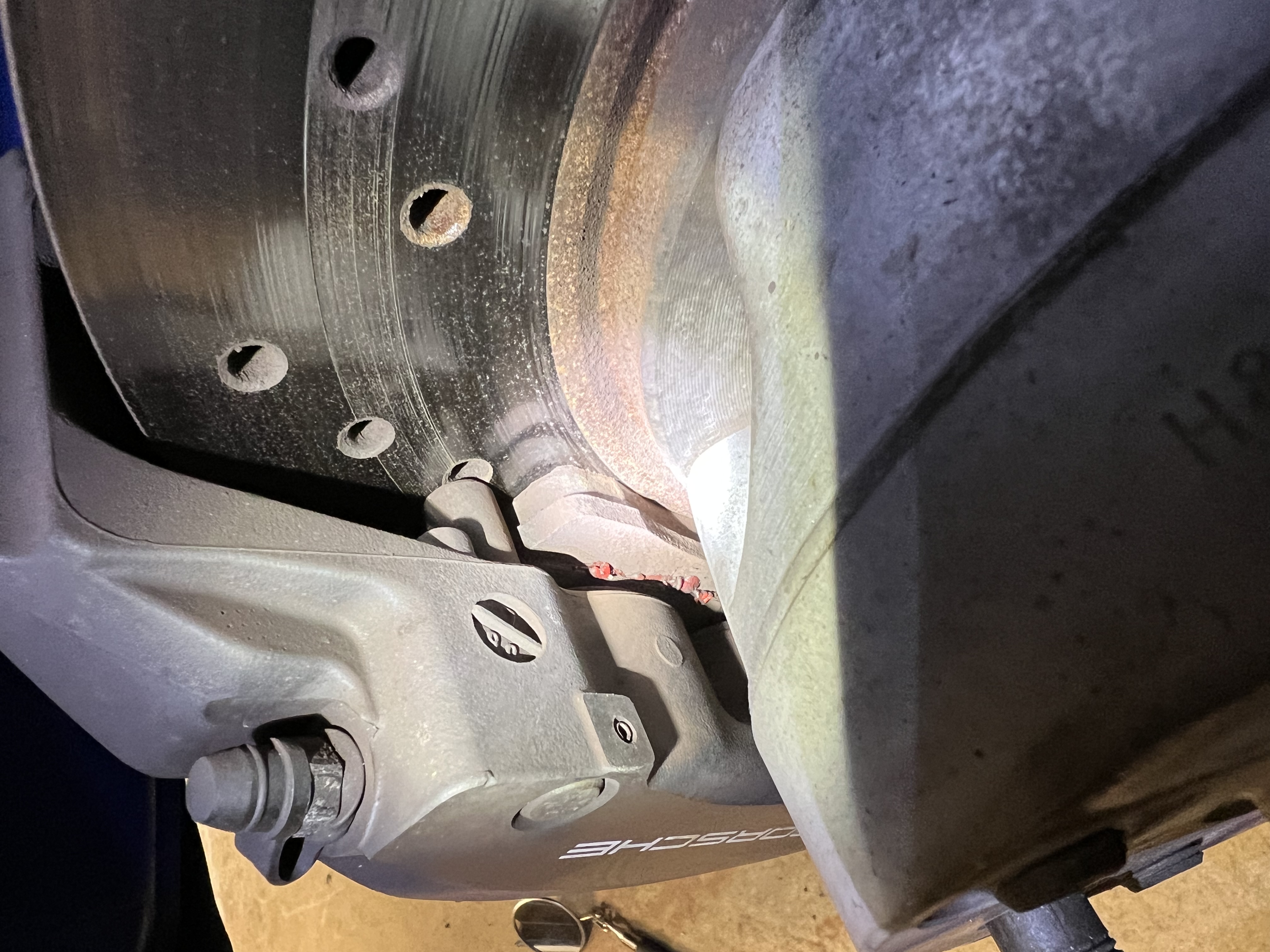

My caliper pins are rubbing on my rotor and I hope to get some advice from this group. The car is a ‘70 914/6 (factory) that was restored as a GT tribute about 15 years ago.
It is running 1st gen Boxster calipers (986-351-421) on a 911 strut (911-341-041) with a misaligned rotor, The rotor is unknown, but is 24mm thick, 11” diameter and is not centered in the caliper. It looks like I might have the wrong rotor on this set up. The questions at this point are:
1. where is this strut from
2. is the Boxster caliper an okay fit (seems spot on from what I’ve read).
3. What rotor should I be running; and
4. what modification are needed to fix the misalignment? The Caliper needs to move .06” (1.5 mm) outward so the rotor will be centered between the pins. I can’t see how one could shim the calipers in the correct direction.
Pictures to follow…

The picture above is a view of the outer side. The next picture is of the inside of the rotor. You will notice the pin is riding on the outside surface of the rotor and pics of the inside of the caliper shows the pin about 3mm away from the face of the rotor.

@davenorcal
From my first post in this thread:
First, i failed to read Rich's instructions that clearly state that you have to use a 20mm 911 SC rear rotor.
Well, i have 24mm Carrera rear rotors. The Boxster Calipers had to be machined (2mm off each of the brake pad pins) and the adapters had to be milled to center the Boxster Calipers over the wider rotors.
Post #4 and #5 in this thread show the milled down adapters to allow the calipers to be centered over the 24mm rotors.

@sirandy - Thank you. I read that and I could not visualize how inserting an adapter solved my problem. It looked to me I needed to shave 1.5mm off the face of the caliper where it seats to the flange of the strut for the caliper to go in the needed direction. Clearly, I’m missing something.
Please send pics of the back side so I might see the configuration, if possible. Thanks again!

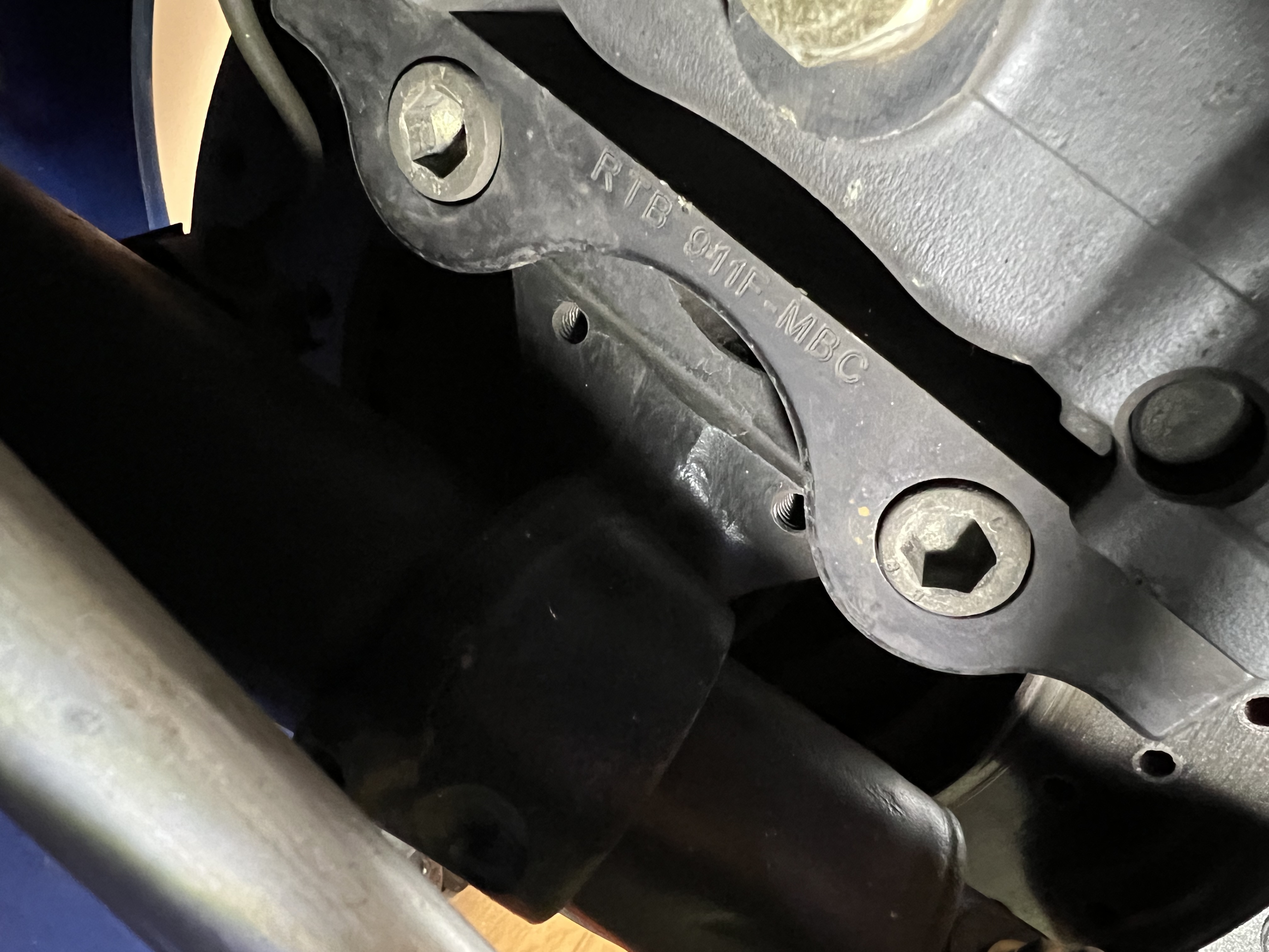

@davenorcal
You already have the adapters mounted to your calipers. I can clearly see them in your pictures.
I milled down the adapters so the calipers end up centered on the 24mm rotors.
And as mentioned, i also shaved down the pins.
PS: Yours don't appear to be the Rich's adapters, unless he has a new design. But it can't hurt to contact him anyways.

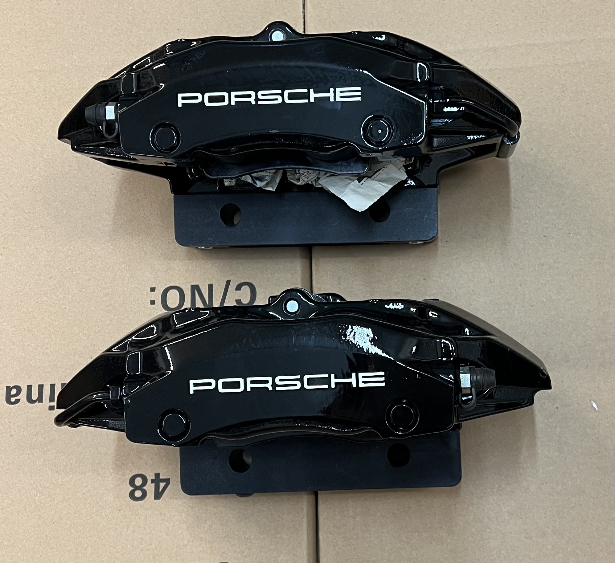

Hi Guys,
I happen to have a set of Boxster NON S calipers rebuilt by Rick several years ago with his adapters set to go on my 85 carrera front end with Elephant Polly Bronz.
Just so you guys can see what these boys look like.
Best Bob B

@sirandy - Dang, you are so right. I took pics of the back side so everyone can see them from another angle and see the left adapter is stamped “RTB 911F-MBC”. Thanks for hanging in there with me on this!
