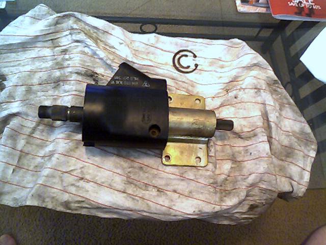

I'll do one better for ya. Here is the bottom view of a removed steering column. You can see the single 8mm(?) bolt that holds it on.

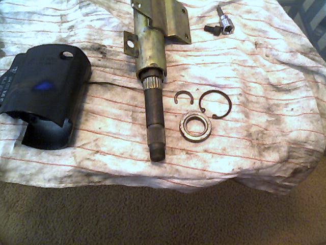

After you remove the guts (4 screws that hold in the switch assemblies), and remove the cover for the ignition switch you can slide the collar off of the shaft. In the picture is my bearing as well, but you dont need to remove this unless there is a reason.

don't touch the bearing, you don't need to. Did you remove the ignition switch? If yes then just tug on it. It is hard to get off. Just wiggle it back and forth. It is an interferance fit at this point.
