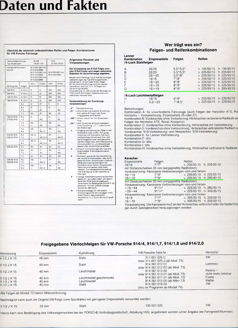

and because the proof is in the pudding ...
Ladies & Gentlemen, i present you ....
"The Pudding" !!! (look for the green lines)
