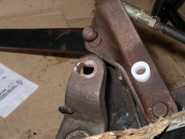

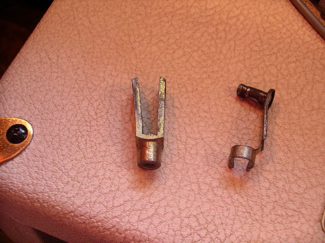

Well my "big day" turned into a lesson on "weakest link in the chain". (IMG:style_emoticons/default/headbang.gif)
While adjusting the clutch cable the "cleavis" sp? that attaches to the pedal end of the cable exploded. Closer inspection of the pedal level (where the cable attaches) revealed and shot bushing and a hole in the shape of an easter egg.
I have new parts already, but now realize that they too will be ruined if the lever is not address. As soon as I can pull the pedal assembly, I will post more pics. I have some ideas of how to repair, but need to inspect further.

Ok, here is the culprit. yikes!!! (IMG:style_emoticons/default/ohmy.gif)

I don't think my new $6 plastic bushing would last more than 1 day in there. Any ideas?
AA list a new "clutch pedal shaft" at $78. I really don't have any need to take my pedal cluster apart (PO put in bronze bushings) (IMG:style_emoticons/default/biggrin.gif) .
I am thinking of using JB Weld to fill in the gap, using the new bushing as a guide.
Comments....flame away, but at least bring suggestions. (IMG:style_emoticons/default/pray.gif)

I carefully filed down the rough edges of the hole, then inserted the new bushing. Then using a small nail i filled in the gap with JB Weld. Should have taken a pic cause it came out looking great.
I comtemplated replacing the whole pedal assy but since it already had brass bushings, this was worth a try. Time will tell.
