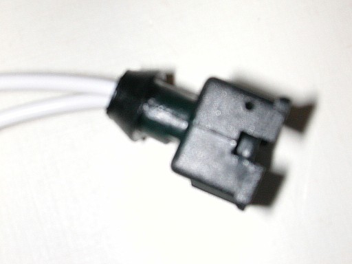

My #4 fuel injector connector on my '70 1.7 is routinely coming loose and falling out of the injector. I'd like to get a new connector to put onto my harness. Anyone know where I can get these? I'd rather not have to solder to the injector connector tabs (IMG:style_emoticons/default/wacko.gif)

Punching in MSD-2400 at Summit racing gets you 8 of these for $15
(IMG:http://static.summitracing.com/global/images/prod/large/msd-2400.jpg)
That's what I'm going to use for my 914-6 and to convert my V8 Volvo to megasquirt.
Backordered till 10/3 right now though...

I'm not certain those connectors will work on D-Jet injectors. Remember these are OLD injectors, some of the first commerically available EFI injectors. The normal D-Jet connector fits entirely inside the injector's connector housing, it doesn't go around it on the outside. The connectors should should probably work on L-Jet injectors, and on newer injectors from other makes. D-Jet injectors, however, have a different connector.
Sorry, I don't know where you can get the correct connector. Jeff Bowlsby (see vendor's section) refurbishes injector harnesses, so you should probably contact him.

Those will work. 100% If it makes you feel better, you can cut/grind off the outer shield. They will work.

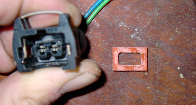

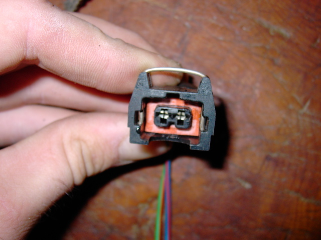

Nope. They fit just fine. The retention system has changed somewhat over the years, but the lip on the outer edge of the injector connector is more than enough to keep the clip in place.

QUOTE(markd@mac.com @ Sep 17 2004, 06:15 PM)
Mark, you couldn't have been a little bit quicker? I had to go out to the garage, IN THE RAIN, to get these pics. (IMG:style_emoticons/default/biggrin.gif)

I stand corrected, and happily, too. Those new connectors are waterproof, and the early ones, aren't.

Anything will work if you want it too bad enough. Why not use the correct parts? They are all available.
The D-Jet FI hardware works just fine if its maintained and not abused. The plastic housings, wire terminals and boots are made to fit the D-Jet injectors and the rubber boots fit snugly over the whole connection to keep it water tight. This simple system has its weaknesses, but its quite serviceable and reliable.
L-Jet hardware is one of the major improvements to FI systems over D-Jet in that everything in that system was rethought and improved. Its watertight too, if maintained, as there is a gasket internal to the housings where they mate and the rubber boot only attaches to the outer housing. It has a cool spring clip on the housing and uses springclip wire terminals to fight loosening from vibration. The system is still used today on nearly every contemporary FI system in existence its that good.
But putting the outer L-Jet housing over the inner D-Jet fitting on the injectors does not give you a reliable connection. Notice how the L-Jet outer housing has to be turned upside down to fit the injectors and there is a big gap between the fittings? Liquids, dirt and corrosion will still find their way into that feeble arrangement and then you not only have a dirty unreliable condition...you've hacked into your harness with non-standard, modified parts. Mechanics freak out when they see this nonsense...if they will even touch your car after seeing those games. Whats even worse...the future owner of your car will be calling you the DPO... (IMG:style_emoticons/default/sad.gif)
I don't understand why people even consider hacking these cars and their parts when the job can be done correctly with the correct parts. 'Upgrades' are another matter...this is not an upgrade. Respect these cars and they will perform for you, hack 'em and they may leave you walkin'. (IMG:style_emoticons/default/rolleyes.gif)

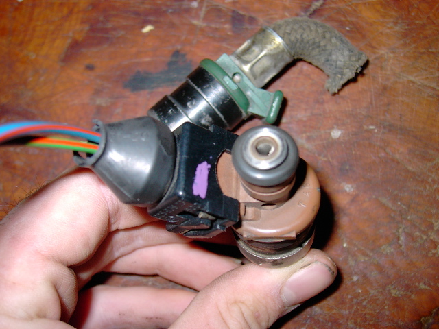

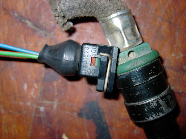

QUOTE(bowlsby @ Sep 17 2004, 11:48 PM)
Actually, the fitting is installed right side up, there's a notch cut into to clips to fit the fuel barbs, so they only install one way. Here's the clip installed on one of my coveted browntop injectors

For the sealing, no the outer connector seal does not mate with the connector and seal it as well as the l-jet it was designed for. If you were concerned about it you could probably make a pretty functional boot out of some 3:1 heat shrink, double up on the seals, or like I did install a thicker seal from a similar style clip. I think the ones I used were off a TPS harness for a Subaru Impreza. Pic #1

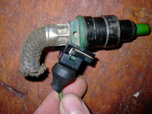

post Sep 17 2004, 11:05 PM
Master of Clueless Posts
Posts: 310
Joined: 12-October 03
From: State College, PA
Member No.: 1,238
The connector is pretty much the same as the bosch clip, so it drops right in:

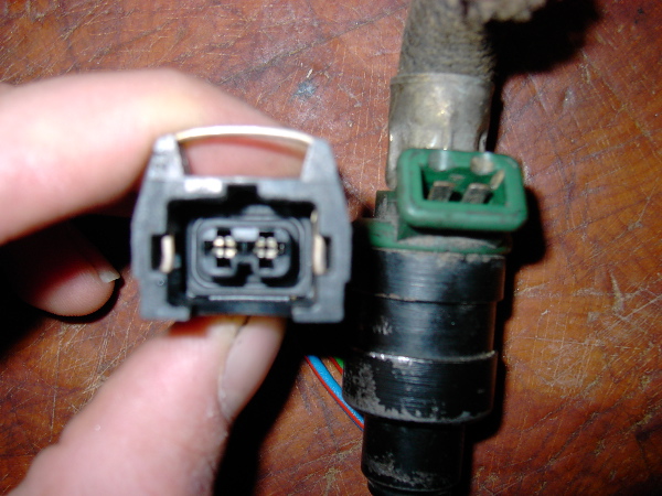

post Sep 17 2004, 11:18 PM
Posts: 310
Member No.: 1,238
The seal is a good bit thicker than the normal one, so when installed the seal is compressed quite nicely, in this pic the connector isn't even fully pressed on. Yes, it's not perfect, and a solution in search of a problem, but I feel the connection is tight and secure--unlike the old djet connectors, which would pop off with the merest bump. Granted they are 30 years old, and new ones would likely have fit quite snugly, but I had these on hand, didn't know where to procure the djet connectors, and didn't want to hack up my brother's stock harness to fabricate the new MS one.

Jeff: I would prefer to use the correct connector, but you offer no advice on where to procure such connectors. Furthermore, I wonder how many people have actual intact rubber boots on their injectors after 35 years (that is, boots with some remaining elasticity and no cracks). So maybe these are available new somewhere too?
So I agree that using the right part is usually preferable to hacking something up. I think one of the reasons people do this kind of stuff (and I hate it) is because of ignorance. In my case, and it seems others, there is ignorance on where to get these components. This ignorance could be corrected, and I think one of the biggest successes of this forum is to spread knowledge like this.
Anyway, unless I find a source for the CORRECT connectors I'll probably take 3liter's advice, as it seems fairly well thought out.

hmm.. I'm not sure I actually want people taking my advice...kinda scary if I think about it. I'd bet that since Jeff says they're available, you can probably get them at a Porsche or VW dealer (maybe Volvo as well), or maybe from a WorldPac distributor, they seem to have a lot of handy stuff. If you're interested, I can send you the clip with seal from the photograph, and you can determine for yourself whether you're comfortable with the way the connector fits and seals.

You can get the original D-jet type connectors...go to an import parts place and look in the back of the Beck-Arnley catalog.
You can get pigtails, plugs and connectors...I don't remember the part # right now, but I think it is like 14-156 or something.
I had to have the parts mailed to me as they were not in stock. Took a couple of days.
This was last fall, so should still be valid

Napa has the D-Jet connectors, part no. 2-17424. That said, here is what I did...
Used the new style connectors and cut off the extended part of the housing. Drilled a small hole through both sides just behind where the raised lip of the injector sits inside when installed. Found these clips at the hardware store that fit through to lock the connector and prevent it from pulling off the injector. Also found at Napa a Bosch boot (2-18414) that fits these connectors. Makes a clean install. Here's some pics:
