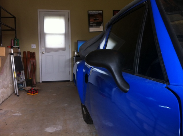

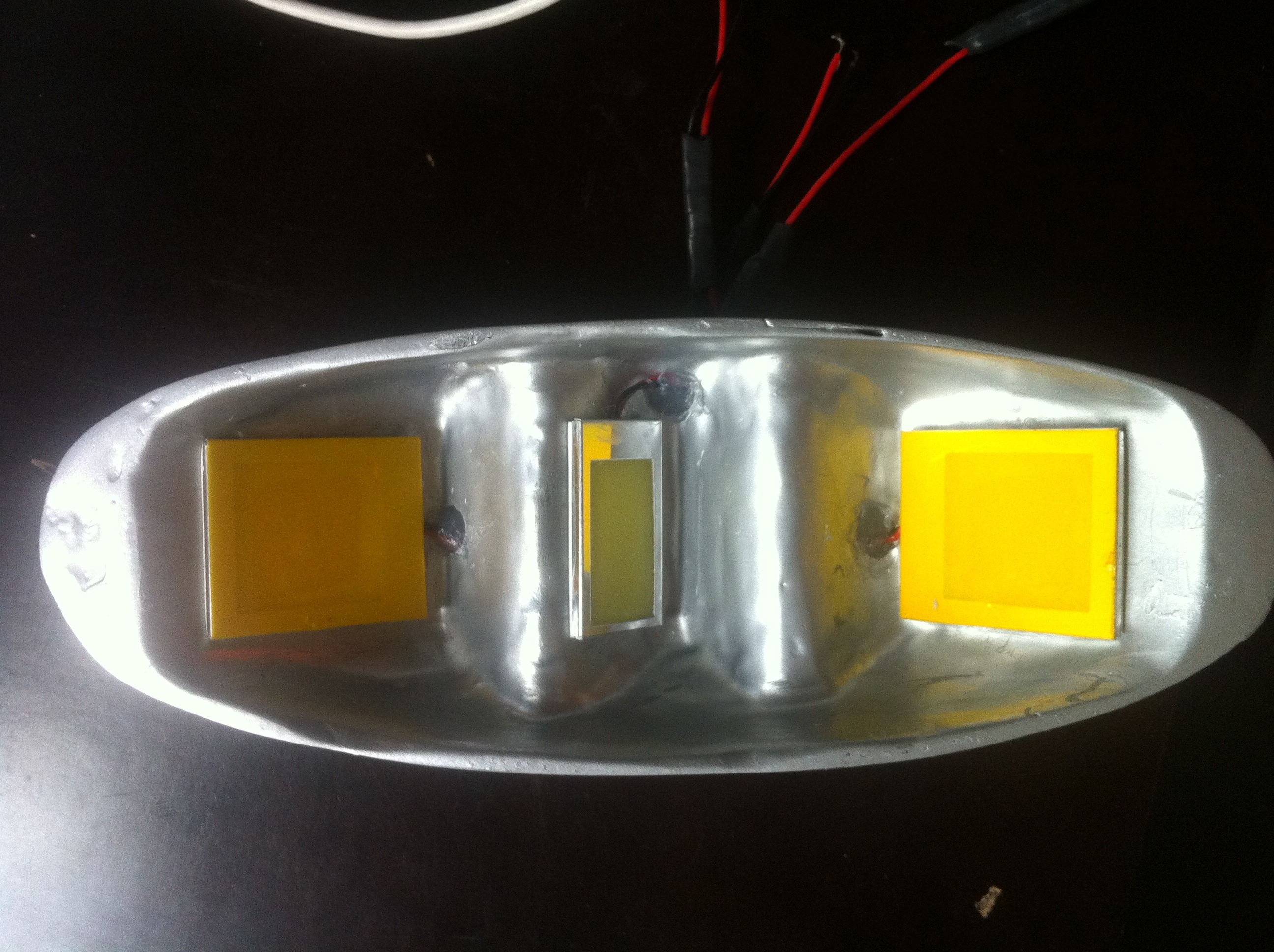

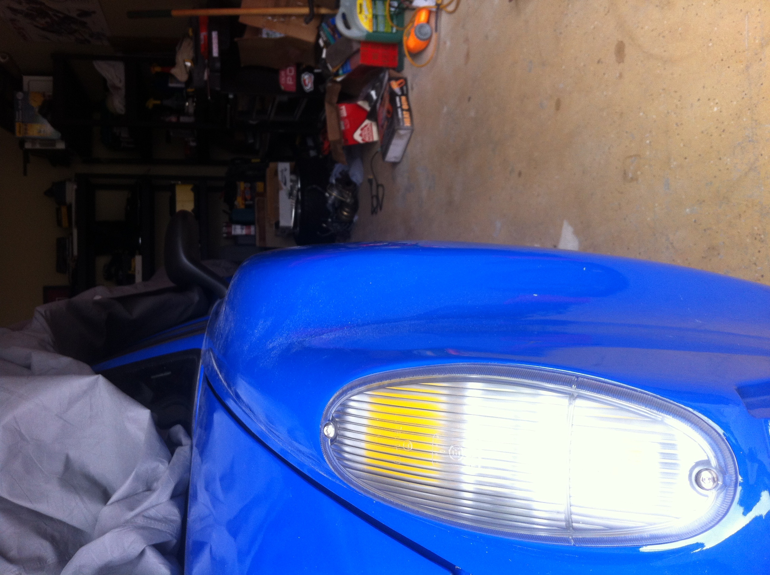

A little progress.
Drivers mirror mounted.
Turn buckets complete.
New flat LED turn and running light installed.
Ordering lenses tomorrow!

Thank you Mark! The smoke turn lenses are beautiful! i think the smoked turn covers will need a media blast and 1 more layer of black color to create the Semi gloss I am going for.
Mirrors in their housing.

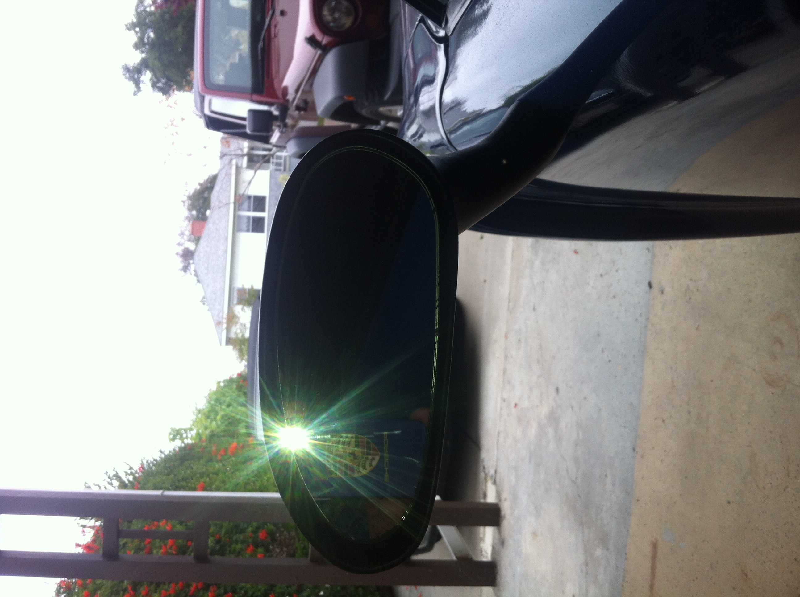

Mirror

The Porsche crest is from my iPhone cover. I totally missed that when I uploaded the picture.
