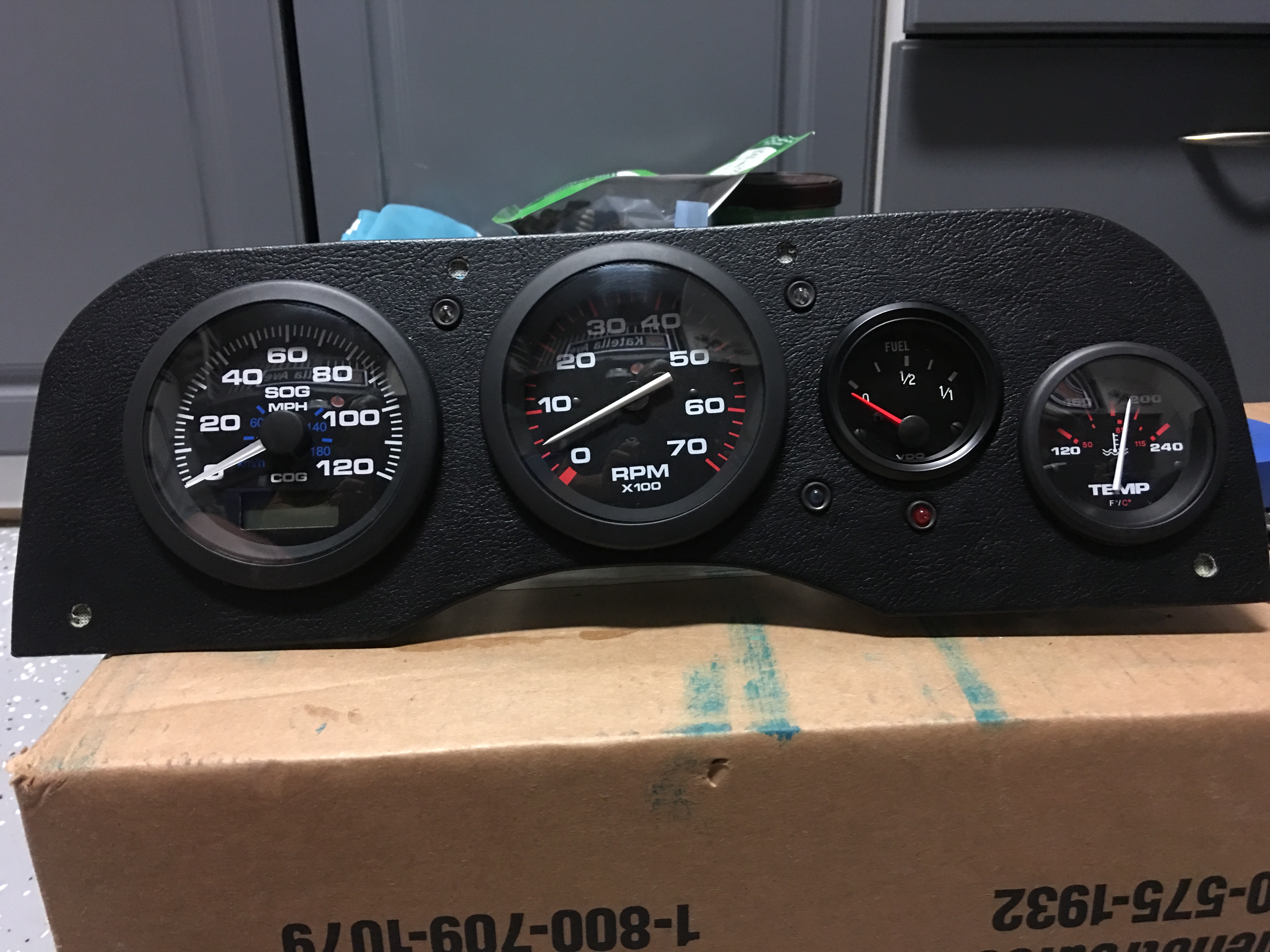

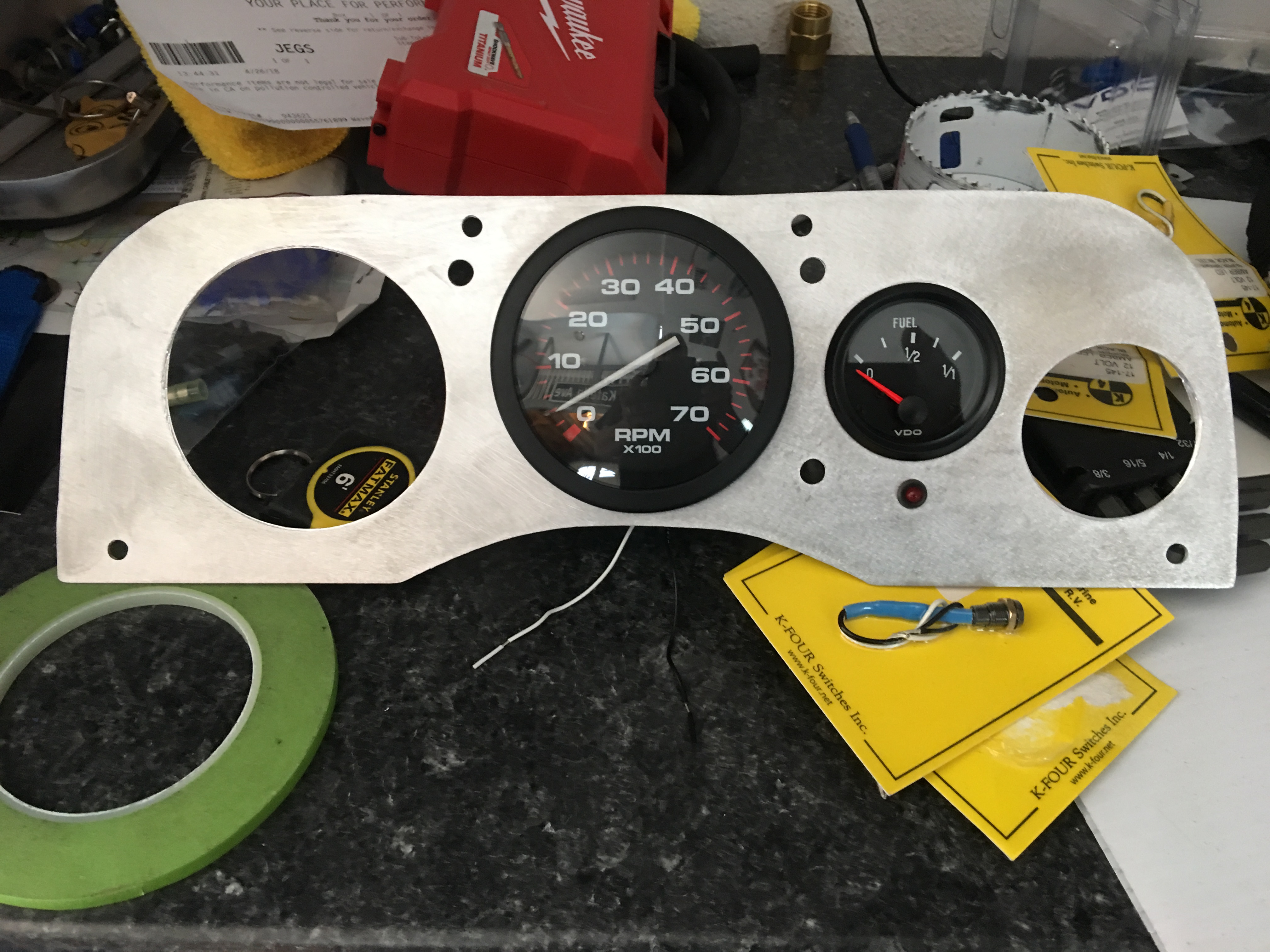

Gauge placement phase 2
effutuo101
post Apr 29 2018, 05:34 PM
Post #342
Posts: 2,738
Joined: 10-April 05
From: Lemon Grove
Member No.: 3,914
Almost read tit install. Hav to adjust st them.
Andyrew
post Apr 30 2018, 09:00 AM
Post #343
Spooling.... Please wait
Posts: 13,380
Joined: 20-January 03
From: Riverbank, Ca
Member No.: 172
Only a 120mph speedo? Seems a bit low?
Clear and nice guages though, I like the face print on the surround!

Costa05
post Apr 30 2018, 08:00 PM
Post #345
Posts: 320
Joined: 27-October 16
From: Phoenix, Arizona
Member No.: 20,535
QUOTE(effutuo101 @ Apr 29 2018, 06:34 PM) *
Nice looking gauges. What kind are the speedo and tach?

QUOTE(effutuo101 @ Apr 30 2018, 06:36 PM) *
QUOTE(Andyrew @ Apr 30 2018, 08:00 AM) *
Yep. GPS speedo. Above 100 is go to jail go directly to jail, do not pass go.
(IMG:style_emoticons/default/happy11.gif)
But Willow springs is right near you and that's probably a 130-140mph course!
effutuo101
post Apr 30 2018, 10:11 PM
Post #347
Posts: 2,738
Joined: 10-April 05
From: Lemon Grove
Member No.: 3,914
QUOTE(Costa05 @ Apr 30 2018, 07:00 PM) *
Sierra Marine grade gauges. Figured water and impact resistant. Why not?

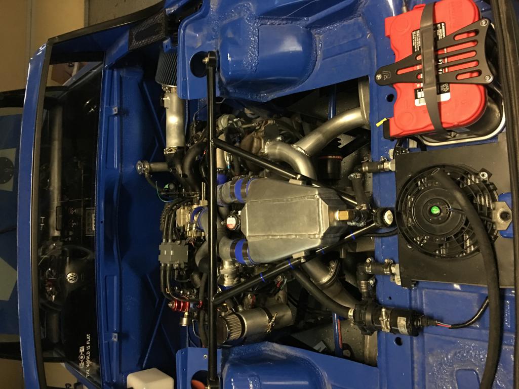

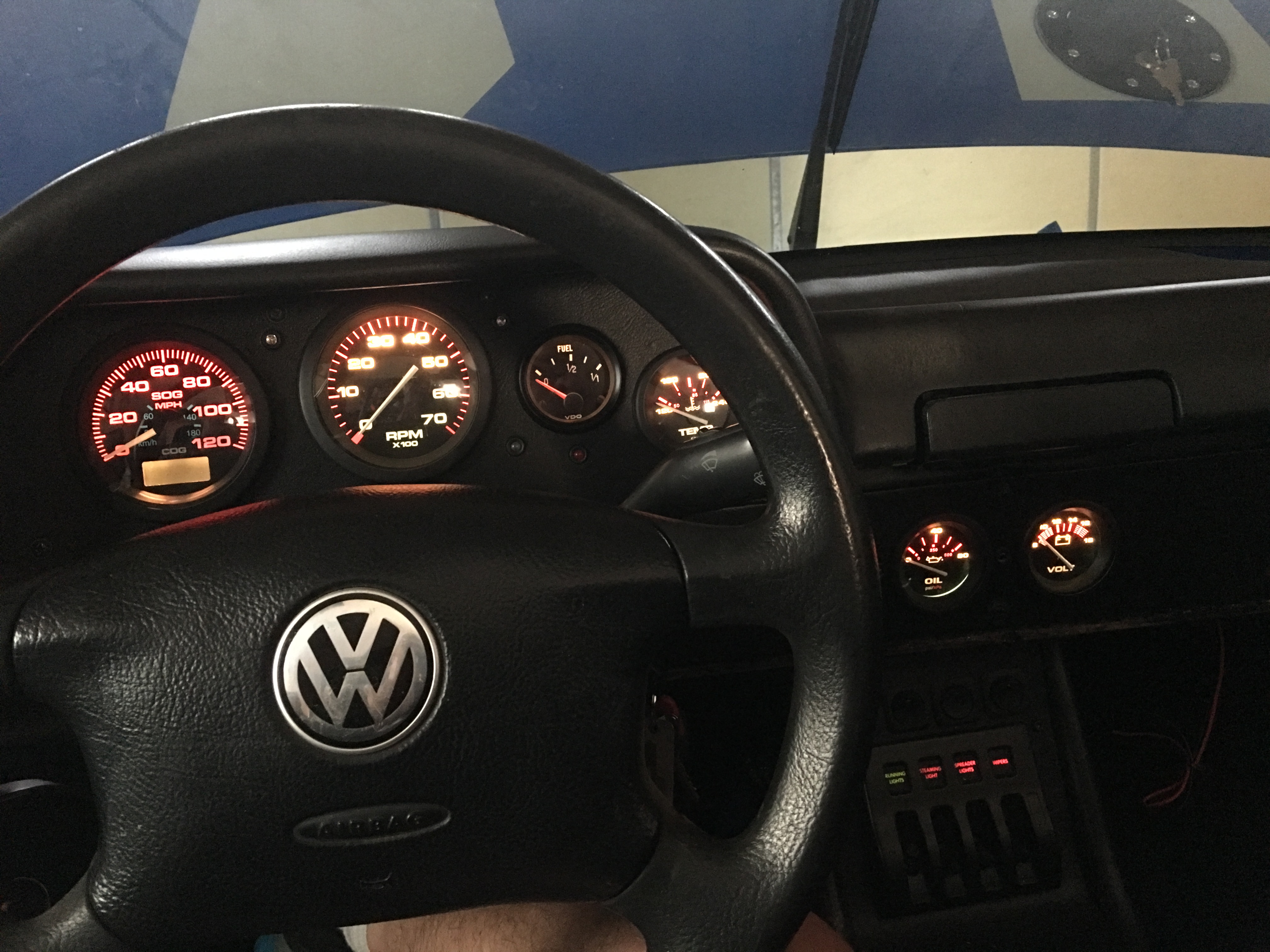

effutuo101
post May 2 2018, 08:08 PM
Post #352
Posts: 2,738
Joined: 10-April 05
From: Lemon Grove
Member No.: 3,914
A couple of bolts and fix the alternator plug wire.
Fuel system final check, gas guage final wiring for sender and low fuel light.. Fuel and coolant filling and pressure test.
Final nut and bolt for all go systems.
Final wiring check of all systems.
Swap out rear brakes with my new PMB ones and bleed.
What am I forgetting?
To do: dyno, put hoods back on, Alignment, mirrors, sea belts, plates, insurance... I have to be missing something.

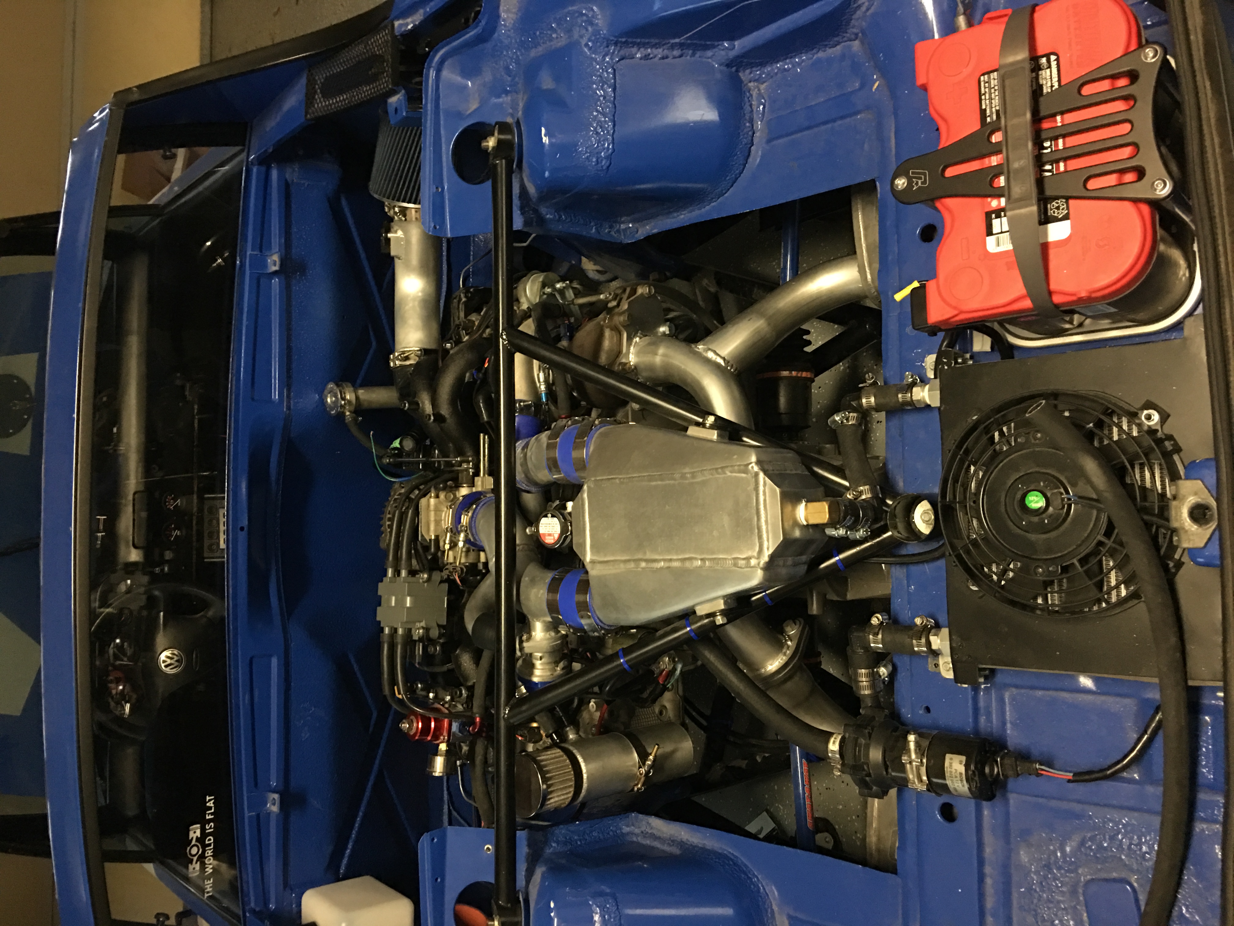

effutuo101
post May 3 2018, 02:20 PM
Post #354
Posts: 2,738
Joined: 10-April 05
From: Lemon Grove
Member No.: 3,914
Coolant in, leaks fixed.
Rear calipers swapped for new PMB calipers. Need the bleed.
Time to go get a gas can and get some gas....

post May 4 2018, 11:52 AM
Post #357
Posts: 2,738
Joined: 10-April 05
From: Lemon Grove
Member No.: 3,914
@Rich, really gut?
Thanks!
Fuel pressure tested to 60 lbs. for 10 minutes. Nothing broke or spewed has. Nice leaks.
