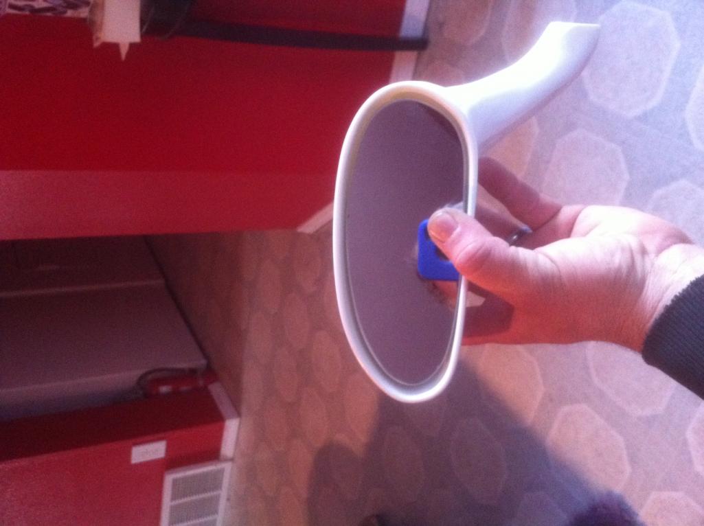

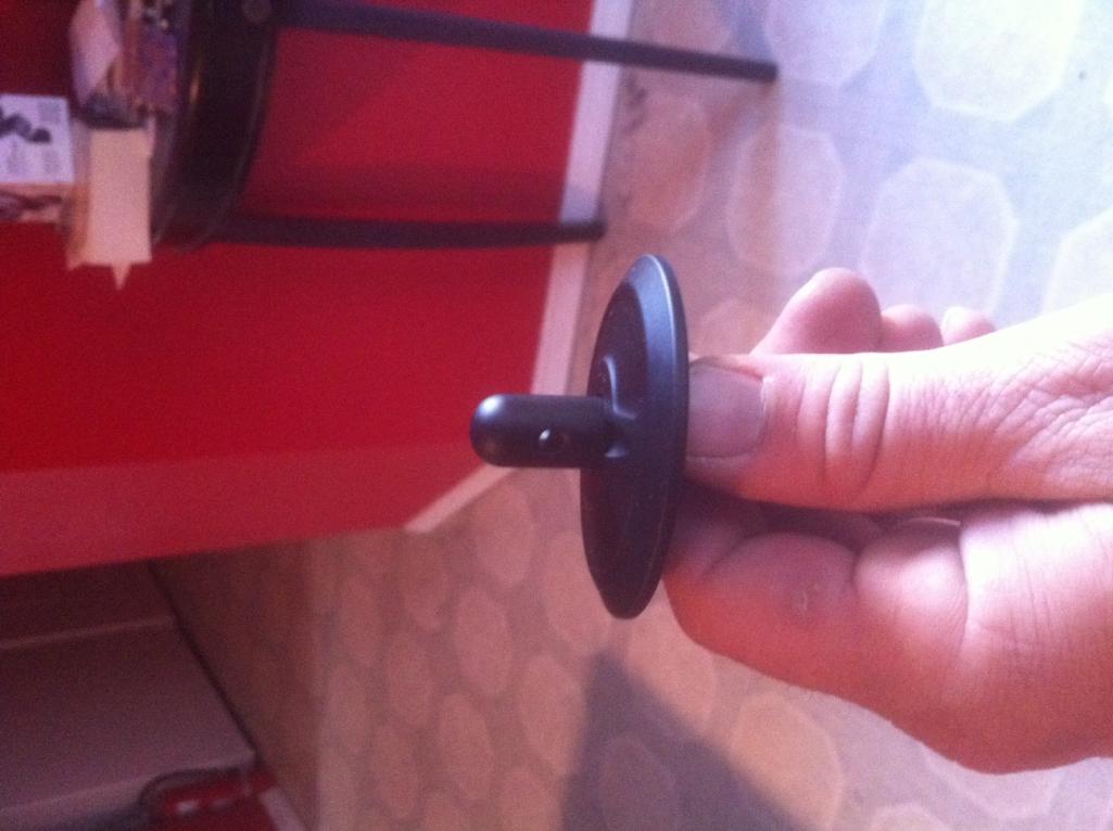

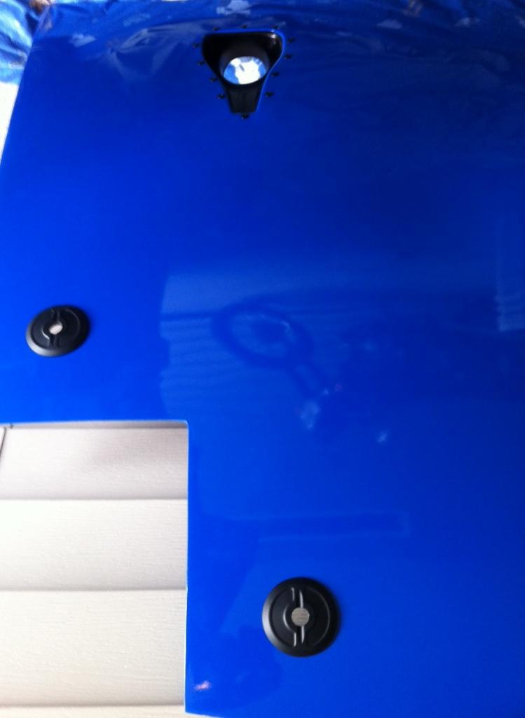

effutuo101   hood pins and mirrors showed up... I guess I will ...   Mar 23 2012, 05:59 PM
pete-stevers   where did you get those hood pins from??   Mar 23 2012, 08:12 PM
dakotaewing   What kind of mirrors?   Mar 23 2012, 09:13 PM
effutuo101   I got them bot from "dreamers" (local ho...   Mar 23 2012, 10:42 PM
effutuo101   The mirrors are Vision out of Canada. VF4 http://v...   Mar 24 2012, 09:18 AM
effutuo101   hood pins are Eddie Motorsports. they come in a te...   Mar 26 2012, 09:43 AM

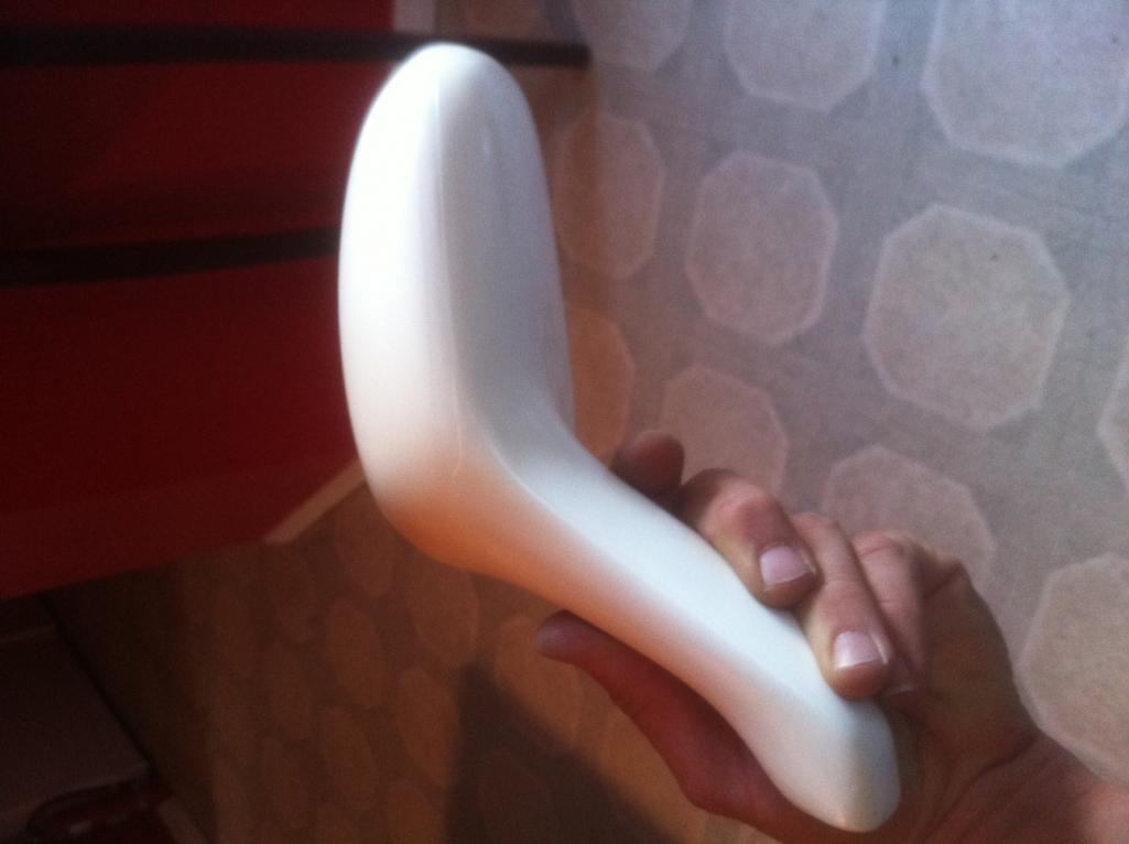

effutuo101   start mirrors   Apr 9 2012, 04:33 PM
effutuo101   lunch time work... :stir:   Apr 9 2012, 04:35 PM

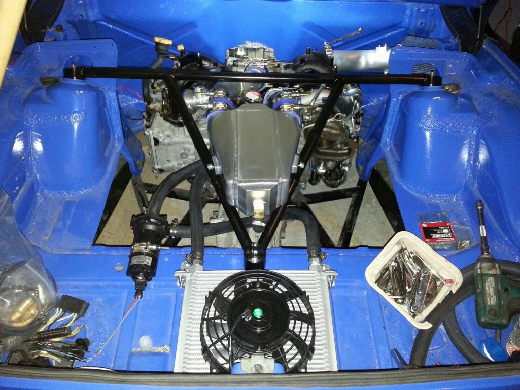

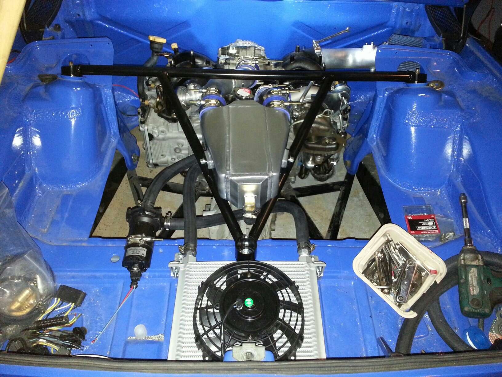

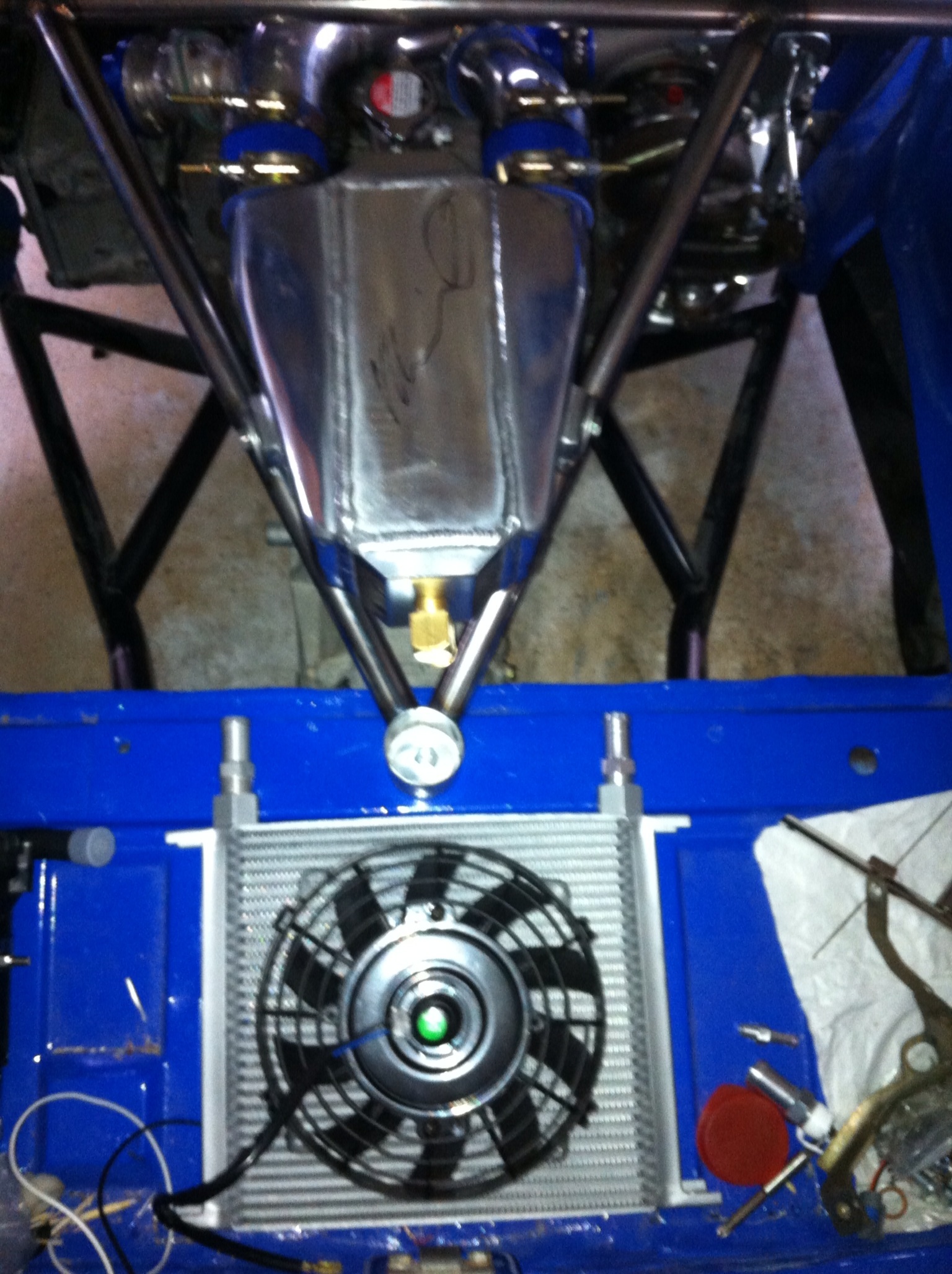

effutuo101   not much posting, but some progress picked up my c...   Apr 23 2012, 01:04 PM
IM101   not much posting, but some progress picked up my ...   Apr 24 2012, 01:27 PM
sixnotfour   Where is the blood pool picture from your 914 cutt...   Apr 23 2012, 10:21 PM
sixnotfour   Doesn't your cowl look more like this now ??   Apr 23 2012, 10:32 PM
effutuo101   Not yet, got the grinding done yesterday. primer a...   Apr 24 2012, 08:52 AM
ruby914   Looking good Chris. Nice cradle, hats off to Ian f...   Apr 24 2012, 10:37 AM
effutuo101   Thanks, No, not a suby cluster. gauge cluster on w...   Apr 24 2012, 11:33 AM
