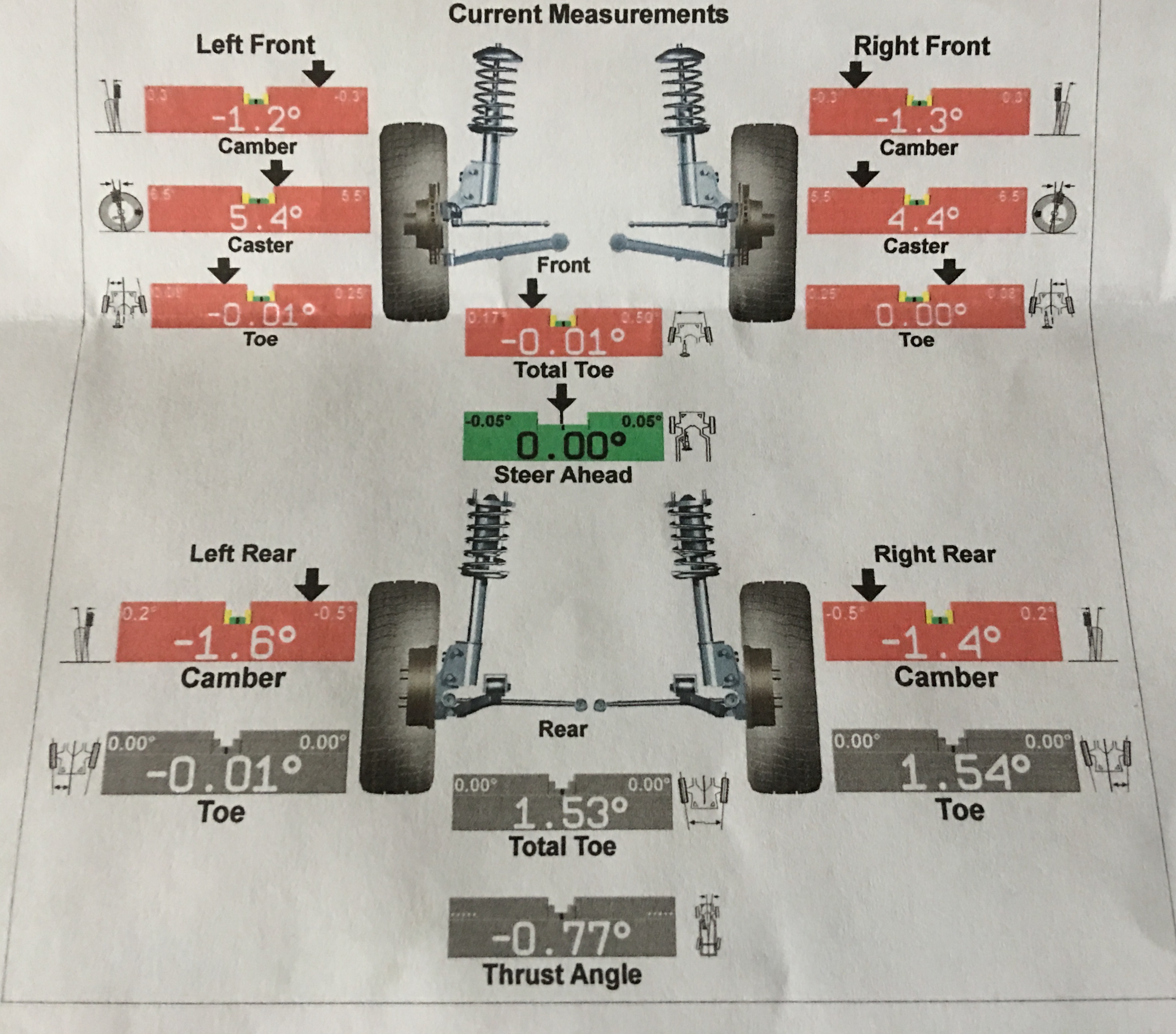

3 days at alignment with specifics provided and this is what I get back.
Any ideas on the passenger rear? The toe in was the most they could get.

right rear is good left rear ??
https://robrobinette.com/ConvertToeInchesToDegrees.htm

Confirm that the rear tires are centered on the chassis. I had the PorSTI aligned at a "hot rod" shop that did not understand the suspension and had the rear shifted to one side with similar results.
After much fussing a quick measurement from the wheels to the chassis revealed the (IMG:style_emoticons/default/stromberg.gif)

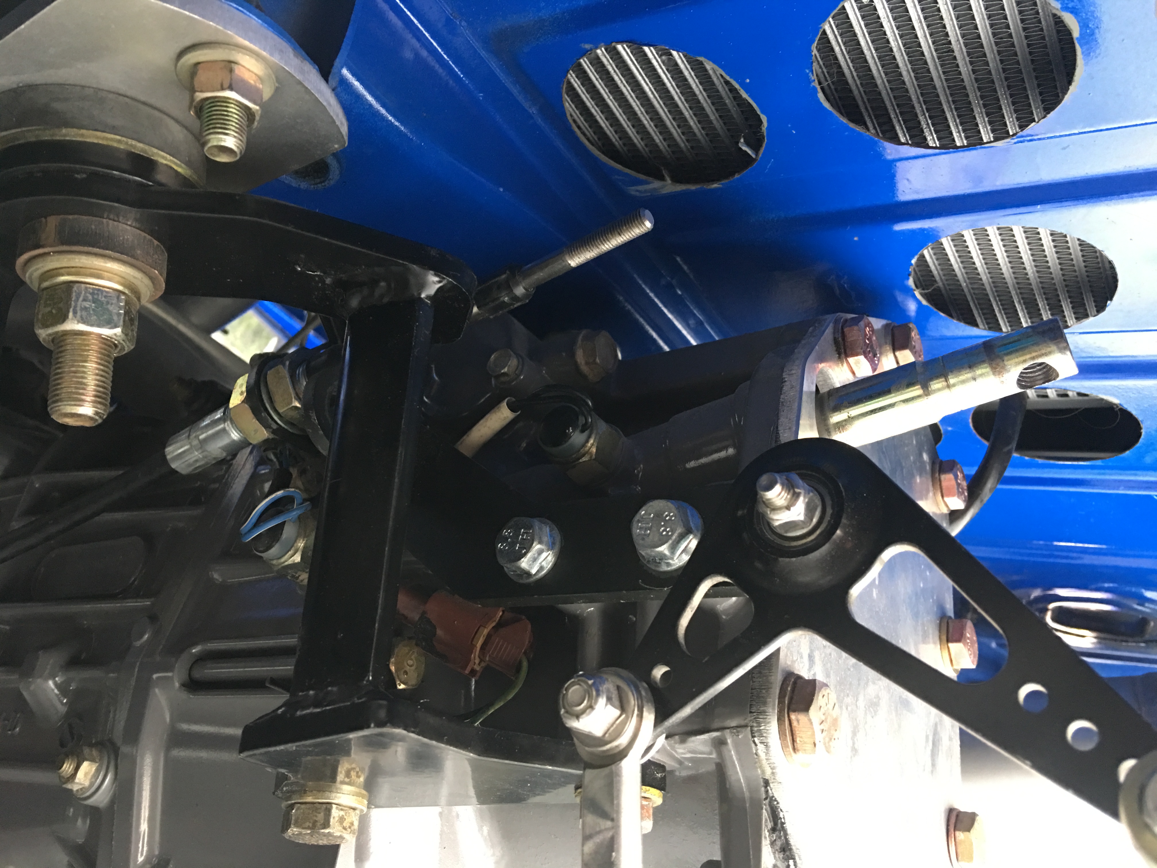

First upgrade.
Shifting mechanism. Out with the old!

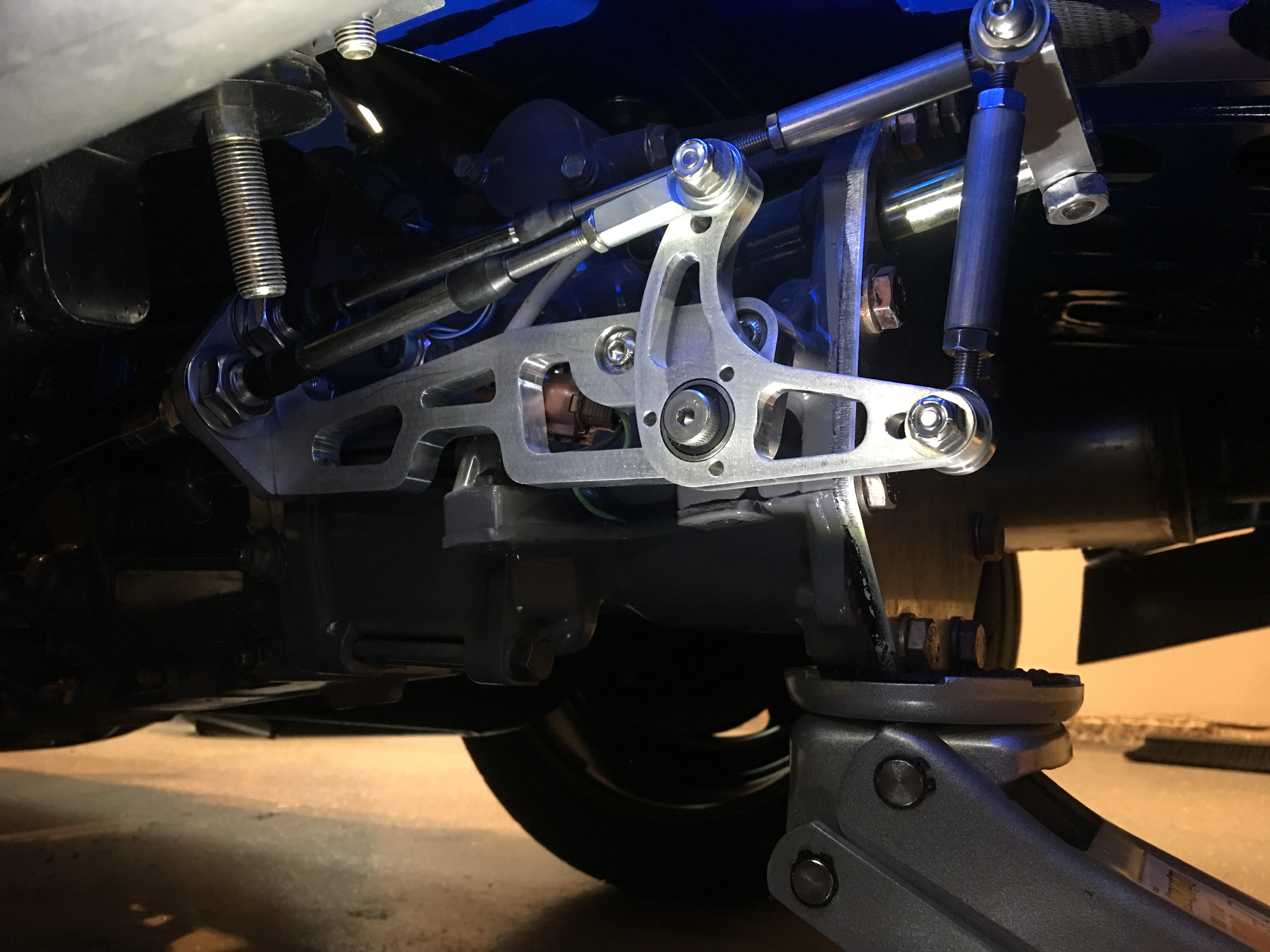

effutuo101
post Jan 17 2019, 04:05 PM
Post #418
Posts: 2,738
Joined: 10-April 05
From: Lemon Grove
Member No.: 3,914
In with the new!
Zero decibel motorsports.
Geometry now looks much better.

Did you reuse the cables from the cold water kit or did you get new ones?
