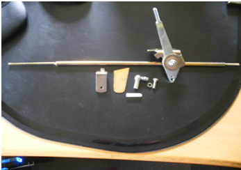

What you need:
1x Handgaslever set
Tools
10mm Hexnut
13mm Hexnut

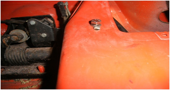

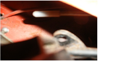

Mark the position of the shift rod
This will be the easy way to meet the right position in the reassembling phase
Loosen the screw and pull out the shift rod
Now remove the 3 screws from the shifter and pull out the shifter
Remove the black knob from the lever arm

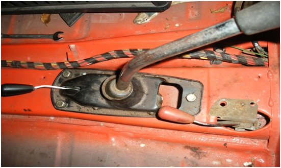

Slide the lever arm through the front slot on the shifter bracket
Mikey914

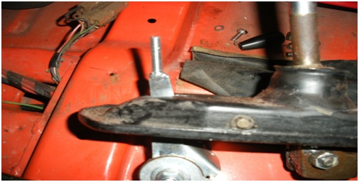

Install the bracket for the push rod
Be sure that’s the bracket is in place like the picture shows

After removing the front cap of the push rod place the shifter and the lever arm
back in place.
Be sure that the bracket in is the right position the bore of the shifter bracket must meet the bore of the bracket and the small pin in the lever arm bracket must fit the small bore in the shifter bracket.
At this point you must also thread the push rod front end in the bore
of the installed bracket.
