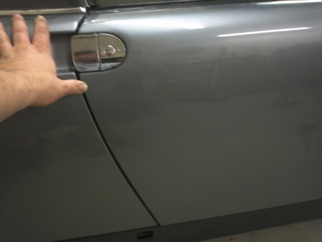

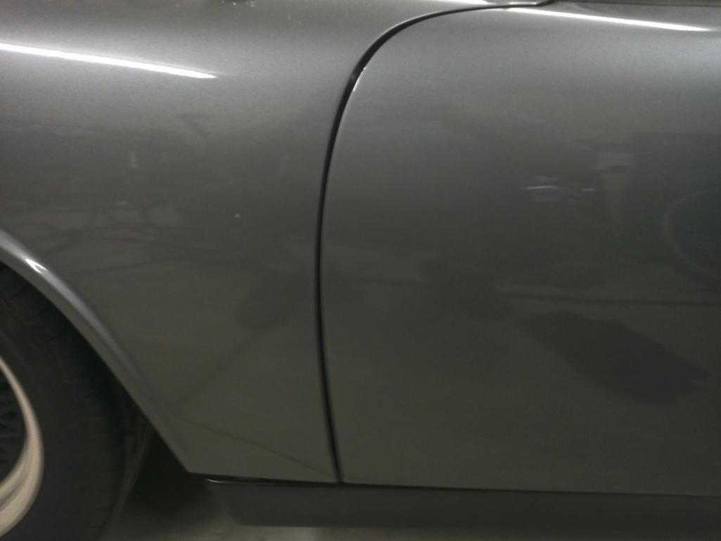

A few years ago I got a new welder, I welded everthing in site... Needless to say I never understood shrinkage.
I installed an Engman kit and not only did I rosette weld the kit in, I fully stiched the whole thing. The end result, a stiff chassis - but a bent tub.

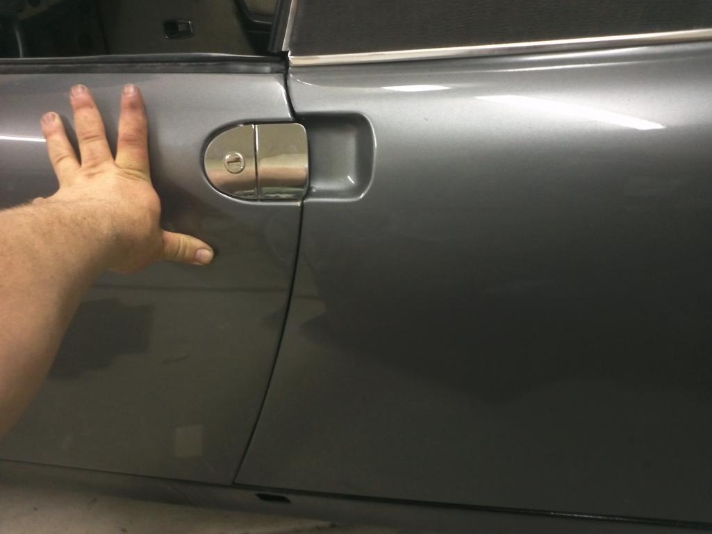

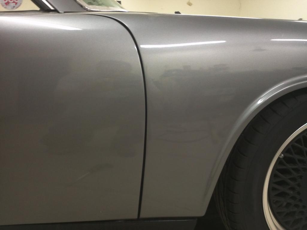

My door gaps are totally fuquered. My passenger rear fender was replaced and they must have welded the front, then the back and I have a weird bubble in my fender well. So not everthing is the same.. My passenger side gap has been messed up since I got the car, huge gap at the back of the door.
Here's my measurements, not to be reconciled with the factor charts too much, I am sure I am measuring from different dimensions than that. Anyways my measurements are from the same spots side to side
Targa opening D 62.7, P 63.5 CM
Latch to hinge D 110.5, P 110.5 CM
Diag mid latch plate to top of targa D 109.4, P 108.4
Front bulkead to targa, D 42.6, P 141.5
My guess is:
the passenger cowl fell in, so did the drivers side

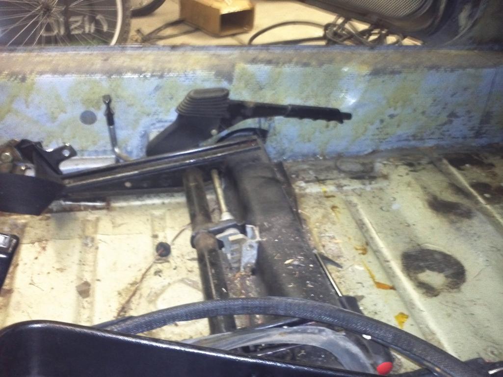

The drivers targa fell in, passenger stayed staticd (lots of welding on the e-brake area)
Pics to follow....

So the front cowl has definately fell in. The rear targa bar on the drivers side, I think fell in too. I remember having to reaseal the rear window after my welding extravaganza
Seals and stricker plates are out of the doors. You would think there are more issues on the driver side with the tight gap, measurements prove it's the passenger side with the biggest problem

Anywho, The photos show the issue pretty well. If you were closer I would drive over and tweek it for you. But for now all I can suggest is to do your best and try to un-do the issue.
Normally You could tweek the chassis with a port-o-power or my turnbuckle tool like John's car. But after the chassis stiffeners are welded when you try to push the chassis it bends in places it most likely shouldn't. This only makes matters worse.
So what I would suggest is to figure out where you went wrong and back up to that point. This may require cutting through the stiffener to weaken the car enough to bend it back in place.

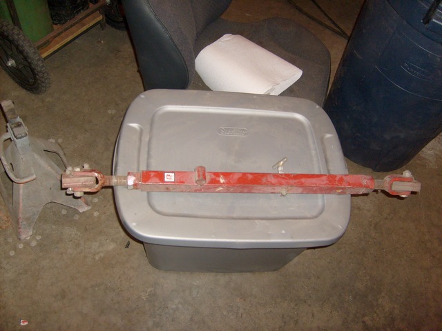

This tool works very well. If you want I'll put it in a cardboard tube and ship to you. You pay shipping both ways. It's heavy and shipping won't be cheap.
My second suggestion would be to see if there is a local body shop that has one and would either loan or rent it to you. You can move a door opening with very little effort.

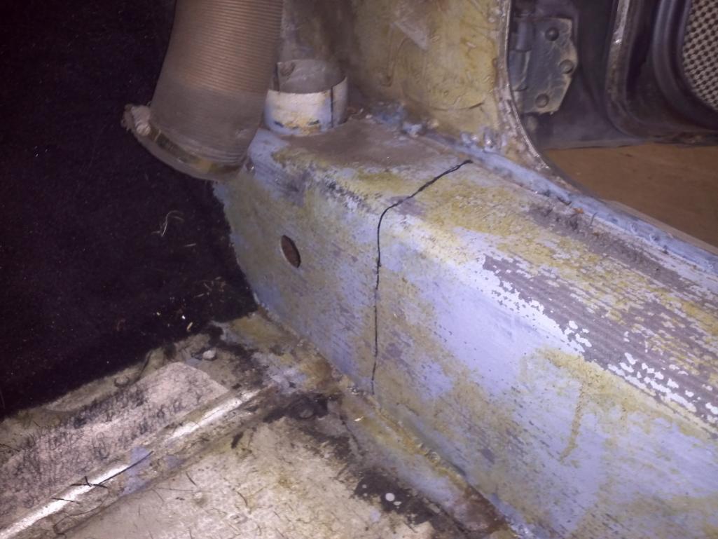

So I will make my cuts here in the front

Show me the stiffeners. I would likely cut the stiffeners not the stock inner longs.
Eric_Shea
post Mar 18 2012, 09:53 PM
PMB Performance
Posts: 19,304
Joined: 3-September 03
From: Salt Lake City, UT
Member No.: 1,110
That is the stiffener...
TravisNeff
post Mar 18 2012, 09:58 PM
Posts: 5,082
Joined: 20-March 03
From: Mesa, AZ
Member No.: 447
LOL, you're looking right at them. i did my best to make it look like i never installed one - and yes, i would only cut through the stiffener and not through the longs.
