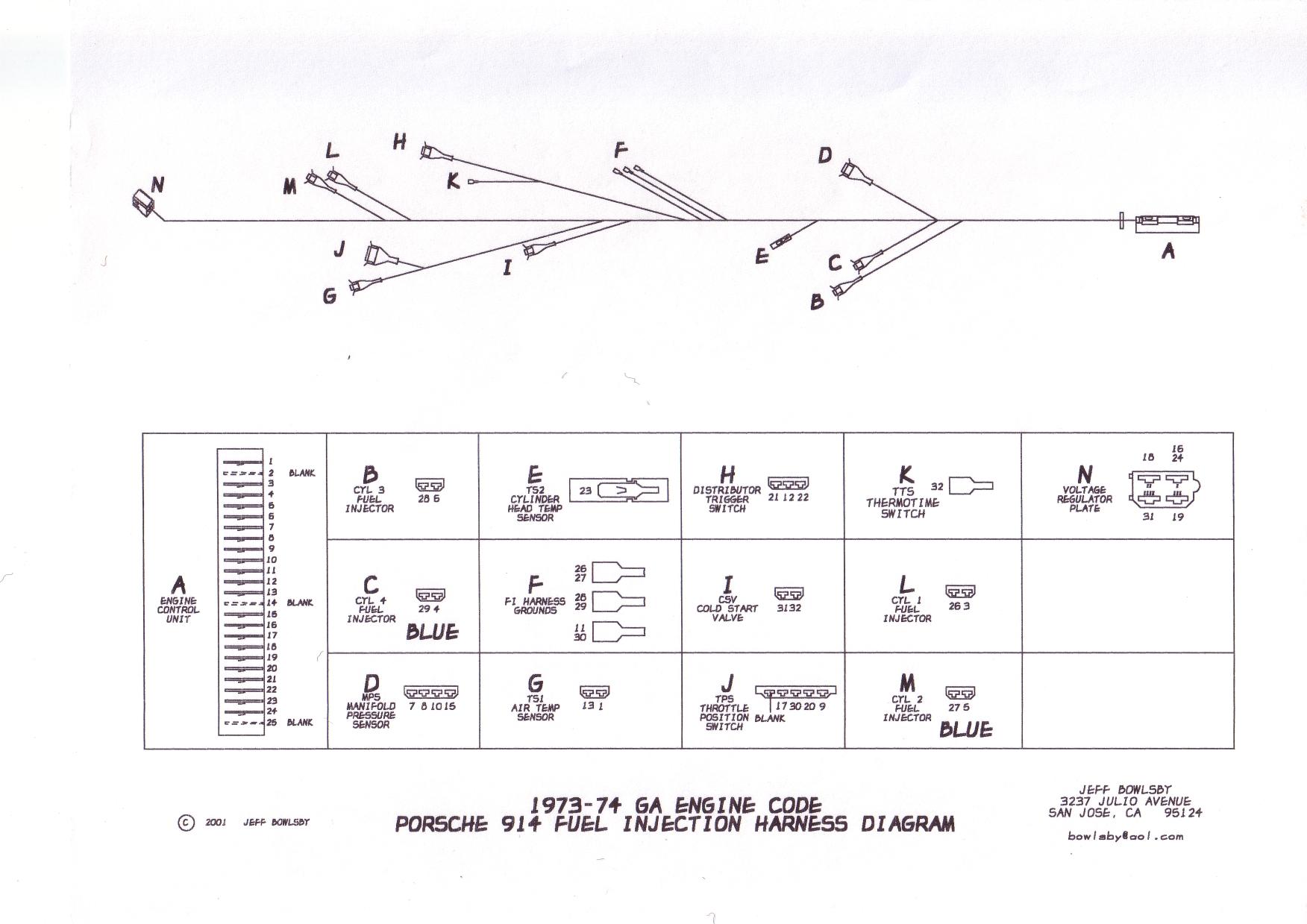

So I tried starting up the beast after 2 years and I put everything back to stock.
When I fired it up,it ran like crap! Wouldn't idle and just sounded like garbage.
New plugs and wires,new fuel lines,filters and vacuum lines.
So I started checking all connection and bingo! Broken wire on the CSV harness ,had been repaired before.
Only issue,when I pulled off the electric tape the connectors dropped out of the plastic plug holder.
So,does it matter which wire goes where? If so,how do you know....both wires in the harness are white. (IMG:style_emoticons/default/confused24.gif)

Found it! BOWLSBY......YOU ROCK.
Your GA Harness diagram was perfect for what I needed.
Thanks JEFF (IMG:style_emoticons/default/pray.gif) (IMG:style_emoticons/default/pray.gif)

Uhhhhhhhhhhhhhhhhhhhhh, there's only ONE wire to the CHT sensor.
Well, don't I feel stupid. "CSV" harness. Ok, 2 wires, yes it matters, and Jeff's diagram is well suited to aiding you in the repair. However, most of us never start the car under conditions where the CSV actually activates, so the question is somewhat moot.

JeffBowlsby
post Mar 30 2012, 11:47 PM
Posts: 9,236
Joined: 7-January 03
From: San Ramon CA
Member No.: 104
Thanks but undeserved.....
The 1970-74 CSV (a simple solenoid valve) has only two wires...one is power, the other is ground if and only if the TS senses something like 20F, and the engine is cranking. Otherwise the circuit remains open and the valve does not spray. At least that is how it is supposed to work.
I think you may have fixed some other issue unknowingly.

Thanks Jeff,
The PO had a number of things disconnected or plugged. The AAR port to the airbox was plugged. He had a potentiometer c/w on/off in line with the CHT and who knows what else. Looks like I'm going to have to go through everything.
You still deserve thanks as I've used just about every hand drawn wiring diagram you have on your site to reconnect all the wiring. Much easier than trying to figure out the factory schematic.
