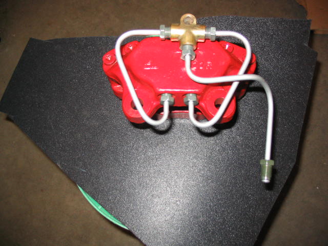

Use the stock 914 calipers. Rebuild them with new rubber lines and use good pads and you'll have great brakes. 19mm master will give you a high pedel because of the increase in fluid volume it moves when the pedel is depressed.
If you start adding a larger contact patch and more unsprung weight you may want to consider increasing the clamping force by changing to a 4 piston style caliper of using a larger caliper and vented rotor.
Hp has nothing to do with stopping the car. 100 mph with 85 hp is the same 100 mph with 300 hp. A flat 4 with two fat guys weighs as much as a V8 car. The force required to stop both cars is equal. The formula changes when you add larger and wider tires with heavier wheels. The rotational force adds resistance. This requires more clamping force.
Here's my 2002 setup. I made the lines with a tubing bender and a bubble flare kit.
