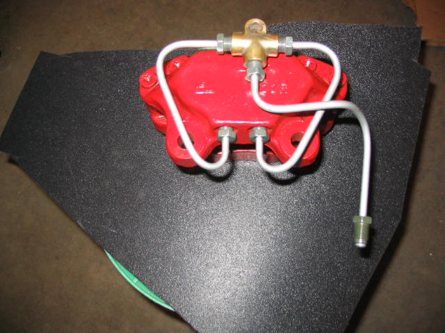

19mm master is needed or your peddle travel will be scary long. unsure.gif The 320 piston fluid volume is more than the stock 914 caliper. The 320 caliper is not optimum in my opinion. First the machine work then the pads ride high on the rotor and actually over the top I guess. The BMW 2002 4 piston is better and a direct bolt on with the exception of the duel lines. They are small and light unlike the Volvo 4 piston units. I have them on my car.

What do you do about the dual lines on the BMW 2002 calipers? It looks like you can get them for a good price. Do you need a 19mm MC for the 2002 calipers?

Here's my 2002 setup. I made the lines with a tubing bender and a bubble flare kit.
